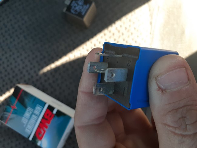

Oh and no every time the turn signals quit working the brake lights quit too, except for the one above my rear window.
Wednesday, October 14th, 2020 AT 2:53 PM (Merged)
  • 109,885 POSTS

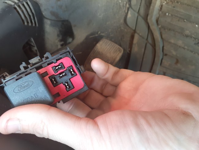

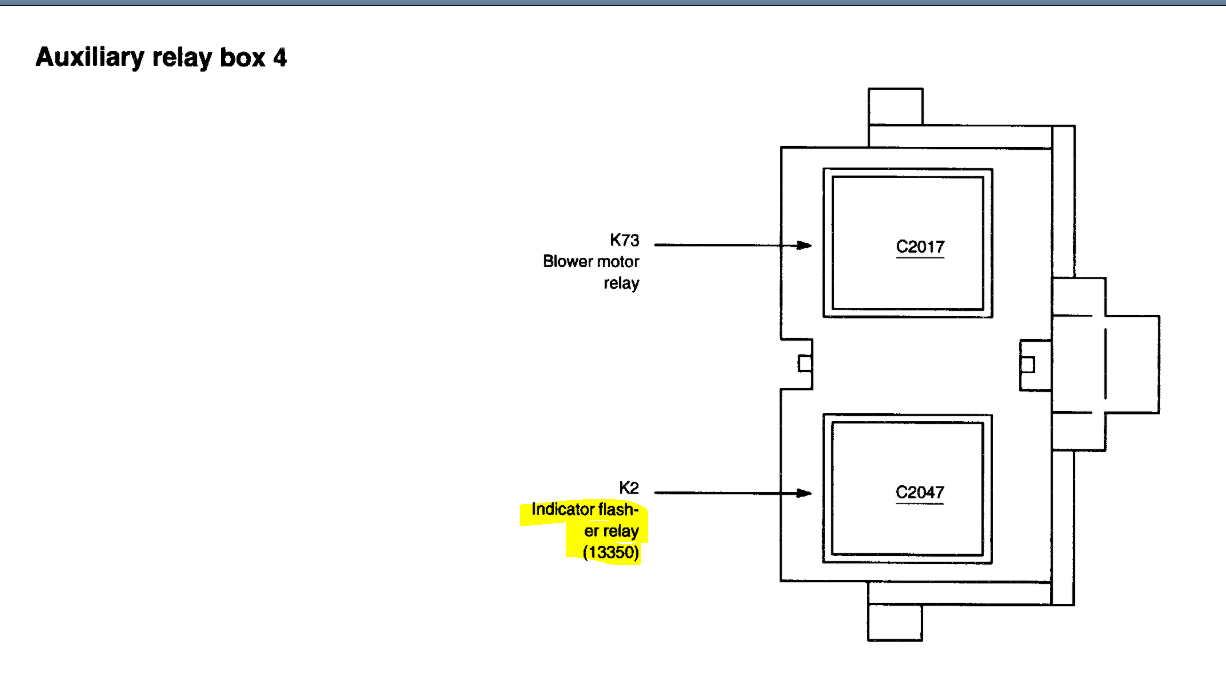

Yep, that's the signal relay. If it is tight, chances are it is corroded. Wiggle it gently when pulling. It should come out.
Once you get it out, check the connectors to make sure they are not corroded or damaged. Before you put anything into the plug to clean it, I would disconnect the battery to eliminate the chance of a short.
Take a look at the pic below. It should look familiar. At least now you know where the blower motor relay is too. LOL
Let me know if you get it out and if it takes care of the issue.
+1
TMCINTOSH11
  • 176 POSTS

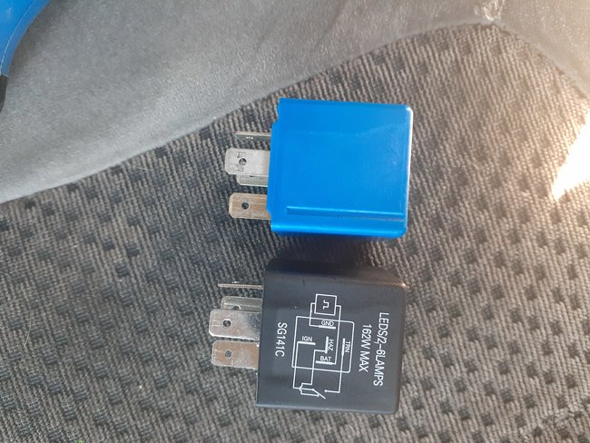

Awesome, I was wondering what the other one was. I'm going to work with it best I can, I got some crc electronic connection cleaner I'm going to spray in it before I put the new one in. I'm just so glad it's in an easy to get to location. Worse case scenario I can replace the box itself if I have to. I'll let you know how it goes. Thanks for all your help!
TMCINTOSH11
  • 176 POSTS
I was able to get the old relay out and the new one in, so far everything's working good. I'm going to keep the relay box within reaching distance encase it acts up again. I also sprayed the connections with crc (with the battery disconnected) let it dry and popped it in. Thanks for all your help. If anything happens I'll let you know.
