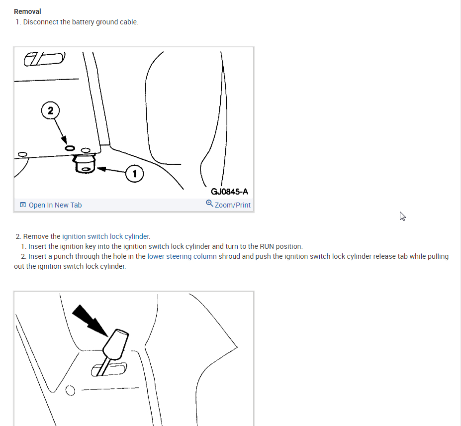

All of a sudden when I turn on turn signals left or right they work fine but will not click off. I have to manuly turn them off. I checked fuses & lights they were fine, there must be something i'am missing. Please help
Wednesday, February 18th, 2009 AT 11:31 PM

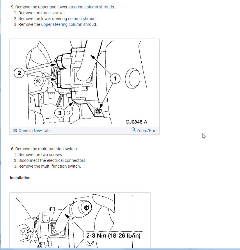

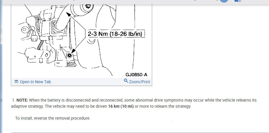

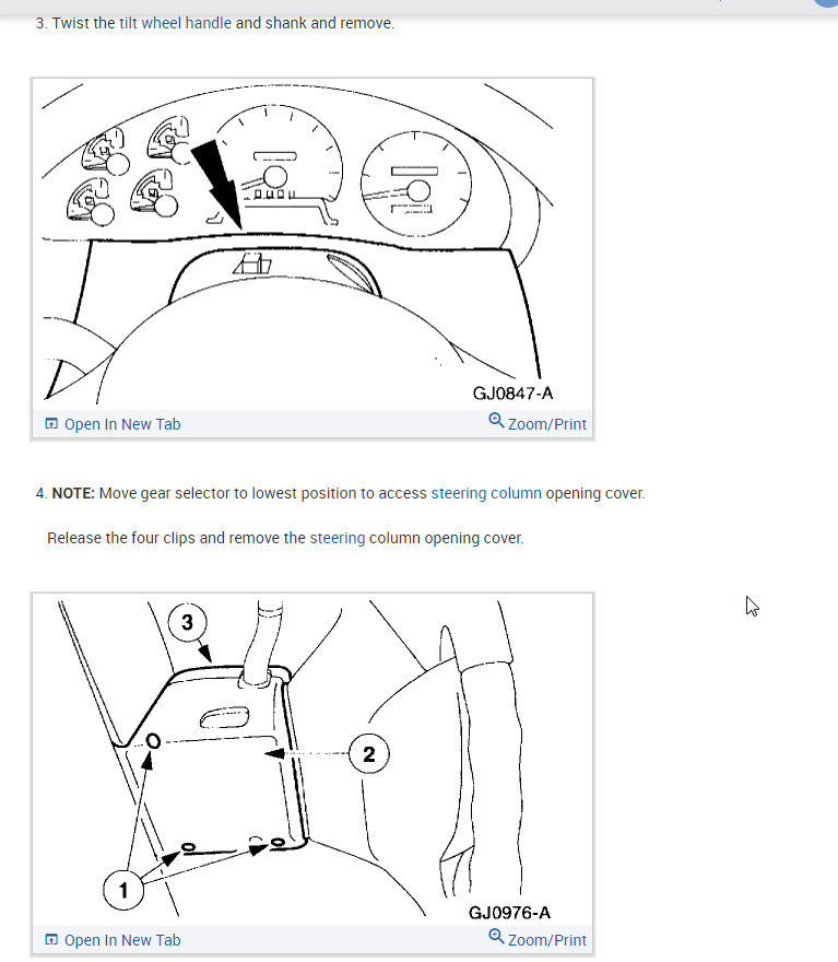

Just to be sure but I think you are saying that the auto off function as you are coming out of a turn is not working? If that is the case, then we need to replace the multifunction switch.
I am attaching the process below on how to replace this. Let's run through this and let us know what you find. Thanks
