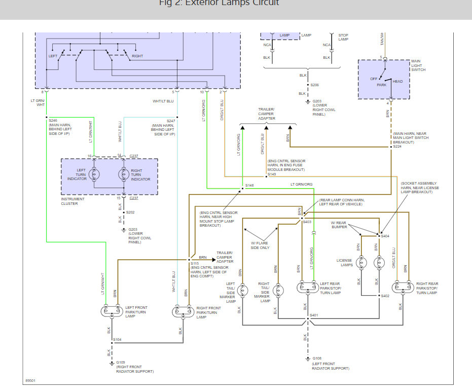

Hi.,im having a problem with my 99 f150 ext cab. when i have my my headlights on my right blinker wont blink . can anyone help me out with this issue?
Jul 1, 2010 at 1:34 PM
BLUELIGHTNIN6
  • 16,542 POSTS
sounds like grounding issues, check the wiring at the headlamp switch as well as the turn signal switch. This guide can help us fix it

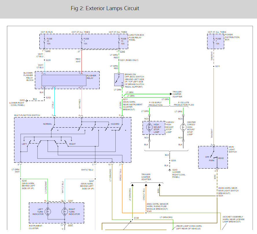

JDL
  • 16,098 POSTS

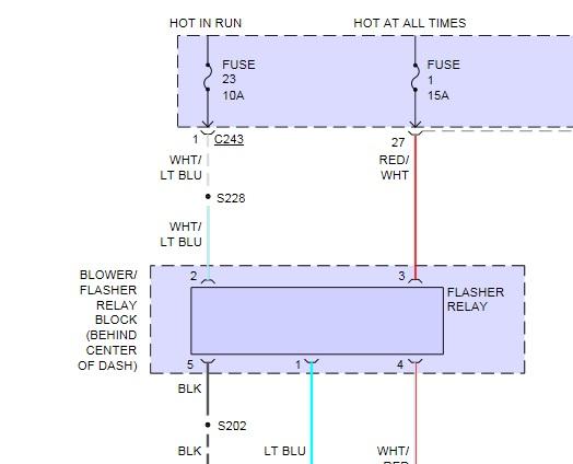

Check for voltage at the fuses in diagram. One fuse circuit is hot all the time, for hazard lamps. The other fuse goes hot with key on, for turn signals. Use a testlite to check voltage. Your flasher could be faulty?
Next, I'd have to check voltage circuits to and from multifunction switch.

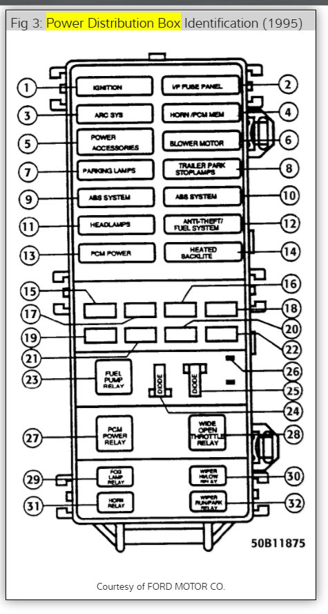

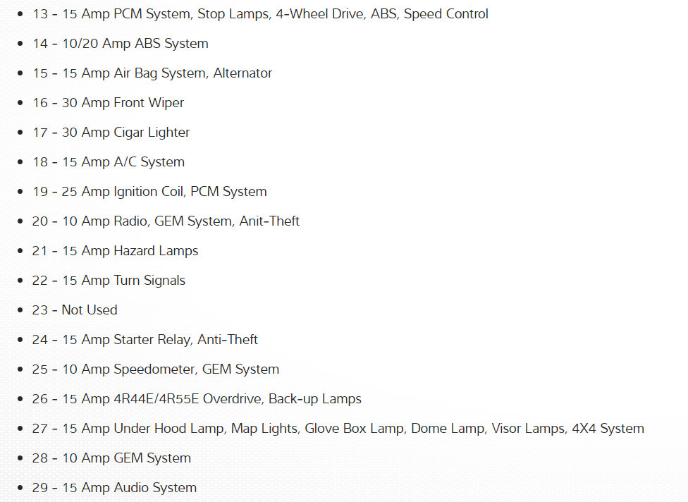

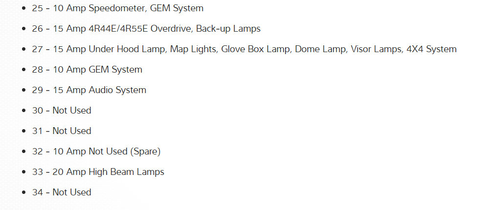

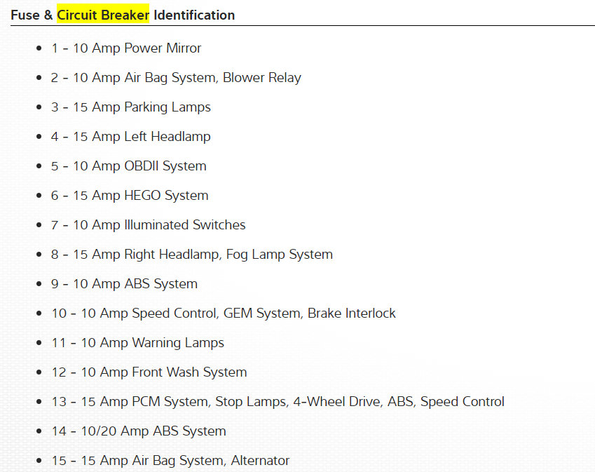

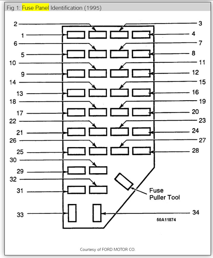

PROTECH1980
  • 901 POSTS
Please check fuse number 13, 1 and 23. Here is a guide to help you check for power and the blinker wiring diagrams so you can see how the system works.
Check out the diagrams (Below). Please let us know what you find.
Cheers
Oct 11, 2020 at 8:45 AM (Merged)
STILLWATER10
  • 27 POSTS
Well i started checking wires and refitted my switch and the turn signals came on, moved the column they when't off the switch on top pulls out slightly i will try something to make it snug the clip on top is broke. and as far as the wires go i did not check the ones on top just the side. The wires connecting to the turn are light blue with orange stripe (no power)fuse 1 fine, Dark blue with orange stripe (with power)

I have a 1997 F150 pickup and the turn signals only work when there's no headlights on and the heat is off. If the lights are on there's no turn signals. If the lights are off and I put the heat on there's a buzzing noise coming from the flasher under the drivers dash. When headlights are on there are two green arrows on dash lit up. High beam shows up but the high beam is not on. When headlights are off dash lights come on. when lights on hazards don't work. Lights of and heat off Hazards work. Never seen this before please help.
Oct 11, 2020 at 8:49 AM (Merged)
KHLOW2008
  • 41,814 POSTS
Hi nettnett,
Is your vehicle equipped with Day Running Lights?
Did you test the headlight bulbs for high beams?
I would suspect a bad grounds for the headlights at the body near wheelhouse behind headlight.

Hi nettnett,
The thing they have in common are grounding points.
Unloosen and retighten the grounding point at lower front cowl panel. It is the grounds for the blower and flasher relay box and should be the main culprit.
Sorry I do not have any diagrams to show.
