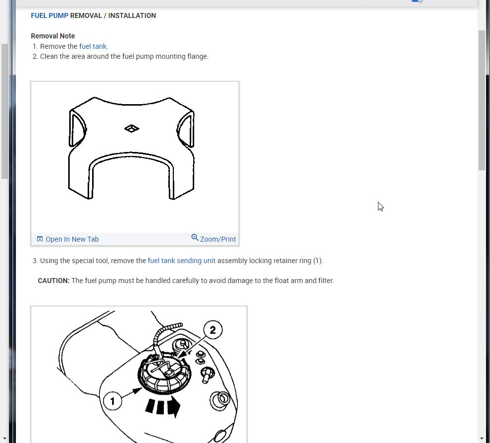

My truck is hard to start, it takes several attempts to get it started.
It will crank but not start, after several tries it does start and then runs rough for about a minute then smooths out and runs fine.
Mar 14, 2021 at 8:42 AM
On this vehicle I suspect we have an issue with the fuel pump/pressure.
Let's check the pressure when this is happening and we can go from there.

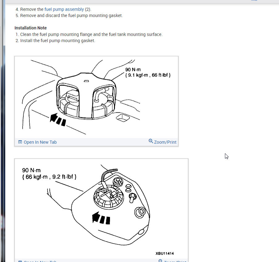

Below is the process from the manual on how to replace the pump if this proves out to be the issue. Let us know what you find. Thanks
