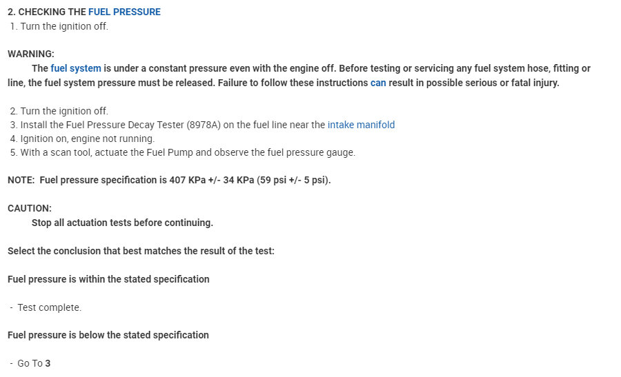

I’m experiencing hard starts after my car sits for a while. I would like to perform a fuel pressure test, but I’m not sure how to do it. My car doesn’t have a Schrader valve. It also has a P0420 catalytic converter code. Can this be causing my hard start issue? I would still like to perform a fuel pressure test to rule that out. I just recently changed out my fuel pump and sending unit, albeit with used ones. How do I go about the fuel pressure test? Is there an adapter that I can put between the fuel rail and fuel line, and if so, where do I find that adapter?

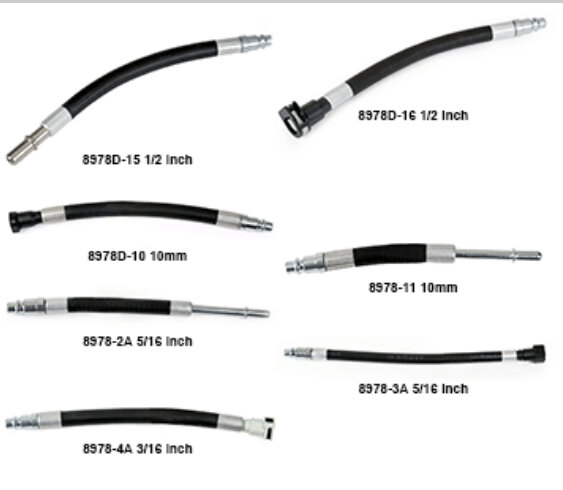

The fuel pressure tester is attached between the supply hose and the fuel rail. Here is the thing, Chrysler recommends Chrysler tool number 8978A to check the pressure, but trust me, you don't want to purchase one.

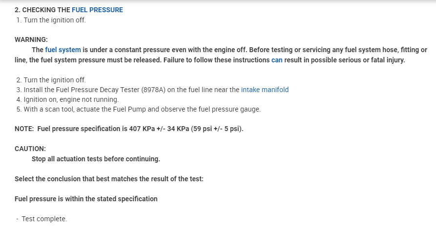

Next, the directions indicate using a scan tool to actuate the fuel pump. I suspect it would be fine that once you get the gauge attached, you can turn the key to the run position (engine off) to pressurize the system.

If you look below, I attached the directions from my manual.
See pics below. Pic 1 shows the adapters for connection and pic 2 is the kit. The last two pics are the directions.
