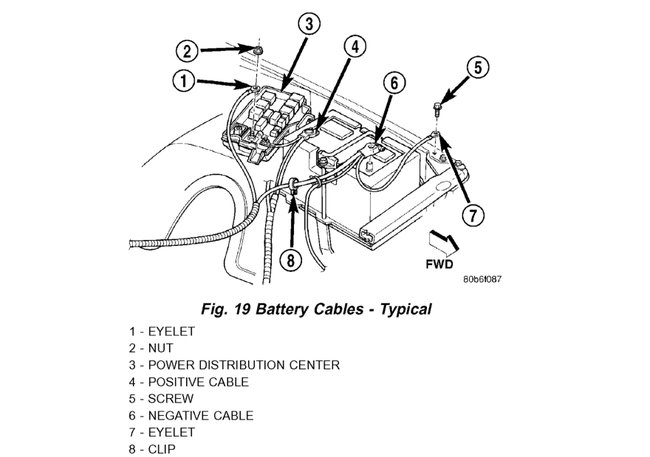

First start of day usually results in starter turning once or barely budging, then nothing. Continuing to hold key in start position sometimes results in eventual slow turnover and engine start, but usually takes multiple attempts. Thought it was electrical so I've been connecting battery charger after the failed attempt. Looked for parasitic drain but draw is only 20-30 milliamps. Battery tested good but replaced it under warranty a month ago and then replaced starter last weekend. New battery and alternator have been tested 4 times - alternator diode showed bad on first tester but good on 3 others. It initially occurred only after sitting for a day but now has trouble after sitting overnight. Outside temperatures have been above 70. Once it gets started, it starts normally for remainder of the day.

I would start by checking the battery cables. If they are corroded or internally corroded, it will cause this.

I had not considered the cables and there was corrosion on the positive terminal prior to replacing the battery. The terminal area is now clean of any corrosion and the connection is tight. How do I check for internal corrosion? Do I simply peel the rubber coat back and inspect visually or is there a better test using a multimeter or other tool?

If you see any corrosion inside the cable, replace it. That means the entire cable is corroded.

BATTERY CABLES
The battery cables (Fig. 19) are large gauge, stranded copper wires sheathed within a heavy plastic or synthetic rubber insulating jacket. The wire used in the battery cables combines excellent flexibility and reliability with high electrical current carrying capacity Refer to Wiring Diagrams for the location of the proper battery cable wire gauge information.
The battery cables cannot be repaired and, if damaged or faulty they must be replaced. Both the battery positive and negative cables are available for service replacement only as a unit with the battery positive cable wire harness or the battery negative cable wire harness, which may include portions of the wiring circuits for the generator and other components on some models.
The battery cables connect the battery terminal posts to the vehicle electrical system. These cables also provide a return path for electrical current generated by the charging system for restoring the voltage potential of the battery The female battery terminal clamps on the ends of the battery cable wires provide a strong and reliable connection of the battery cable to the battery terminal posts. The terminal pinch bolts allow the female terminal clamps to be tightened around the male terminal posts on the top of the battery. The eyelet terminals secured to the ends of the battery cable wires opposite the female battery terminal clamps provide secure and reliable connection of the battery to the vehicle electrical system.
Gasoline Engine Battery Cables
Gasoline engine models feature a stamped brass clamping type female battery terminal crimped onto one end of the battery cable wire and then solder-dipped. A square headed pinch-bolt and hex nut are installed at the open end of the female battery terminal clamp. The battery positive cable also includes a red molded rubber protective cover for the female battery terminal clamp. Large eyelet type terminals are crimped onto the opposite end of the battery cable wire and then solder-dipped. The battery positive cable wires have a red insulating jacket to provide visual identification and feature a larger female battery terminal clamp to allow connection to the larger battery positive terminal post. The battery negative cable wires have a black insulating jacket and a smaller female battery terminal clamp.
The battery positive cable terminal clamp is crimped onto the ends of two wires. One wire has an eyelet terminal that connects the battery positive cable to the B(+) terminal stud of the Power Distribution Center (PDC), and the other wire has an eyelet terminal that connects the battery positive cable to the B(+) terminal stud of the engine starter motor solenoid. The battery negative cable terminal clamp is also crimped onto the ends of two wires. One wire has an eyelet terminal that connects the battery negative cable to the vehicle powertrain through a stud on the front of the left engine cylinder head. The other wire has an eyelet terminal that connects the battery negative cable to the vehicle body through a ground screw on the left front fender inner shield, just ahead of the battery. An additional ground wire with two eyelet terminals is used to provide ground to the vehicle frame. One eyelet terminal of this ground wire is installed under the head of the battery negative cable terminal clamp pinch-bolt, and the other eyelet terminal is secured with a ground screw to the outer surface of the left frame rail, below the battery.
