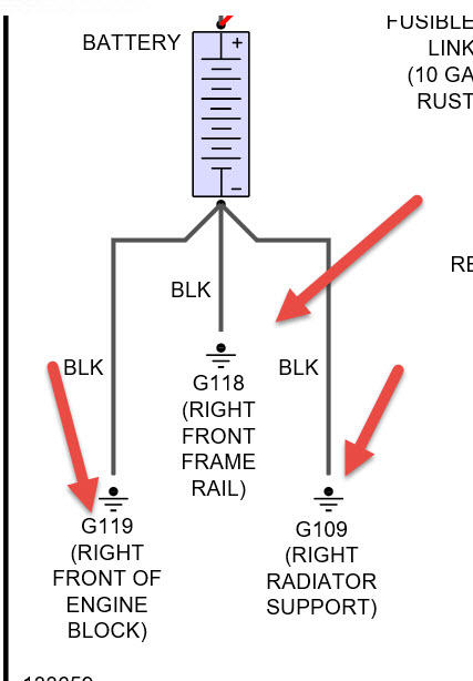

When I turn my right turn signal on it blinks at a rapid speed. When I turn my four ways on it is back to normal. I have put all new bulbs in and it still does this. I checked the fuses and they are all good. The grounds are grounded. Also my reverse lights do not come on.
Tuesday, July 31st, 2018 AT 2:52 PM (Merged)
HMAC300
  • 48,601 POSTS
Check grounds at left and right rear frame rails. Then have it scanned for codes it may be turn signal module or body module problem.
KRAMPN17
If it changes anything, when I turn my right turn signal on, the license plate light will blink dimmly. Right brake light also does not work when I apply the brakes.
HMAC300
  • 48,601 POSTS
That sounds like a ground issue. Check the one at right rear of frame like I said in first reply then check battery ground/ body and engine. See picture.
