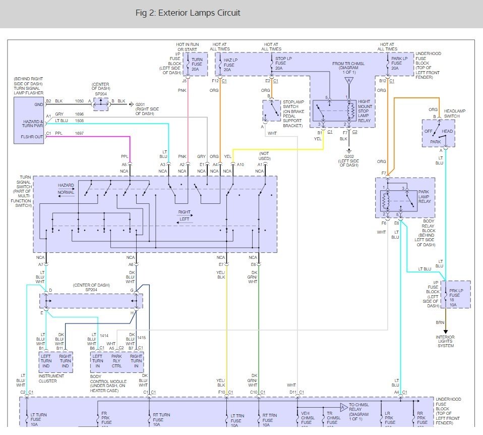

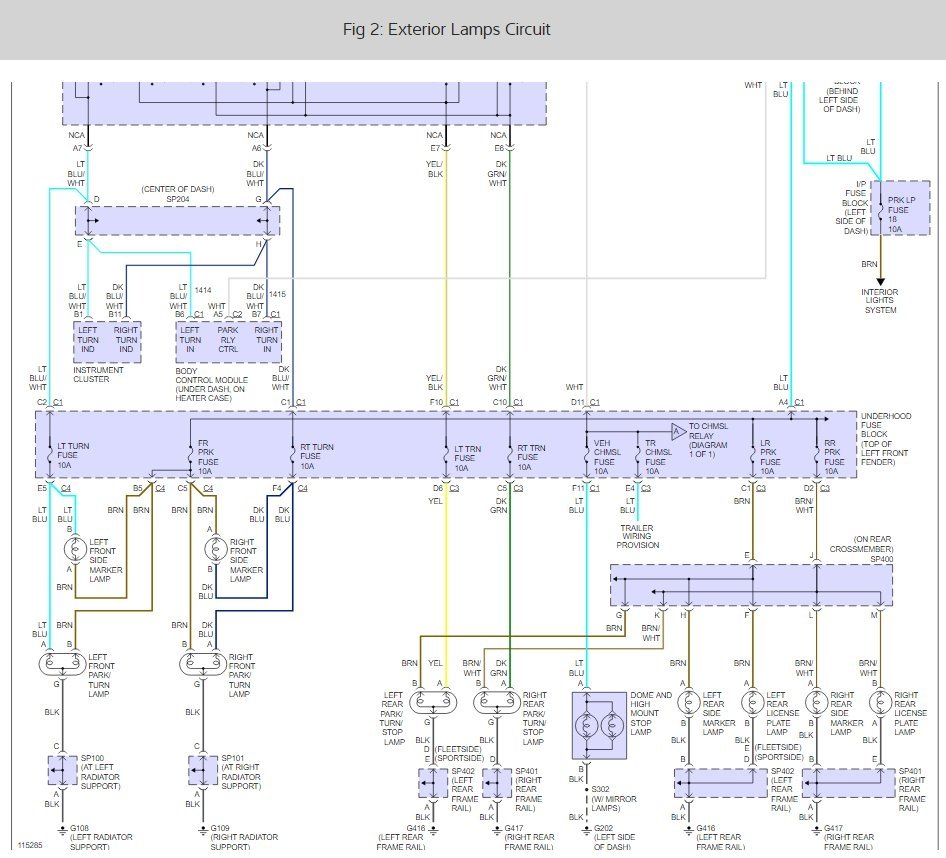

During the day my left blinker works, but at night it does not. It flashes once the stays on dim. That causes the left brake light not to work.The brake light works during the day but not at night. I have changed the socket too. Please help tired of getting pulled over!

It sounds like you have a bad ground which is back feeding into the lighting circuits. Here are a couple of guides and some wiring diagrams (Below) that should help us get the problem fixed.
https://www.2carpros.com/articles/no-tail-lights-exterior-running-lights-tail-lights-out
and
https://www.2carpros.com/articles/turn-signals-not-working-blinker
and
Please run some tests and get back to us we are interested to see what it is.
