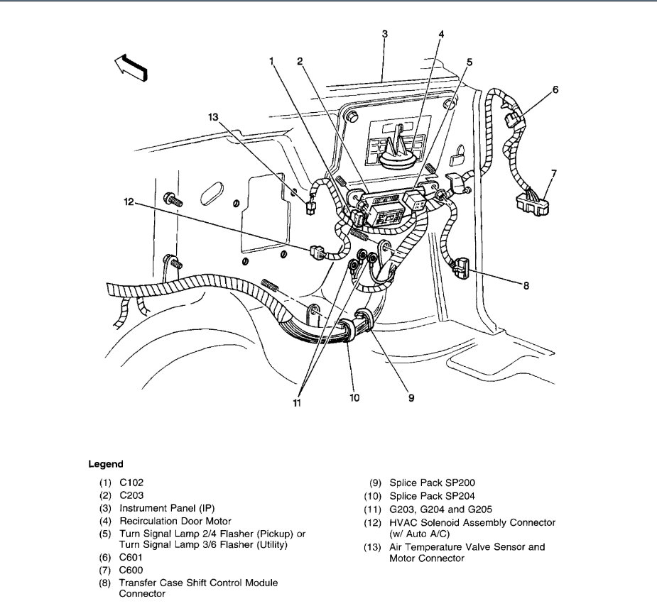

My rear right flasher is not working and ive tried every thing else

check fuse under hood if lh turn signal works then it's not the flasher. however it is behind rh side of dash. check ground at right rear frame rail for the t/s it cold also be a bad socket especially if power goes through wire but not the socket itself. Check out the diagrams (Below). Please let us know if you need anything else to get the problem fixed.
