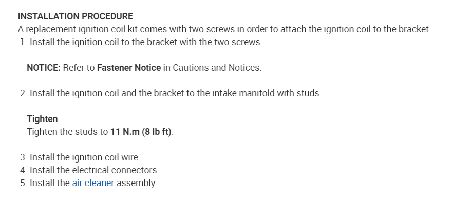

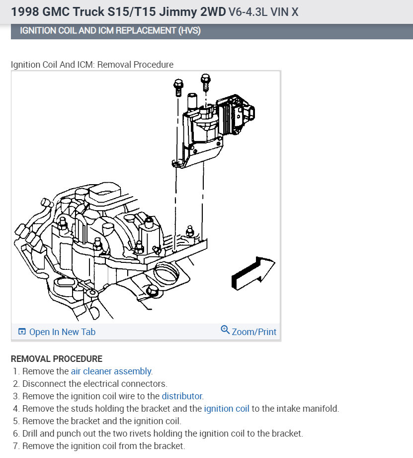

So, what happens on these is the fuel pump or ignition coil is getting weak and when the jump is on there it keeps the voltage up so the coil or pump will work, I would try the coil first. Here is how you change it out in the images below. Check out the diagrams (below). Please let us know what happens.
+2
Monday, August 22nd, 2022 AT 10:56 AM
CHRISXXX9876
Thank you very much for the info. I kind of think it's the coil also. Now with your advice I am going to hopefully find the problem.
