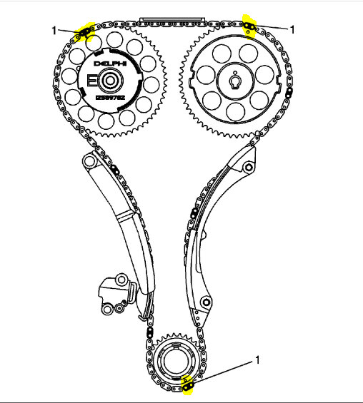

Hi:
The reason for removing the fuse is to prevent fuel from getting into the engine and not being burned. As far as the problem, if you have no compression (0 psi), valves are open at the wrong time. Even with a faulty head gasket, you would have some compression.
I feel confident the timing is off. When you installed the timing chain, were the colored links aligned with the timing sprockets? See pic below.

Well, after the zero compression test, we suspected bent valve stems.
Confirmed that yesterday.
TC time marks are fine.

That isn't good news. I didn't think this was an interference engine. The valves must have gotten bent when the chain broke.
As far as repairing the heads, you may be further ahead in finding a good used one. I'm not sure where you are located, so I have no idea who to recommend.
