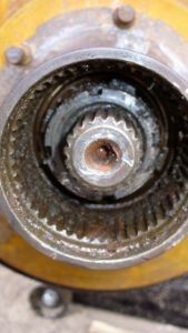

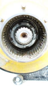

I have to replace the wheel studs on my left front hub/brake assembly, which requires removal. i followed all the steps from my Haynes, removed the hub locking mechanism, but the thing still won't come off. am i missing something? any tricks to motivate this thing off of here?
1986 GMC K1500
mileage: ??? high ???
engine: custom 350[img:b97257ed09]http://www.2carpros.com/forum/automotive_pictures/60761_hub2_1.jpg[/img:b97257ed09]
[img:b97257ed09]http://www.2carpros.com/forum/automotive_pictures/60761_hub1_1.jpg[/img:b97257ed09]

will the ring in the pic come off , because if i remember right it should spin off allowing access to the outer bearing and essentially allowing the rotor to come off

looks like it should spin off, but i couldn't get it to budge loose (used a pair of pliers wedged in there) is there a special socket for this?

there is a special socket for the nut , you should be able to pick it up at any large auto parts store or sears

Use a special hub-nut socket, available at a large auto parts store, to spin off the locking ring/nut. That exposes the outer bearing and allows the rotor and hub to come off.
Conversation Summary
The owner of a 1986 GMC K1500 needed to remove the left front hub and brake assembly to replace wheel studs. After removing the hub locking mechanism, the hub still would not come off. The expert said the ring should spin off to access the outer bearing and release the rotor. When pliers would not loosen it, the expert advised using a special socket for the nut from an auto parts store.
