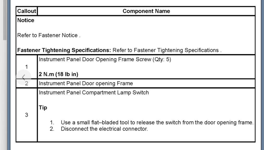

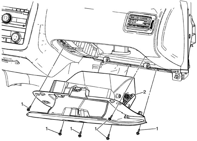

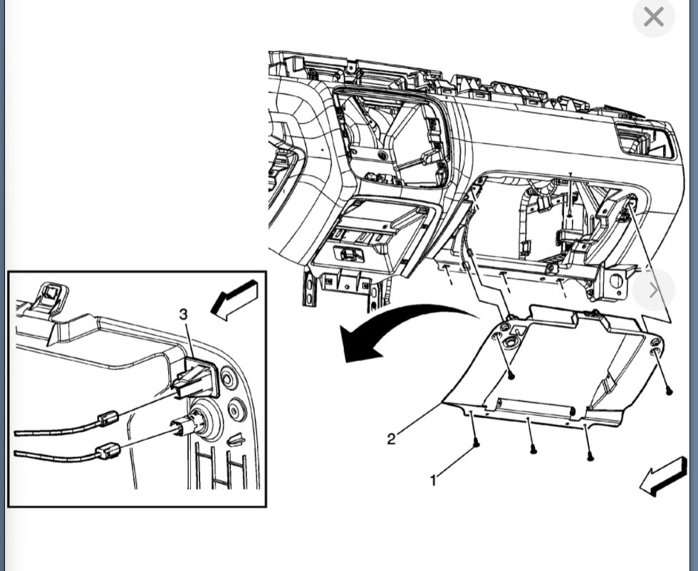

I can only locate three of the four screws that hold the bottom of the door to the dash frame. (Also the two at the top) Would I have to remove the right kick panel to find the other screw?
The drawings sent with your reply also indicate four screws but I can only locate three.
Dec 20, 2017 at 12:53 AM
Take a look at these attachments. As you will see there are actually 5 screws holding this in place.
Please run through this and let us know what you find. If you are still having issues, can you get a video or picture of what you are looking at so that we can be sure to be on the same page.
