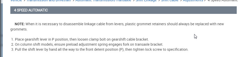

When the gear is put into drive, it did not select other gear.
May 14, 2020 at 6:23 AM
Experienced Mechanic
18,907 POSTS

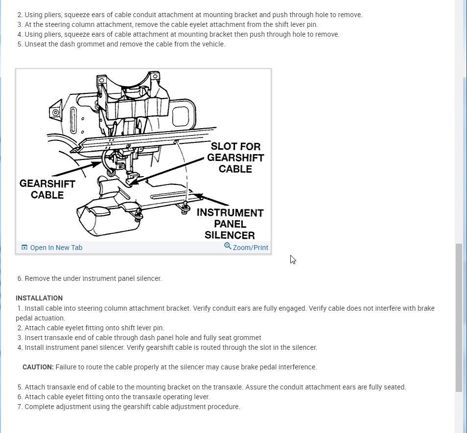

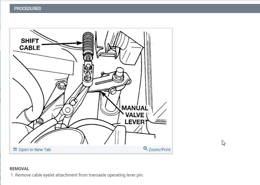

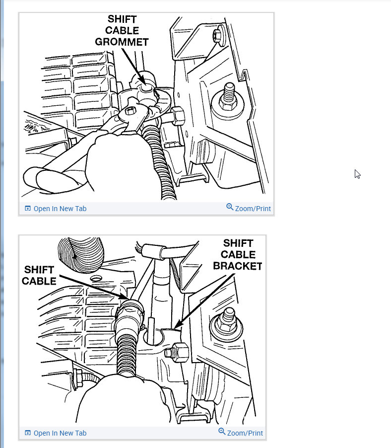

Sounds like the shift cable is out of adjustment. You selected a manual transmission but I figured you meant it was an automatic.
I attached the process on how to adjust the cable or to just replace it if you can't adjust it any more.
Let me know if you have questions. Thanks
