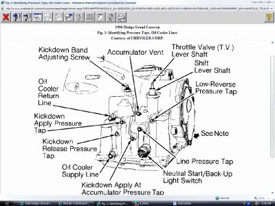

I was wondering if you had a picture of the transmission cooler hoses from tranny to rad. can remember witch tube on tranny and witch tube on rad. get connected to each other with the hose

Best I can do for you, I think the high pressure goes on highest tap on radiator...
https://images.2carpros.com/forum/automotive_pictures/62217_Trans_Linesa_1.jpg
You can test it tho, remove the return line and it should pump out 1 quart in 20 seconds in neutral with engine runnig. If not replace the cooler!

my question is were the hoses from to cooler go in transmission goes the lower hose off the cooler go to the cooler supply or to the return

Set them up the same way they come out of the transmission.
