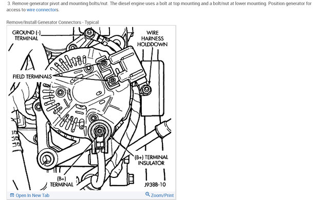

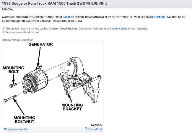

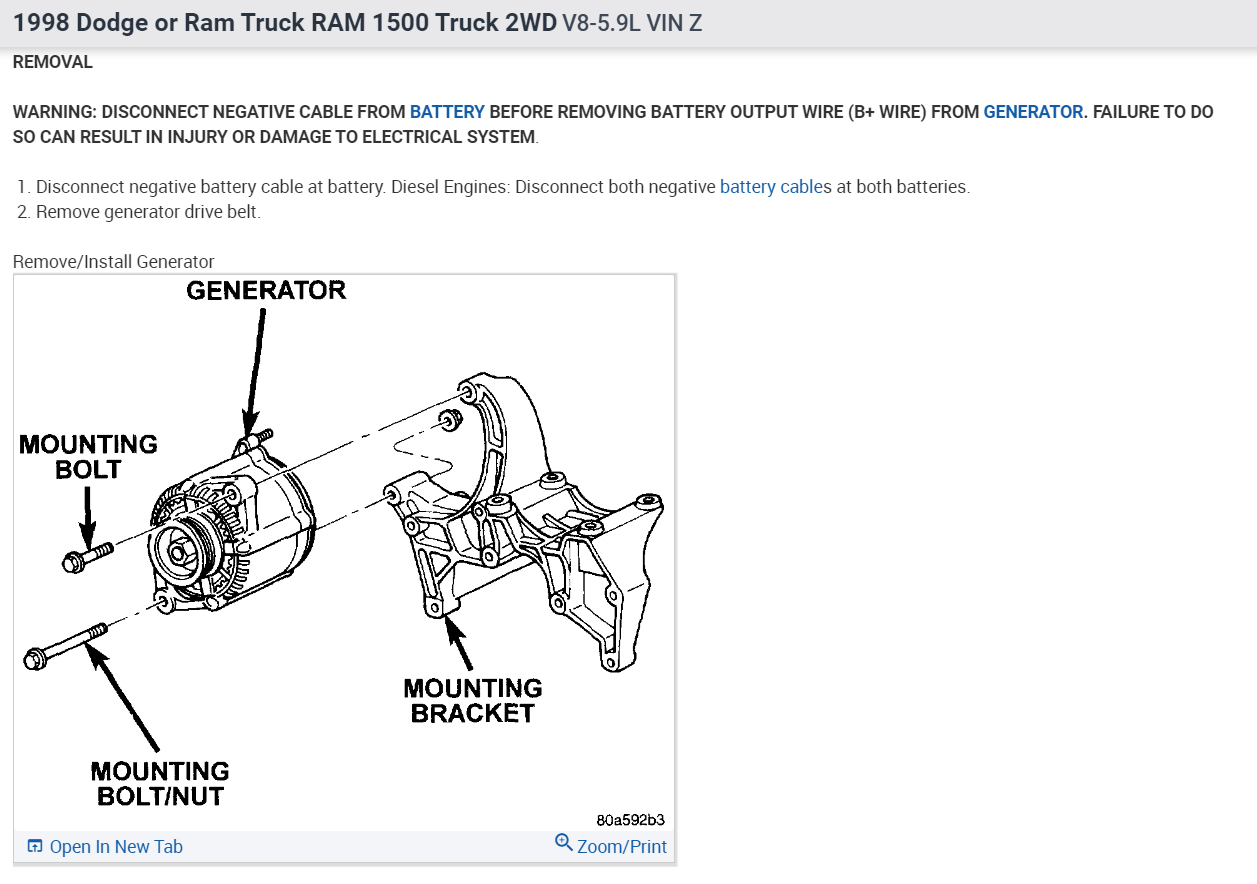

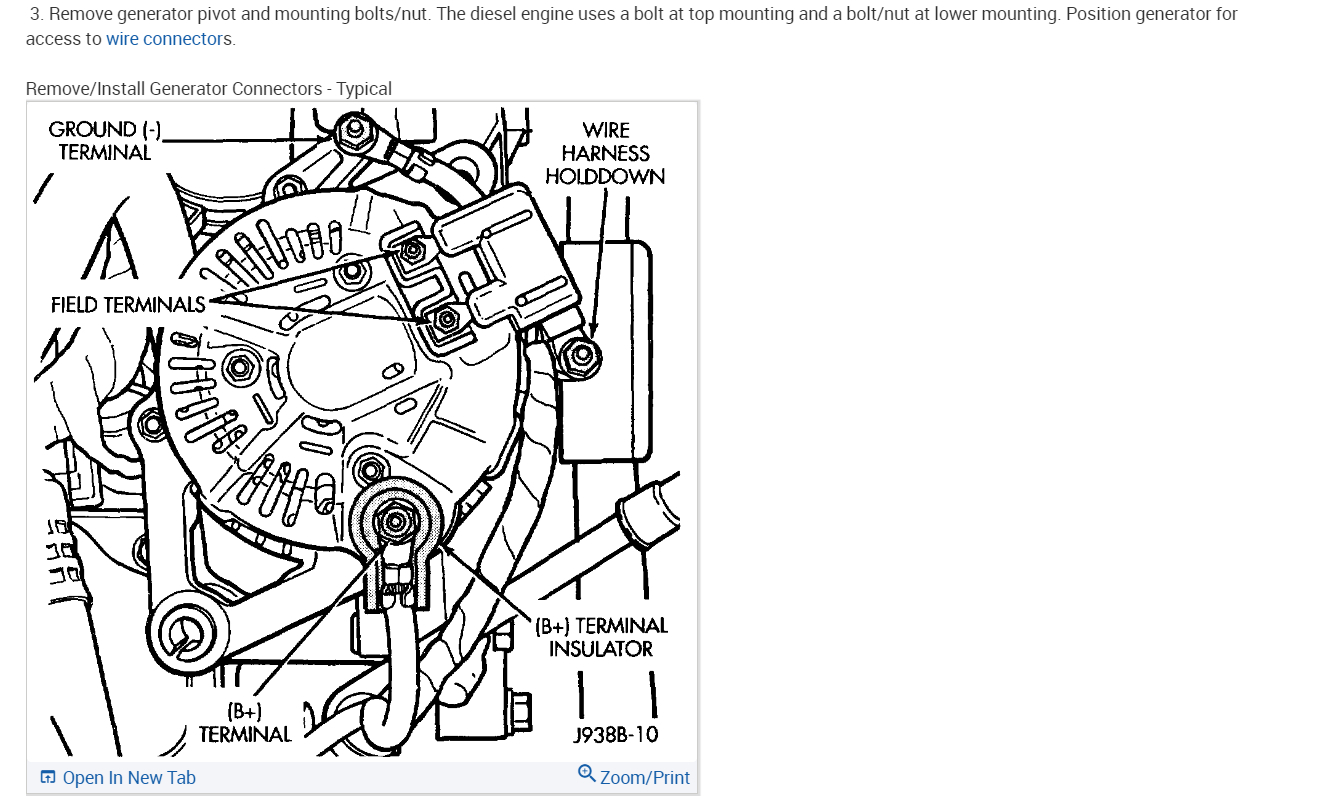

Yep, it sure can, it sounds like the alternator has a diode that is out on it is causing AC voltage to enter the electrical system, but to be sure here is a guide you can use to confirm the issue:"
Here is a generic guide to help you step by step with instructions in the diagrams below to show you how on your car:
https://www.2carpros.com/articles/how-to-replace-an-alternator
