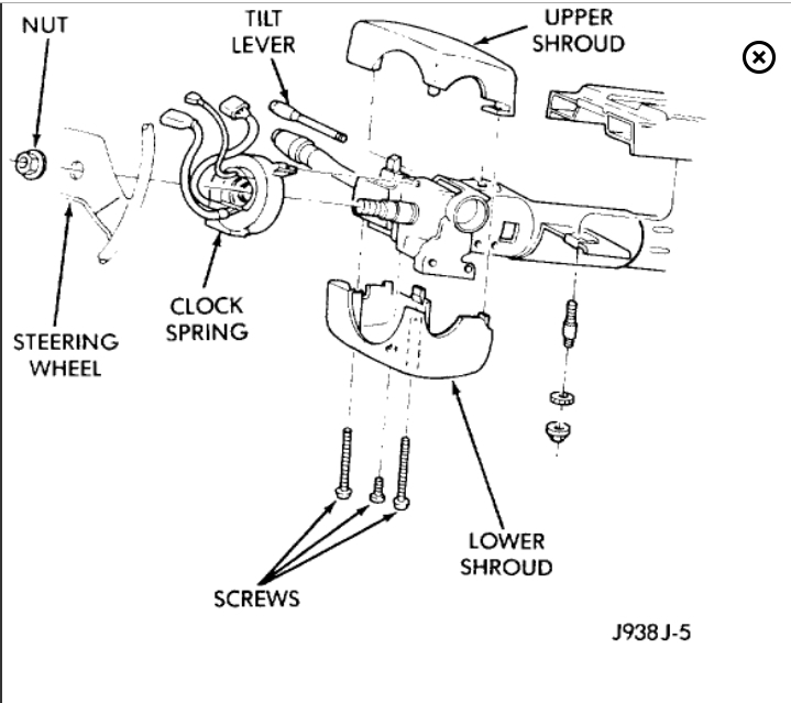

What happens is the steering wheel clock spring goes out cause the air bag light to come on. Here is a guide to show you what you are in for when changing the part out.
https://www.2carpros.com/articles/steering-wheel-clock-spring-removal
Here is what it will be like on your car (below)
Please let us know what happens so it will help others.

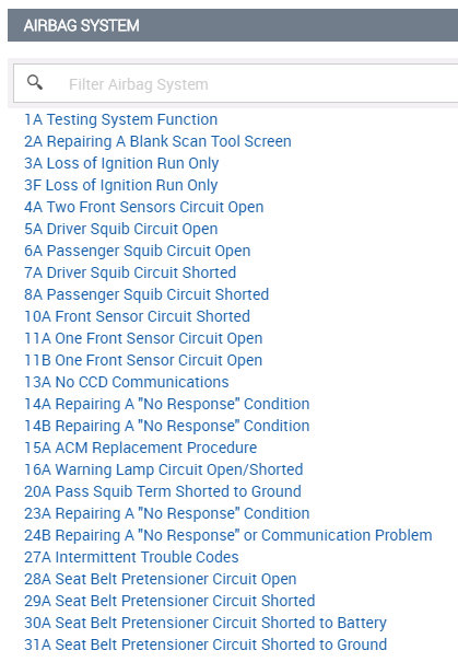

I've attached a chart below for your trucks air bag codes... You replied with code number 12 and 37. Those are not showing.I will have to look into this further.Thanks again for using 2CarPros.

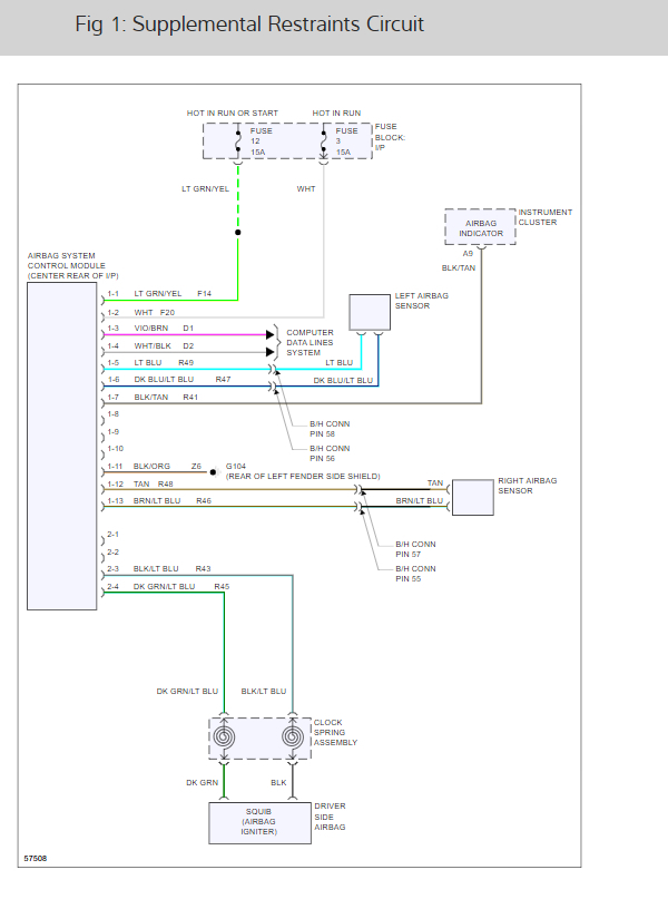

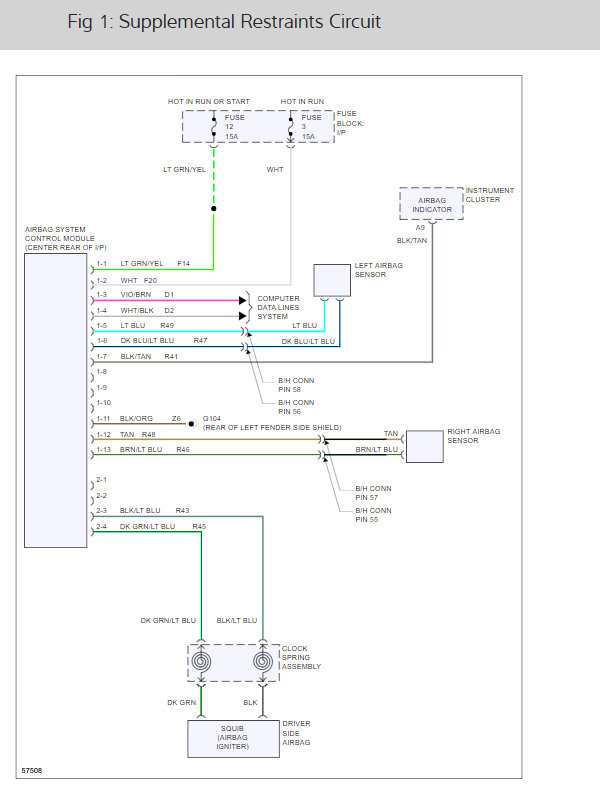

If I can jump in here. there is no diagnostic connector for the airbag system, it is a real time system before diagnostics were available. Here is the airbag wiring diagrams so you can see how the system works. Check out the diagrams (below). Please let us know what you find.
