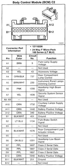

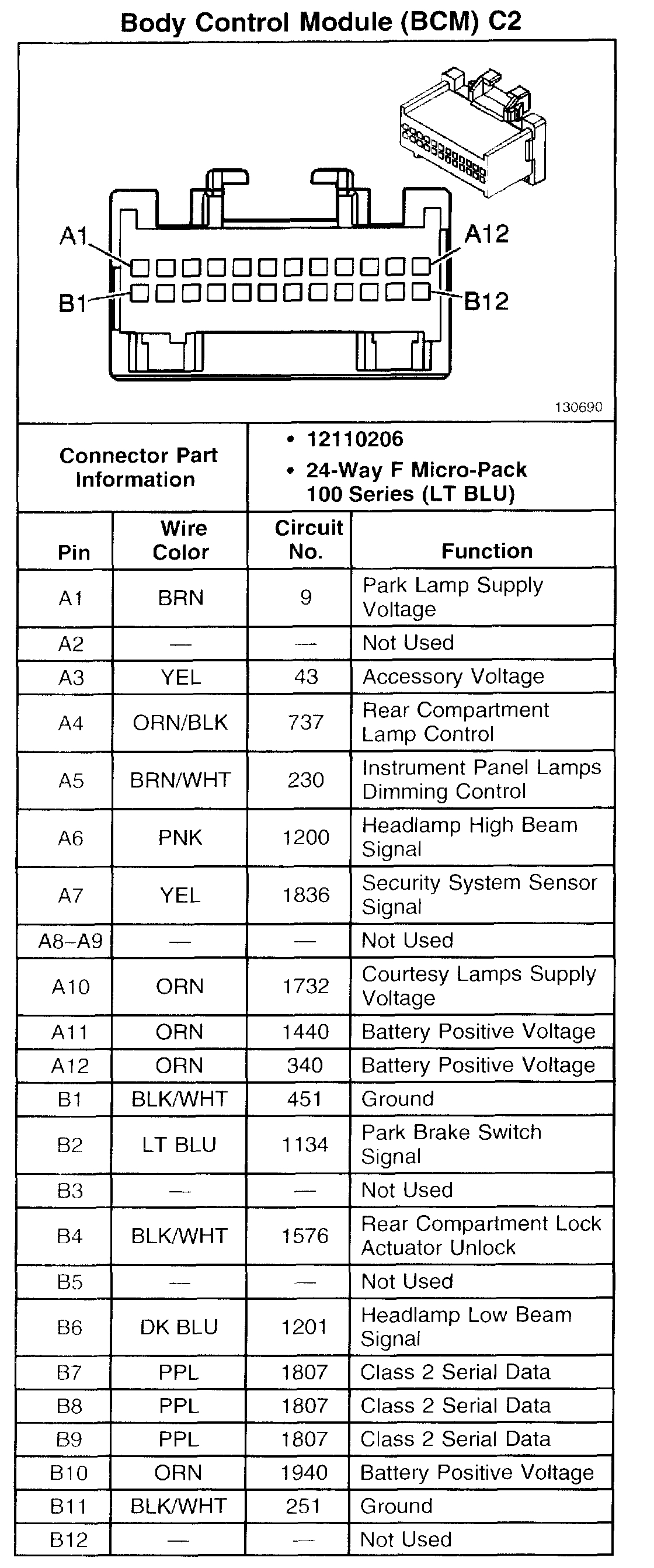

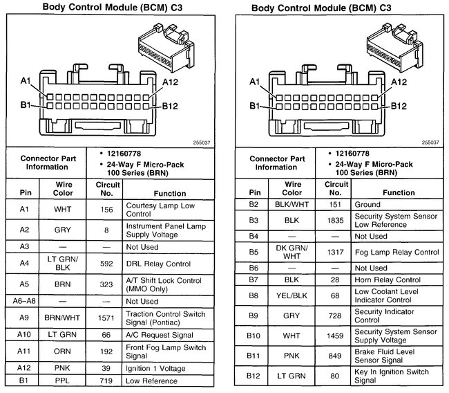

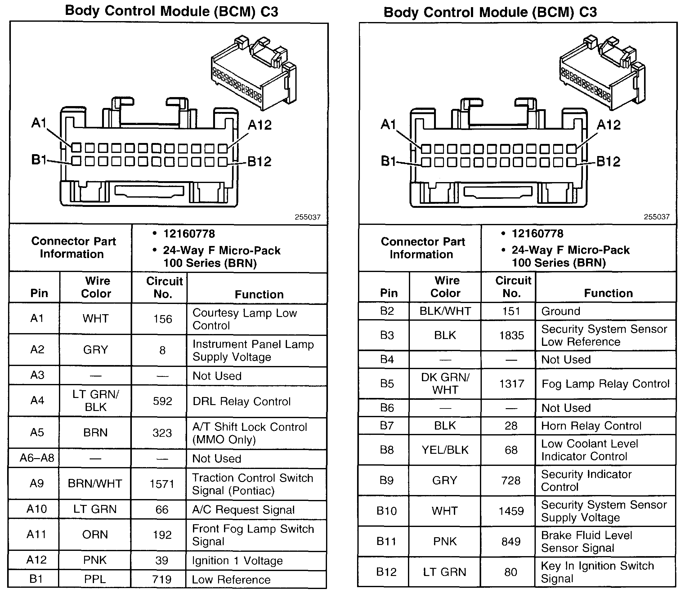

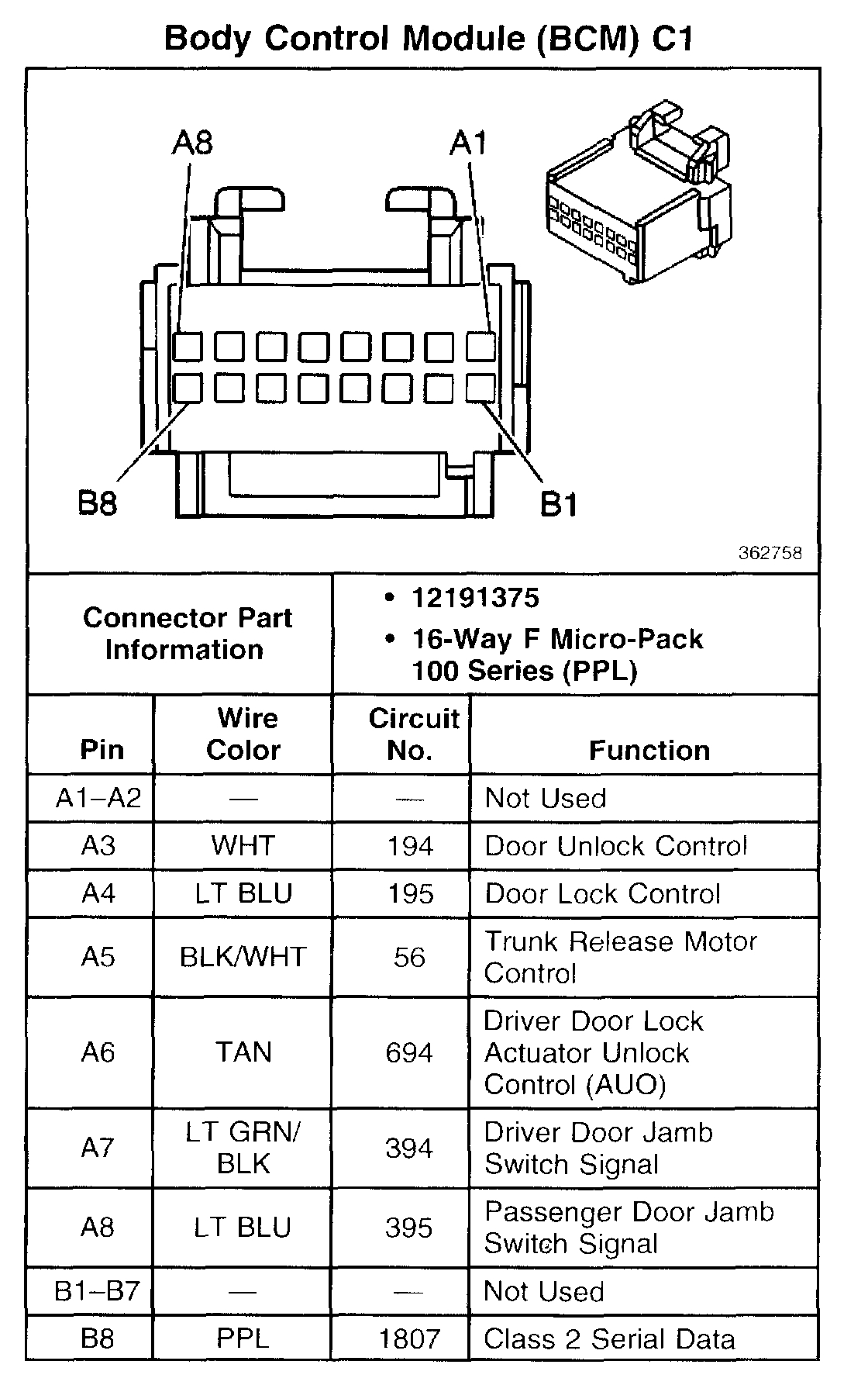

What is the black wire that comes out of the BCM box? Is that an antenna of some kind? If so what is it go to an alarm?
Oct 21, 2018 at 4:33 PM
  • 110,244 POSTS
Welcome back.
The only solid black wire to the BCM is for the horn relay circuit. I have attached three pictures for you to look through. It shows the BCM pin connectors, identifies wire colors, and what circuit it's related to.
Let me know if this helps.
