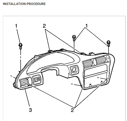

Why would my lights dim when I put the brakes on (exterior and interior), and get stronger when I press the gas pedal? Battery is only 6 months old. Also my gas gauge is acting wacky. Gauge will read empty (needle) when I know the tank is full. Does not happen all the time... if I turn the car off and then back on the needle will go where it should. Is this electrical or something else?? Thanks for any help....
Mar 31, 2009 at 7:02 AM
DANNY L
  • 5,648 POSTS

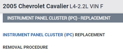

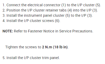

Hello, I'm Danny.

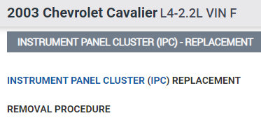

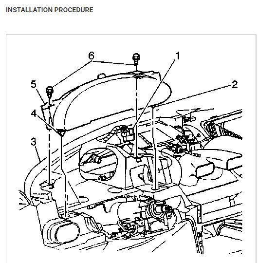

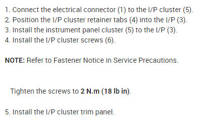

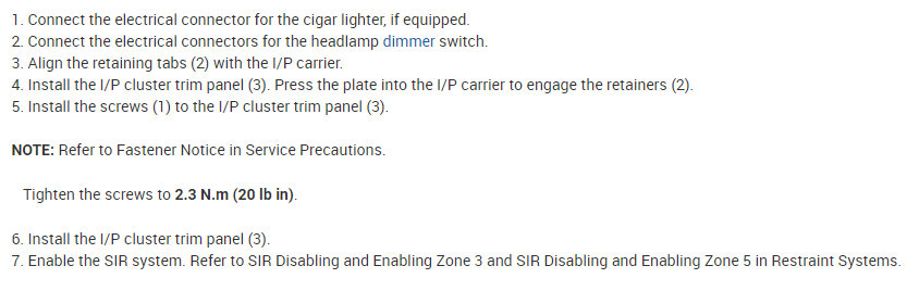

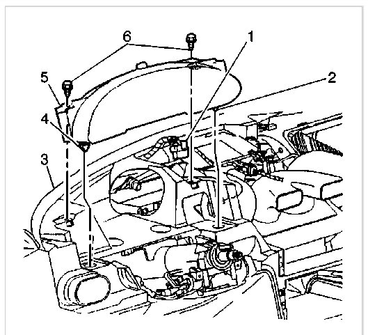

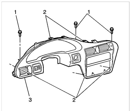

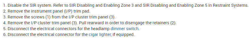

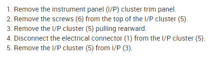

It sounds like the printed circuit board or the stepper motors in the cluster may be faulty in the cluster to be causing an abnormal reading since the car is otherwise running normally. I've attached picture steps below on how to remove and replace the trim to gain access to the cluster as well as remove and replace the cluster itself on your car. Some places like speedometer shops can repair instrument clusters. Hope this helps and thanks for using 2CarPros.

DANNY L
  • 5,648 POSTS
Hello, I'm Danny
It sounds like the printed circuit board or the fuel gauge stepper motor in the cluster may be faulty in the cluster to be causing an abnormal reading since the car is otherwise running normally. I've attached picture steps below on how to remove and replace the trim to gain access to the cluster as well as remove and replace the cluster itself on your Cavalier. Some places like speedometer shops can repair instrument clusters. Hope this helps and thanks for using 2CarPros.

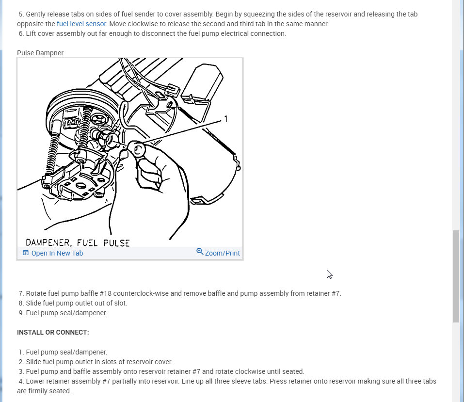

CARADIODOC
  • 34,381 POSTS
I've never run into this on a GM product before, but based on the symptoms, I'd suspect the sending unit. GM's fuel gauges are different than everyone elses in how they operate, and an open circuit can make the gauge read "full". I used to see this on Chrysler products, and it also happened at around 1/4 to 1/2 tank. The fix is to remove the assembly that has the float on it, carefully lift the plastic finger that holds the float arm on, remove the arm, then find the spring-metal contact and bend it out slightly so it makes a better contact. Pop the arm back on and reassemble everything. No new parts are needed. In fact, when people insist on a new sending unit, there's a good chance the same thing will happen in a few years.

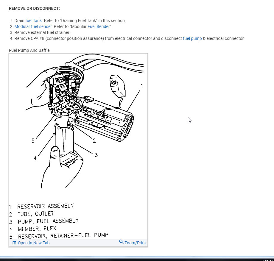

The eratic behavior of your fuel gauge may be a software glitch. Check with the techll guru at your GM dealer if there is an update reprogram for the PCM on your car. To replace the fuel sender you will have to drop the fuel tank and with that many miles on your car it would be wise to replace fuel pump while you have the fuel tank on the ground. Make sure its almost empty when you do it, it'll be a lot easier. Be careful and dont smoke while your doing it!

VYPR-PHYNX

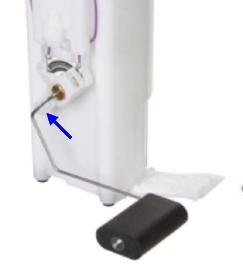

Fuel gauge is pegged to full most of the time. when fuel level is low then it works. sometimes gives correct level.
Jul 8, 2021 at 3:30 AM (Merged)
More then likely this is the level sensor in the tank that is getting stuck. The way to confirm this is remove the pump and plug it in then move the lever and watch either the voltage or the gauge to see that it is moving steadily.
Let me know what questions you have.

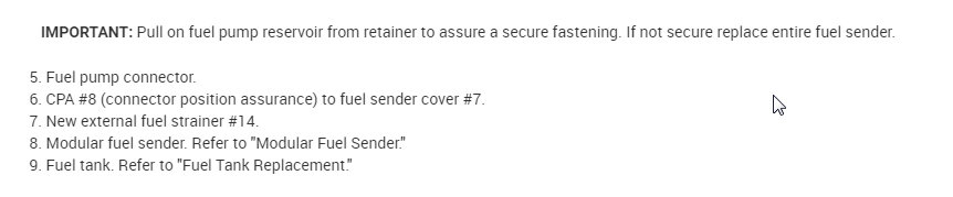

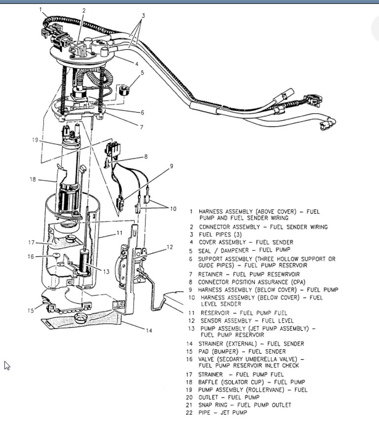

CARADIODOC
  • 34,381 POSTS
You're describing an intermittent connection on the movable wiper on the fuel level float. The classic symptoms are it makes contact and reads normally in one section of the sensor, then it goes open circuit in other areas. On most car brands the fuel gauge goes to "Empty" when there's a break in that circuit. GM's are the opposite. Their gauges read "Full", then get pulled down by the sensor circuit.
The photo shows what the assembly looks like on the side of the fuel pump housing. There should be a plastic clip to unsnap from the float arm, (blue arrow), and a way to pull the arm away so you can bend the movable contact slightly so it makes better contact.
