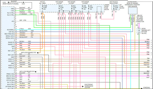

The fuse for bank that runs cylinders 1-7 keeps blowing as soon as I drive ..

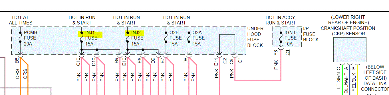

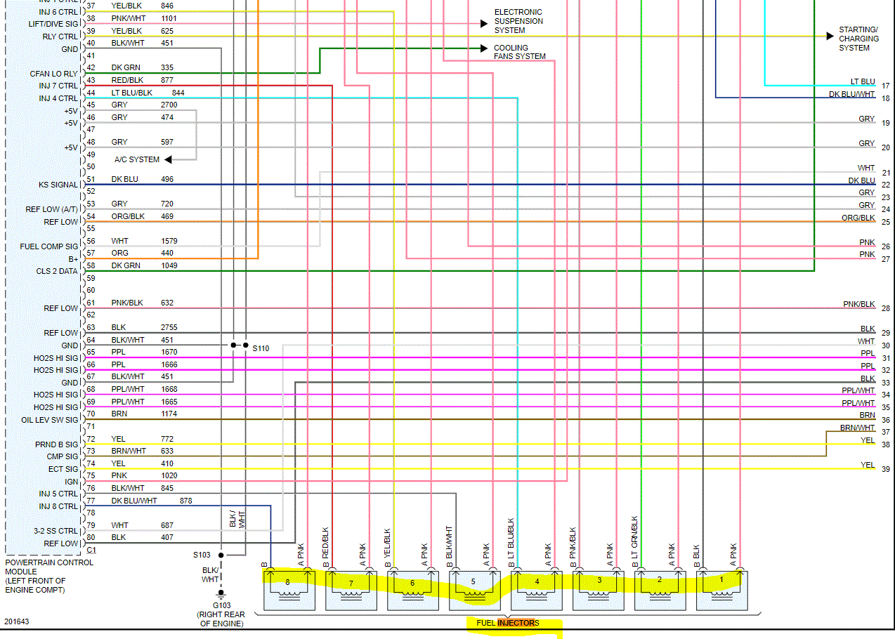

Okay, no problem. Can you tell me which fuse is blowing? If you look at pic 2, I highlighted two fuses. Pics 2 and 3 are a very small portion of the powertrain management. That is why I'm trying to narrow it down.
Interestingly, the injector fuses are hot at all times. Does the fuse blow as soon as you install a fuse or does the key need turned on?
If it blows as soon as it's plugged in, try disconnecting one injector at a time to see if there is one that prevents it from blowing.

It’s the fuse marked 2*.

Okay, here is what I want you to do. I need you to first disconnect the battery negative terminal. Then, one at a time, disconnect one of the affected injectors at a time.
Each of the injectors receives 12v constantly when the battery is connected via the pink wire. What I need you to do is check for continuity to ground (resistance) in each pink wire for the 4 cylinders affected. I need to know if there is a short to ground.
When you check, place one lead of the multimeter (ohms) on a good ground under the hood and the other lead on the pink wire at the injector. There shouldn't be continuity to ground. If there is, then we have a short in the affected wire.
Afterthought... If you want, just pull the fuse that blows rather than disconnecting the battery. That will make it easier.
Let me know what you find.
