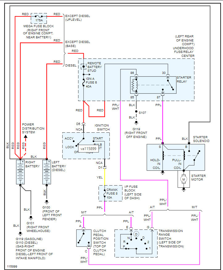

I have recently replaced the starter less than two months ago. Went to start the SUV and the 40 amp fuse blew in the run position. Looking for information on where to look for wires that could be short or the ground that may be loose.

If the 40 amp fuse is blowing then the most likely cause of this is the starter itself. This is a pretty large fuse and it feeds not only the starter but the ignition switch as well.
However, even if the ignition switch is shorted, it is unlikely to blow this fuse.
I would suggest unplugging the starter, replace the fuse and see if the fuse blows again when you turn the key back on.
This will prove out if the starter solenoid is shorted.
If you follow the wiring diagram below you will see that the fuse feeds the supply side of the relay and when the relay is applied and the fuse blows then the starter is the likely issue.
Please run through this info below and let us know if you have other questions. Thanks

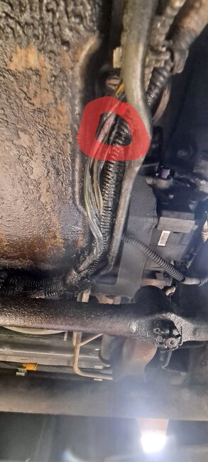

Unhooking the 2 cables from the posts on the starter after unplugging the battery obviously. Then plug the battery back in. New 40amp ignA fuse. Try to start and I get the clicks like a bad starter right. But no fuse blown. So, if I change the starter, it'll work right away but then sooner or later blows the fuse. Ign A. Everyone is saying dead short/ground out, but I don't see it yet. Then how if I swap the starter, it works right away? Then it doesn't. So frustrating.

If it starts when you first replace the starter, you must be moving something. Are the cables at the starter motor in good condition?
Try this. Disconnect the battery and then the starter motor. Then reconnect it. See if it works. If it does, we have a wiring issue.

I'm not finding anything super crazy like burned or frayed nicked wires. It's not something damaging to the starter or solenoid, right? Or could a bad alternator be sending the wrong voltage? Just wondering if my starter is actually causing the problem at all. Which it can stay. Those fuses are 5$ a piece though! 40-amp jcase box fuse. Because like I said if I warranty my new starter and swap it the truck will start right up. Trying to cover all my bases because I've changed the starter twice and now starter relay as well. And it worked great.

That's the trigger wire for the starter motor. It only should have power when the key is in the start position. That would explain why it worked once. LOL Anything to make things a bit more difficult. Also, that wire was originally purple. LOL
Regardless, I'm glad to know you found the problem. Feel free to come back anytime in the future.
