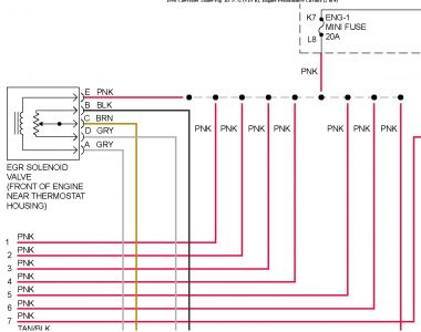

MY (ENG 1) FUSE BLOWES WHEN I TURN THE KEY TO THE ON POSITION, THIS IS A 20 AMP FUSE UNDER THE HOOD. PLEASE HELP!

IS the IGN A fuse-40 amp good? Ive had a few ignition switches burnt up and shorting.

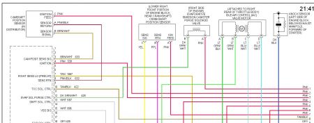

There are the o2 sensors on this circuit, IT feeds the IGN A circuit, ( reason I asked). Also the cam position sensor and egr.
