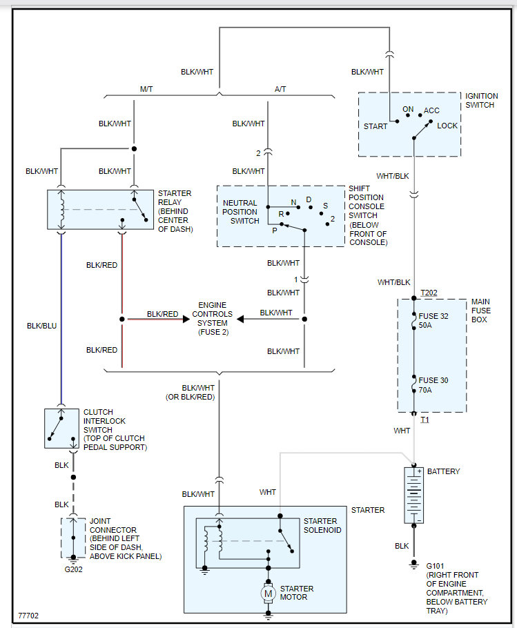

I just changed the ignition fuse under the hood and now my car won't start. What should I do?
Jun 23, 2021 at 9:03 AM
If all you did was change the fuse then I suspect it was a faulty fuse.
Let's start with testing that fuse before we go much further.
If that checks out then let's run through this guide that will help with where to start:
https://youtu.be/dCjmRL3p4Cs

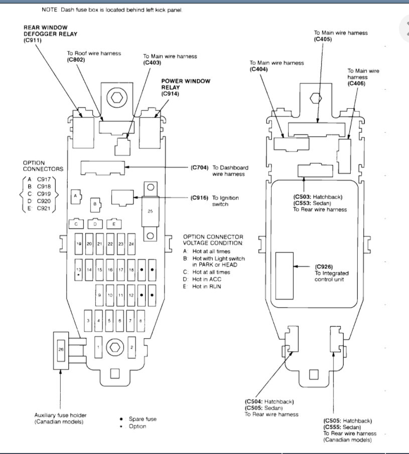

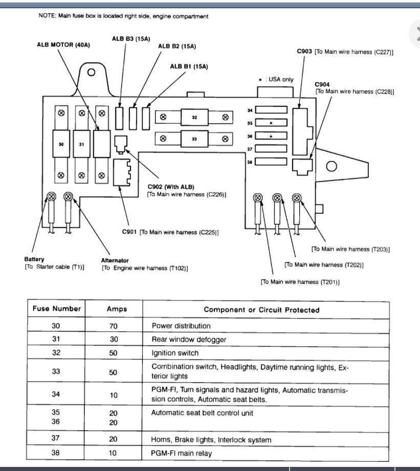

Below are the fuse diagrams but I would suggest with starting with checking voltage at the starter. I assume that you have a crank no start. Meaning it will turn over but not start.
Please run through this info and we can go from there. Thanks
