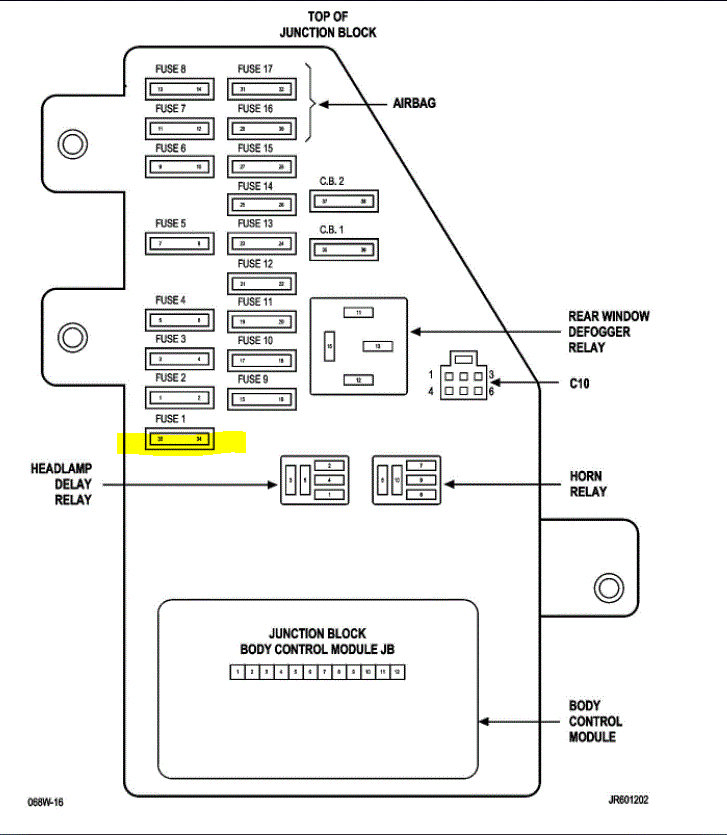

power windows stop working. can't find original manual to which fuse to change . help
May 11, 2013 at 6:23 PM
  • 110,194 POSTS
The power windows are powered via a 30-amp circuit breaker located in the relay box at the left side of the vehicle at the end of the dash. The door will need to be opened to access the box.
When testing a fuse or circuit breaker, it is always a good idea to check for power both to the fuse and from it. Here is a link that shows how that is done:

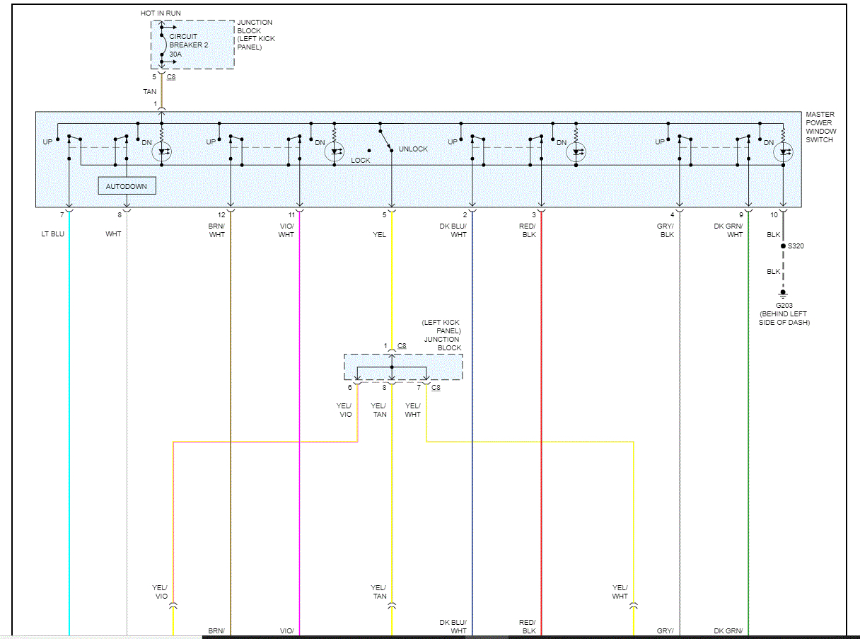

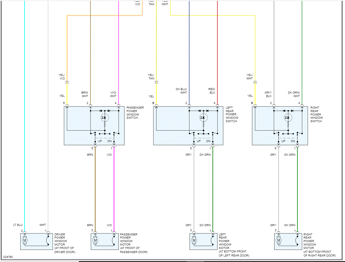

Additionally, I have attached the wiring schematics below specific to the power windows in the event you need them.
