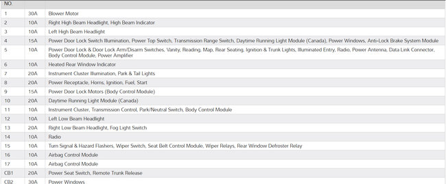

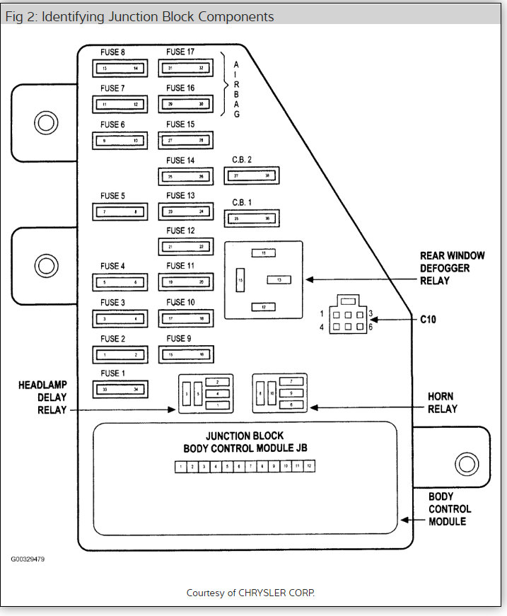

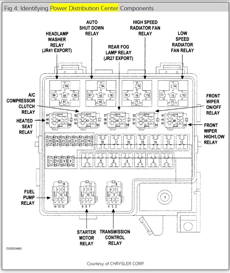

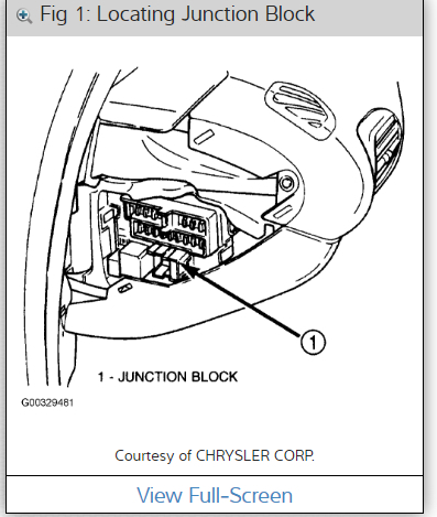

my power windows stopped working.I checked the fuse box under the hood and the ones i could check showed no broken links. I dont have a manual so i dont know which fuse (if any) controls the windows. Is there another fuse box? please help ,thank you

It sounds like there is a power feed problem from the main switch which will need to be replaced. Here is a guide on how to test the switch before you replace it and the fuse location in the diagrams below
https://www.2carpros.com/articles/electric-window-repair
Check out the diagrams (Below). Please let us know what you find. We are interested to see what it is.
