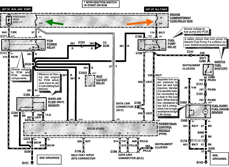

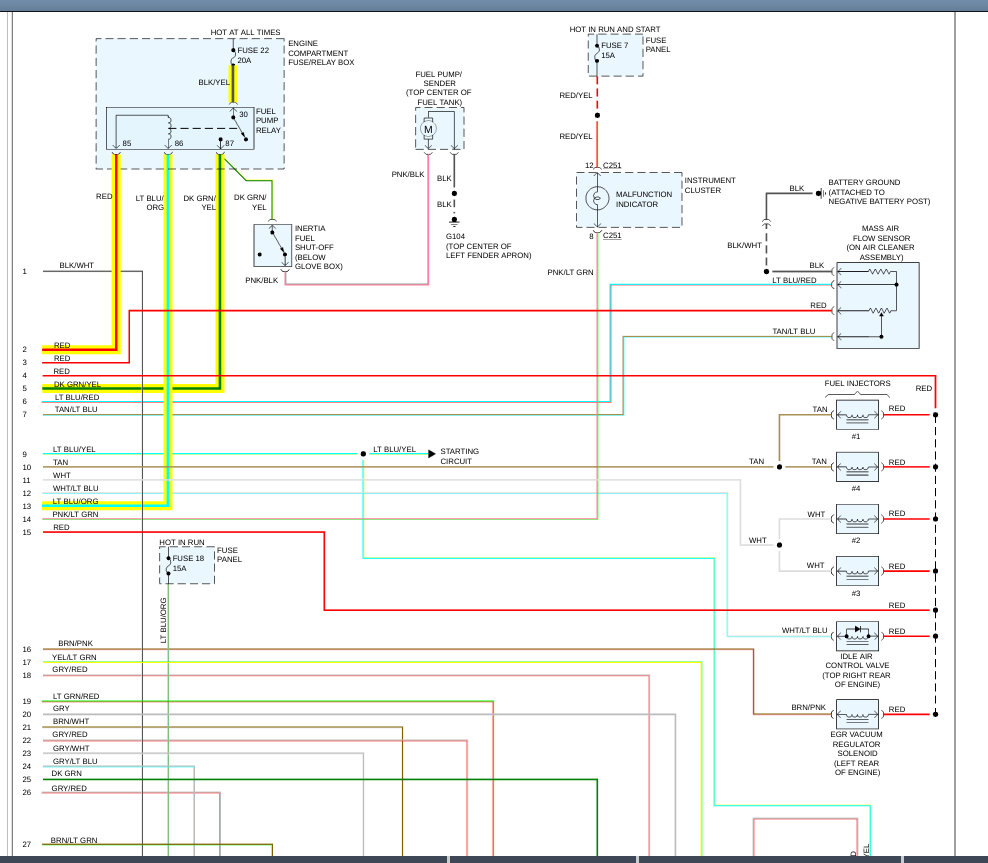

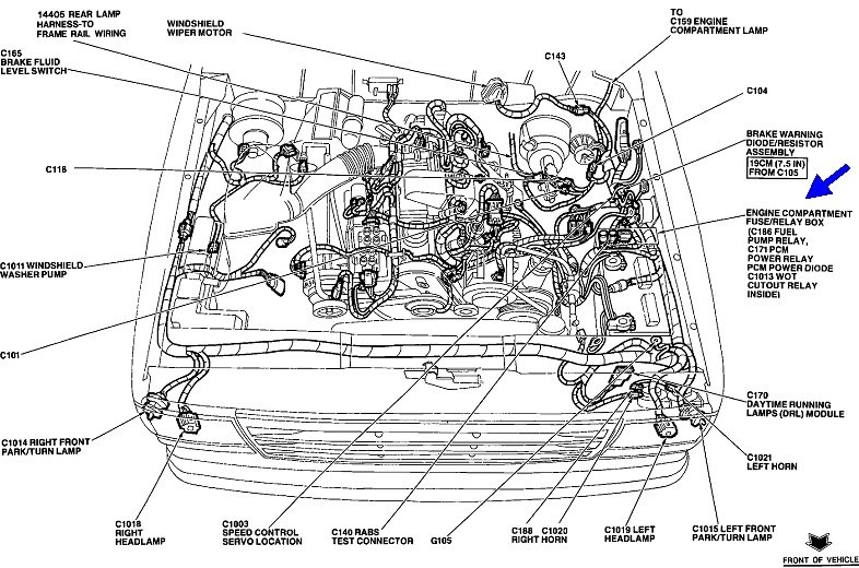

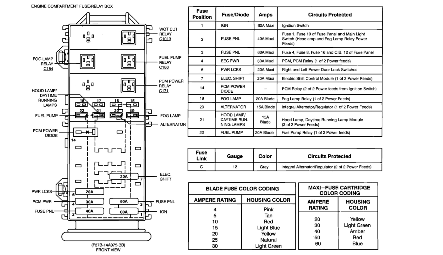

New fuel pump not getting hot on pin 85 the red wire.I can jumper 87 to 30 at relay and pump worked fine but no start now my pump does not come on even when I jumper. please help. I feel like it's a wiring issue but I'm not sure. This has been baffling me I'm on second fuel pump now it won't come on even when I jumper from 87 to 30 nothing. I'm getting power to fuel pump clip still no pump. I can't get power to red wire on 85 of fuel pump relay.
Jan 15, 2020 at 2:17 AM
CARADIODOC
  • 34,414 POSTS

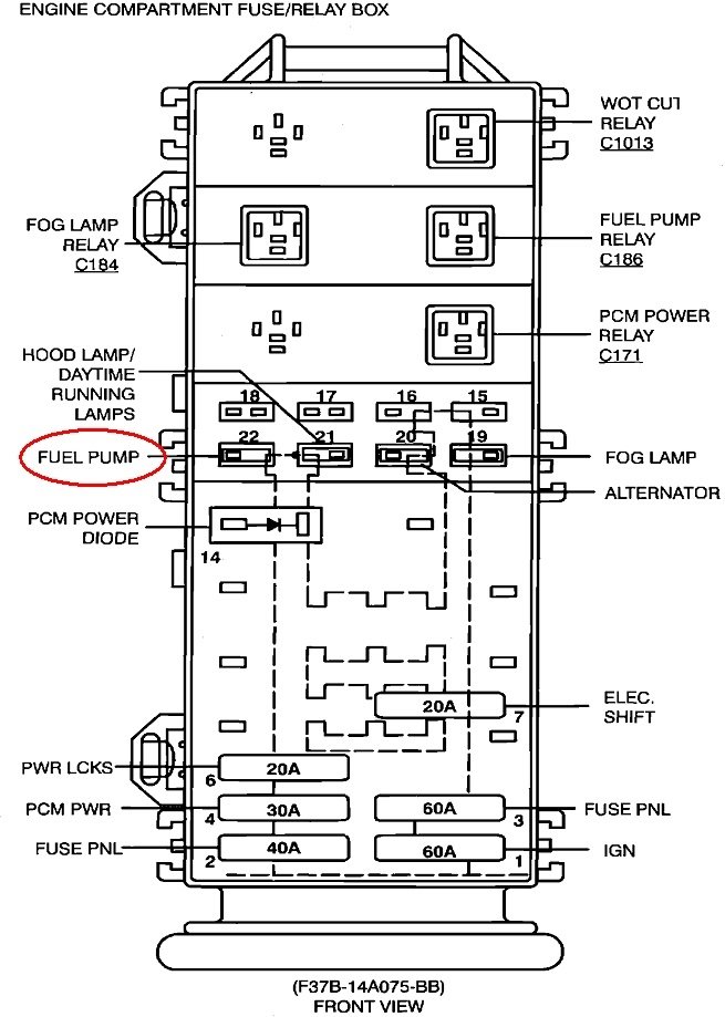

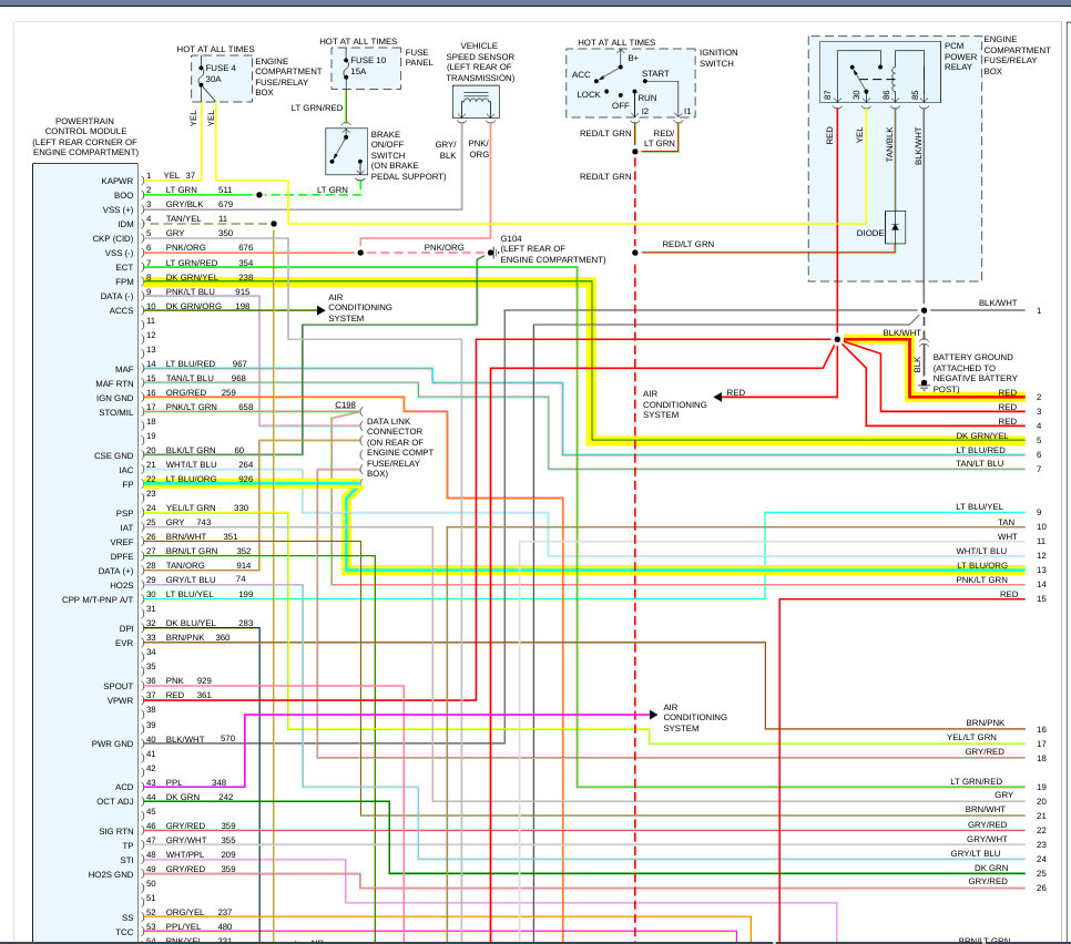

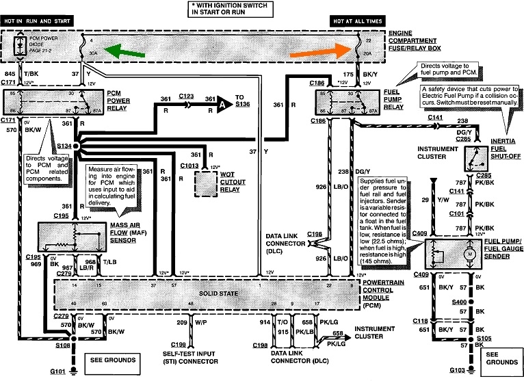

Two different fuel injection systems were used, but the fuel supply system is the same for both. It sounds like you have multiple problems, and blown fuses are good suspects for two of them. The missing 12 volts on terminal 85 of the fuel pump relay comes from the PCM power relay. Check fuse 4, a 30-amp in the under-hood fuse box.
Even if fuse 4 is blown, you're quite a few steps ahead in the diagnostic steps. The fuel pump still should have run when you jumped terminals 30 and 87 together in the fuel pump relay's socket. Since it didn't, and you already replaced the pump, the list of suspects, in order of likelihood are a blown fuse 22, a tripped inertia switch, and a broken ground wire at the tank. If there's a problem with the ground wire, the fuel level gauge won't be reading correctly either. Here is the relay location and test guide
Check out the diagrams (Below). Please let us know what you find. We are interested to see what it is.

Changed fuel pump no start. so I hampered 87 to 30 on fuel pump relay pump works. couldn't get it to start gave up come out 1 week later even jumper can't get it to come back on.
Nov 24, 2020 at 12:06 AM (Merged)

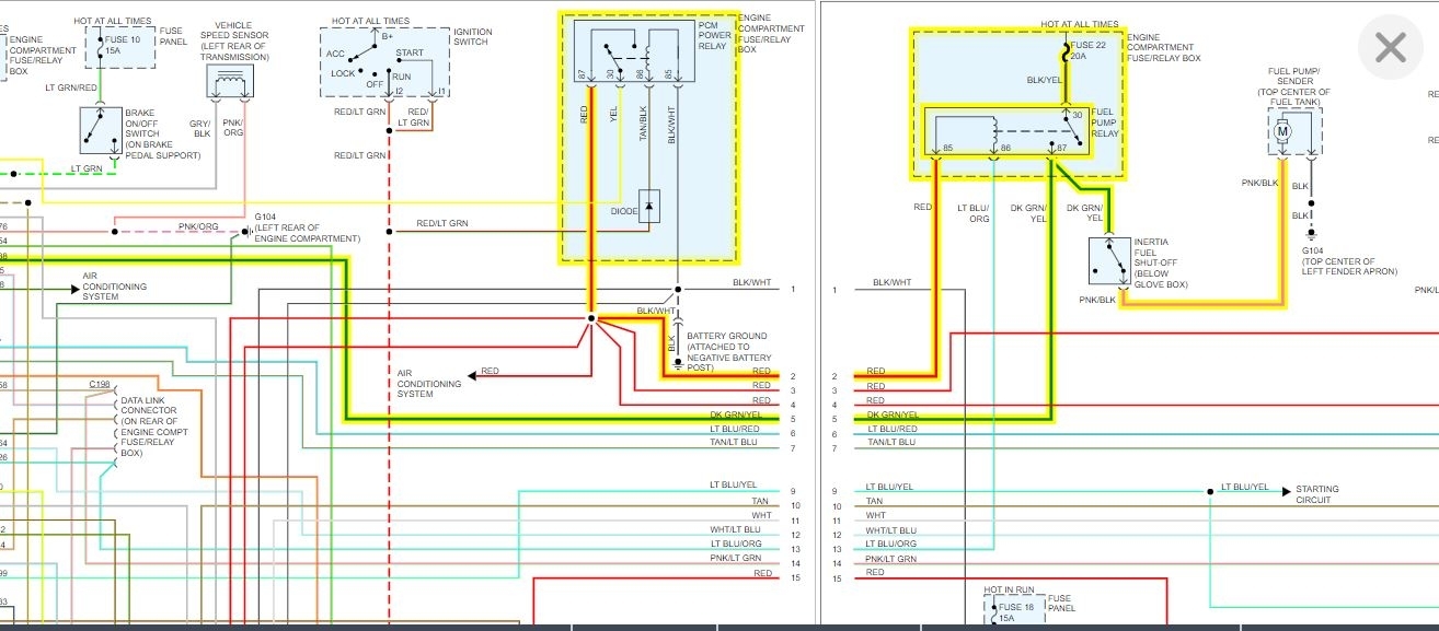

Good afternoon,
Did you check for power at pin 30?
Did you check for power to pin 86 with the key on.
I attached a wiring diagram for you to view. Check the fuse for the pin 30 with a test light to verify voltage.

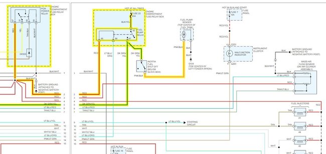

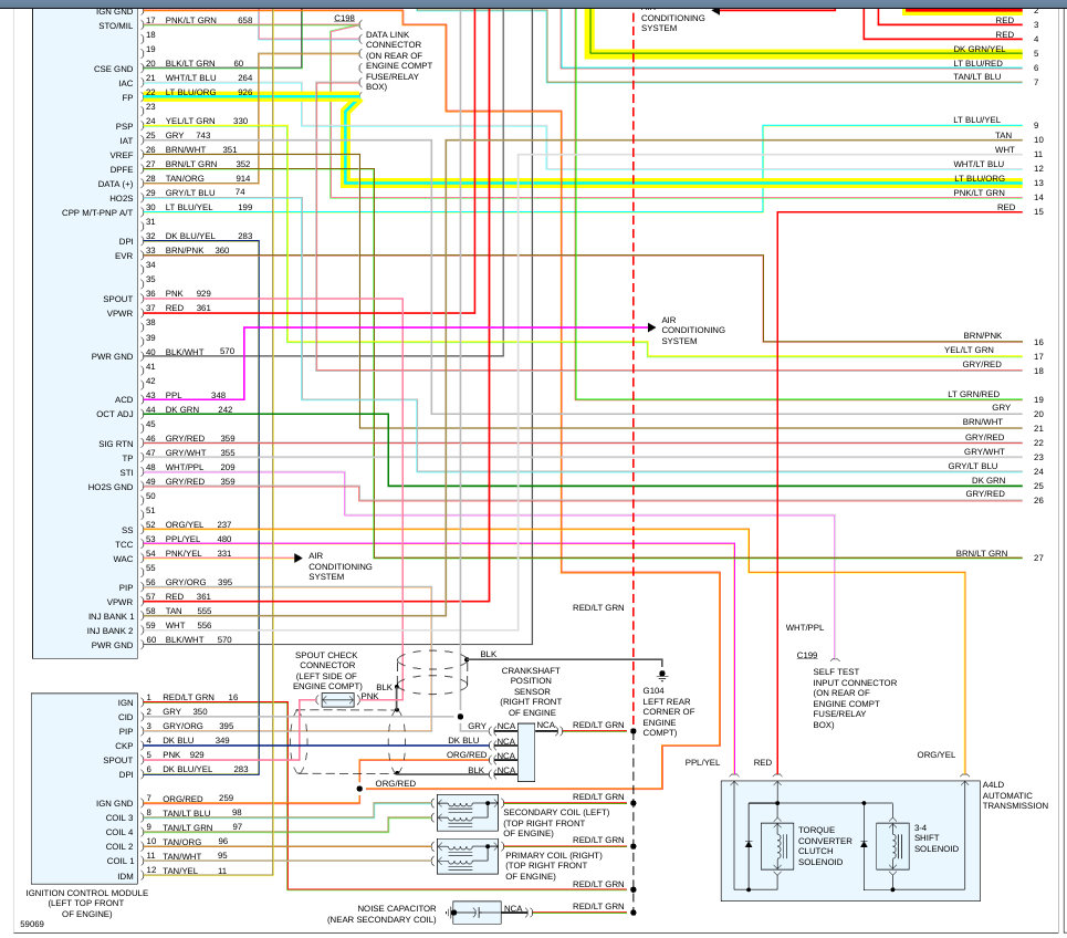

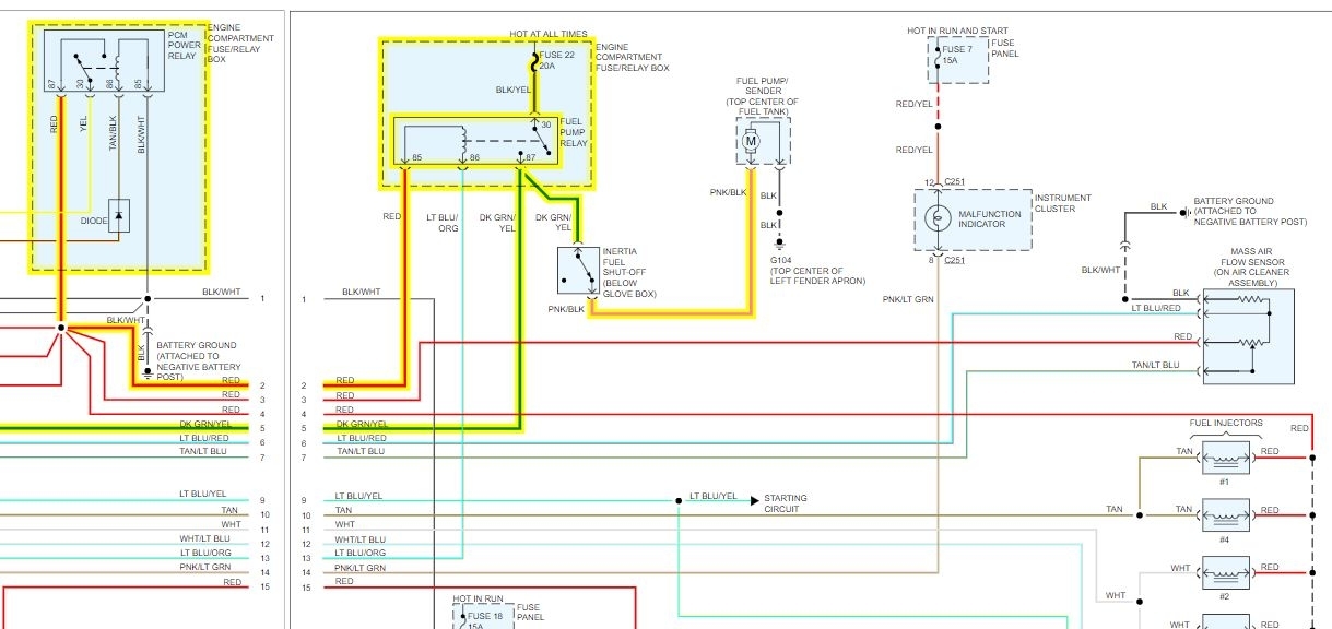

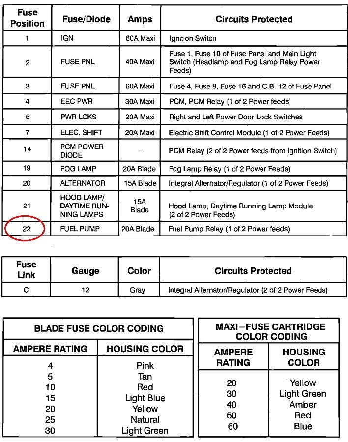

Okay, in the diagrams down below I have included the engine management wiring diagrams for your vehicle with the fuel pump circuit highlighted for you as well as a diagram with call out for the Under hood Fuse/Relay Box, and a diagram of a pin relay for your reference. Okay, so first things first, can you please check fuse #22[20A] of the Under hood Fuse/Relay Box for us. Please get back to us with what you are able to find out.
Thanks,
Alex
2CarPros
SHORTYDAWG
  • 41 POSTS
30 has power but 86 does not. 20 amp fuse looks fine.
Okay, sorry, it is 85 that gets power form the power relay right next to the fuel pump relay. You should have power there for 2 seconds with the key on. That is controlled by the ECM.

Okay, no power to 85 with key on.

And I'm testing fuel pump relay red wire is 85 no power with key on.

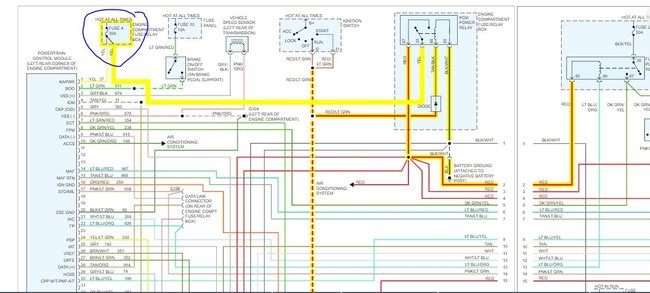

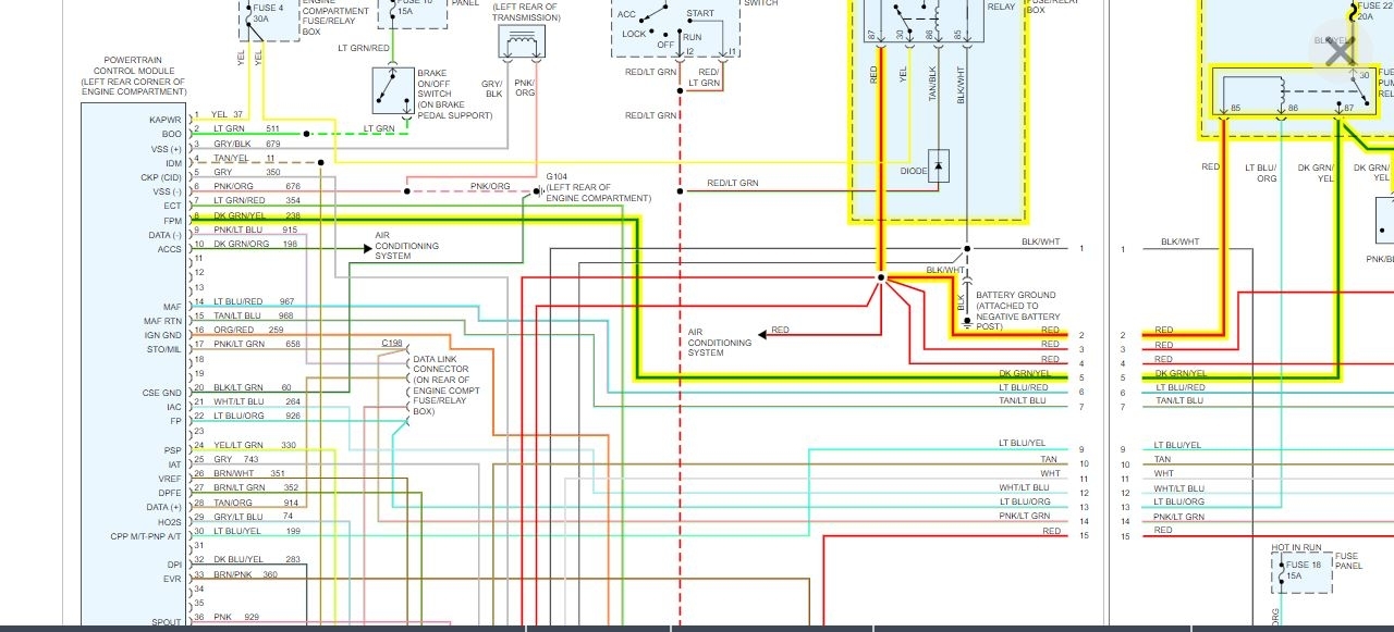

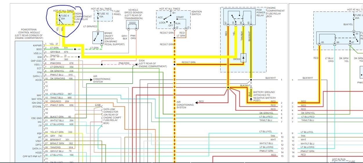

With the key on, it should have 12 volts for 2 seconds.
If it does not, then you need to check the power relay next to it.

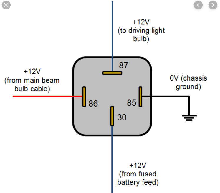

I attached a diagram for the relay. Check the fuse I circled. Make sure there are 2 powers with the key on.
SHORTYDAWG
  • 41 POSTS
Okay, on the fuel pump relay 30 has constant power 85 does not with key on.on power relay 30 has constant power and 86 has power when key is on.I'm not getting power to 85 on fuel pump relay when key is on.
Okay, you may have a bad relay.
Does it click when you turn on the key?

Okay, no click when I turn on key, I have 3 other relays and swapped them out still the same thing, I tested for power on fuel pump relay, 30 has power 85 does not, so tested grounds, strange 85 which is red wire and it's grounded also 87 is grounded almost like it's the opposite of what it supposed to be.

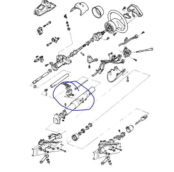

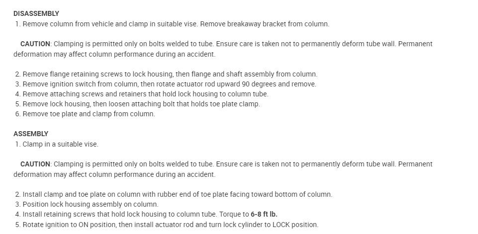

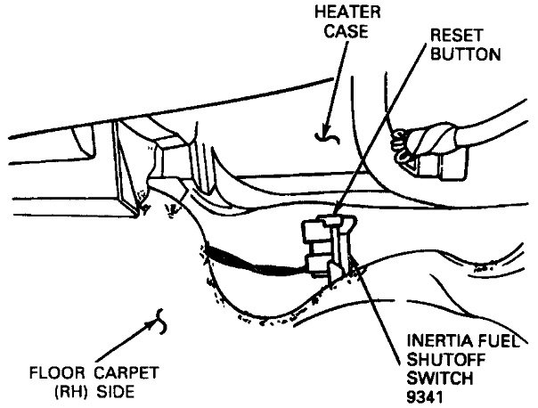

Okay, looks like you need an ignition switch.
I attached the location for you. It is at the bottom of the steering column and is attached by 2 bolts.
SHORTYDAWG
  • 41 POSTS
Thanks Mr Roy. this truck has whooped me. I'll get an ignition switch and let you know.I was thinking maybe it had something to do with it wasn't sure. needed to hear it from a professional.have a wonderful New year and I'll update you.

There is a relay in the under hood fuse block and a reset switch on the inside of the truck behind the kick panel on passenger side under glove box(small black plastic with red button on top)
