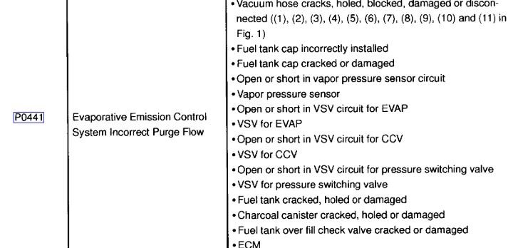

Check engine light was illuminated. I took the car to AutoZone where they pulled the code PO441 indicates that the Evaporative Emission System has incorrect purge flow for a predetermined period of time. (The light came on this morning) Suggestion is that I replace the Evaporative (EVAP) Vapor Pressure Sensor.

The sensor could be the issue; however, there are many other things which can cause this code. Look at picture 1 that I attached. It lists all the things which can lead to this problem. Yes, one is the pressure sensor, but to arbitrarily replace it can be a waste of money. Basically, for this code to set, there has to be no pressure change in the fuel tank or the charcoal canister. I know this may sound confusing, but when the pressure sensor opens, pressure should drop and that isn't happening.
With all that being said, yes, the sensor could be bad. However, it is one of many things that can cause this code. Take a look through the image I attached.

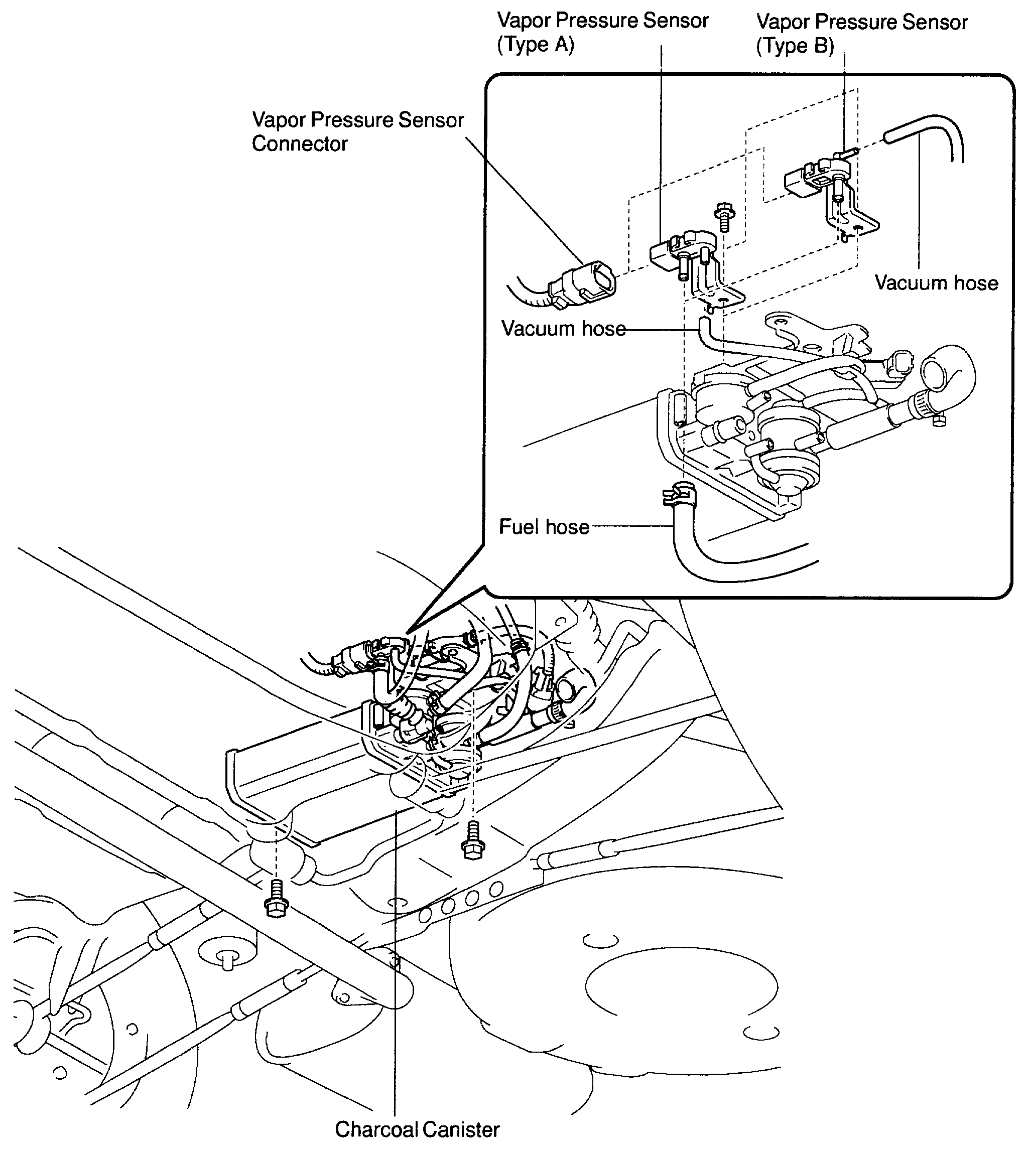

Here are the directions for testing the sensor. All remaining pictures correlate with these directions. The component is located under the vehicle near the fuel tank.

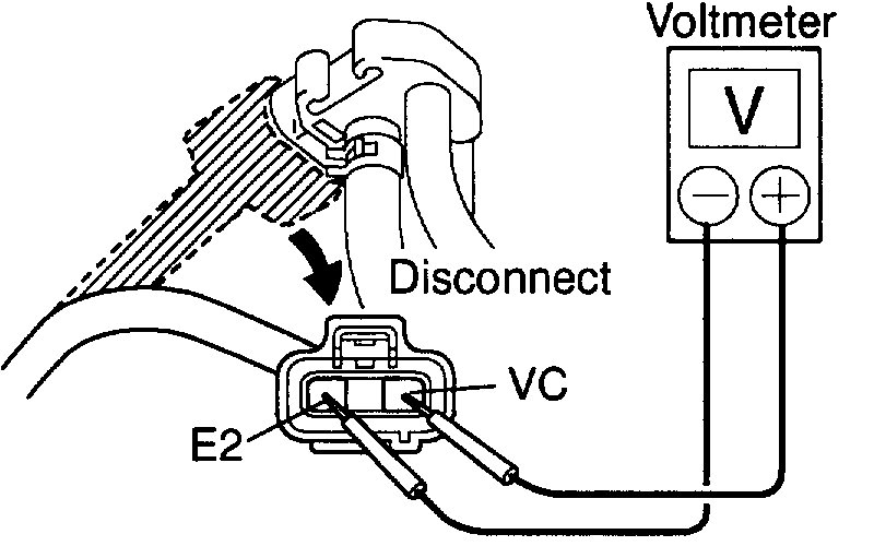

1. INSPECT POWER SOURCE VOLTAGE OF VAPOR PRESSURE SENSOR
a. Disconnect the vapor pressure sensor connector.
b. Turn the ignition switch ON.
c. Using a voltmeter, measure the voltage between connector terminals VC and E2 of the wiring harness side.
Voltage: 4.5 - 5.5 V
d. Turn the ignition switch OFF.
e. Reconnect the vapor pressure sensor connector.

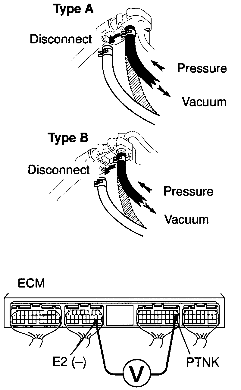

2. INSPECT POWER OUTPUT OF VAPOR PRESSURE SENSOR
a. Turn the ignition switch ON.

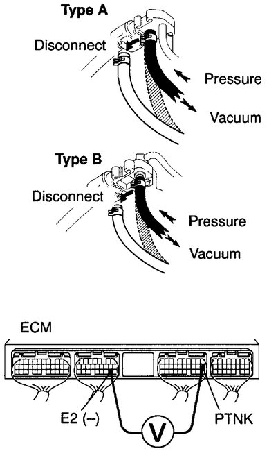

b. Disconnect the vacuum hose from the vapor pressure sensor.
c. Connect a voltmeter to terminals PTNK and E2 of the ECM, and measure the output
voltage under the following conditions:
1. Apply vacuum (2.0 kPa (15 mmHg, 0.59 in.Hg)) to the vapor pressure sensor.
Voltage: 1.3 - 2.1 V
2. Release the vacuum from the vapor pressure sensor.
Voltage: 3.0 - 3.6 V
3. Apply pressure (1.5 kPa (15 g/sq.cm, 0.22 psi)) to the vapor pressure sensor.
Voltage: 4.2 - 4.8 V
e. Reconnect the vacuum hose to the vapor pressure sensor.
Do not be intimidated with the directions. It is actually not hard to do. If you determine the part is bad, all that is required to replace it is to disconnect the wiring/ plug, remove vacuum hoses, and one bolt mounts it. It would take thirty minutes maximum to replace. Make sure none of the rubber vacuum hoses are damaged, disconnected, split, or dry rotted.
