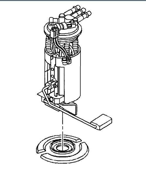

Hello, I recently bought the SUV listed above off a guy that gave up on it after he couldn’t get it started. it cranks but won’t start. He said he replaced the cap and rotor, the fuel pressure regulator and he said he tested the fuel pressure and it read 50 psi. When you turn the key you can hear the fuel pump turn on, when I sprayed brake clean into the intake it started right up but shut off 10 seconds later. Checked all the fuses and they are good, what do you guys think?

You need a fuel pump. You need a minimum of 60 pounds for it to run. I attached the spec for you to see.
With a new regulator, that leaves the pump itself.
https://www.2carpros.com/articles/how-to-replace-an-electric-fuel-pump

Thank you! He said it was the injectors but I didn’t suspect that after I got it running off the brake cleaner. picked up a fuel pump that fixed it.
