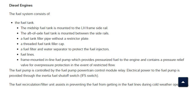

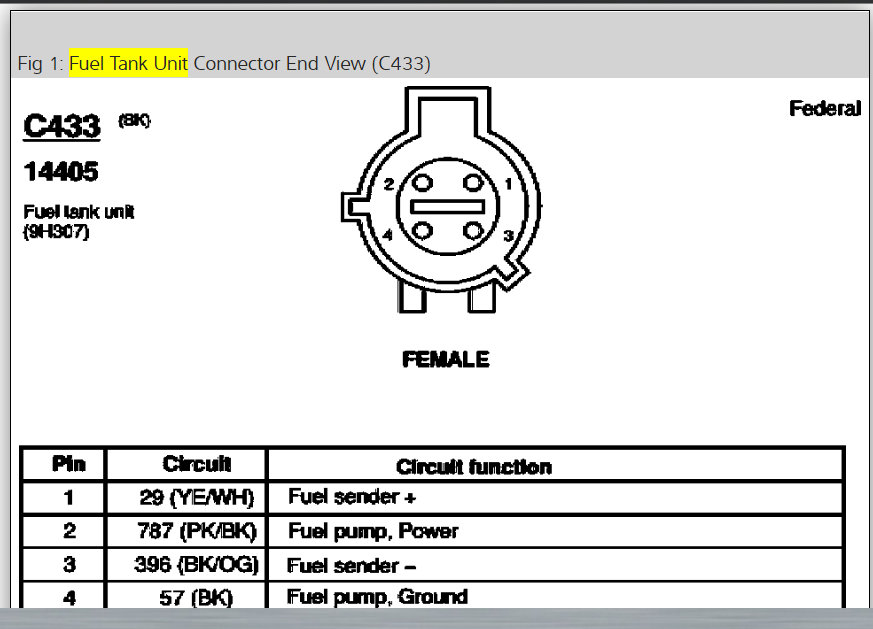

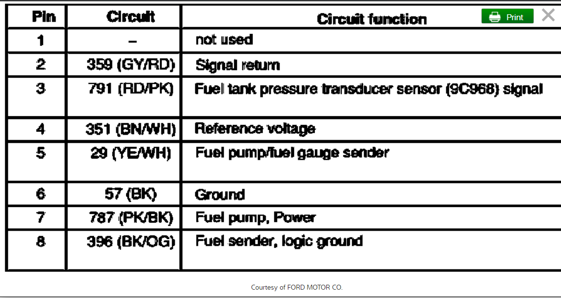

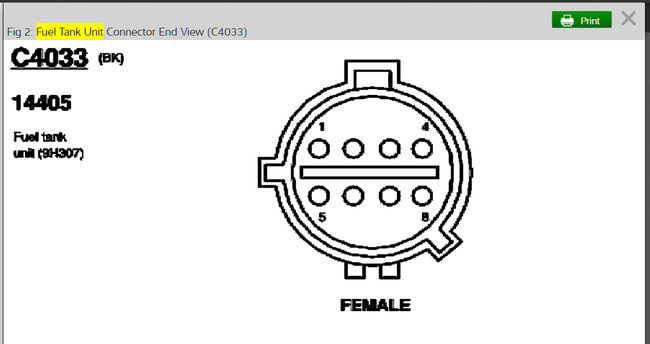

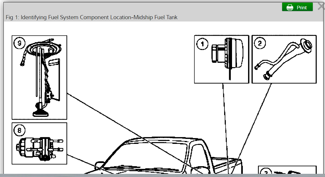

Putting new fuel pump in and it only has two electrical plugs connections and the old pump on the truck has three plug ins.

Is this a diesel truck?

Yes.

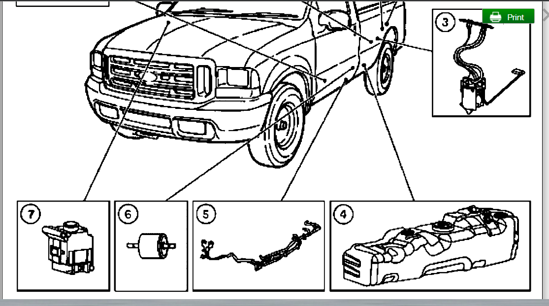

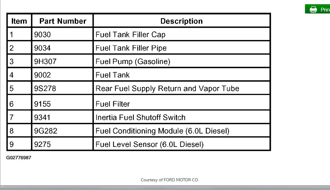

It looks like pin 2 and pin 4 are the ones you want to use for your new fuel pump power. I have included in the diagrams down below all the components of your vehicles fuel system as well as the connector views for you to determine what two wires deliver power to the fuel pump you are replacing. Please don't hesitate to ask should you have any more questions about anything automotive. That's what we are here for.
