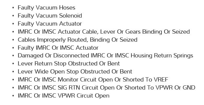

try this also check fuel pressure with a gauge auto parts rent it. this is for a 3 port fuel valve.
