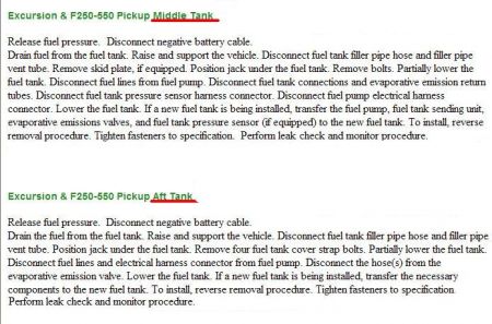

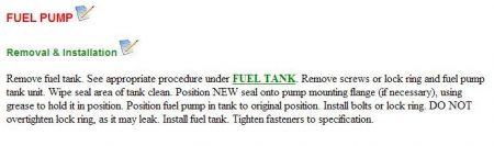

2002 Ford F250 Changing fuel pump
BRITTNEYM
Engine Mechanical problem
2002 Ford F250 V8 Four Wheel Drive
How do you change the fuel pump? Do you have to have any "special" tools?

Gasoline fuel pump replacement below...please let me know if your engine is diesel as steps may differ...
https://images.2carpros.com/forum/automotive_pictures/261618_Noname_1381.jpg
https://images.2carpros.com/forum/automotive_pictures/261618_Noname2_410.jpg
