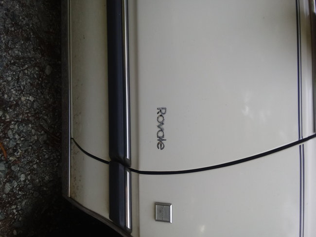

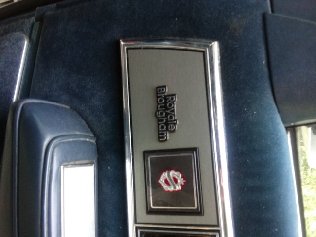

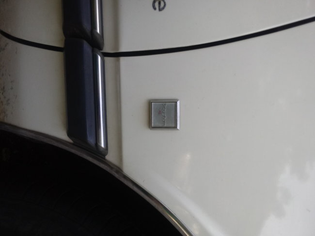

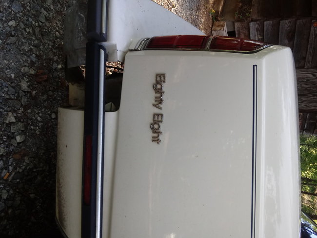

That is everything on it that says the model so I assume a 1989 88 Royale.

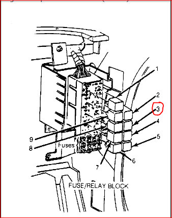

Okay, check under the dash as I stated before and see if the relay center is there.

I did not see one on passengers side or driver.

Hello, I am Danny.
To help you and Roy if you are still looking for the fuel pump relay it is located in position #3 in the fuse/relay box which is located behind right (passenger) side of dash, to right of the glove box. I have attached a picture and circled relay in red. Hope this helps and feel free to ask any questions. Thanks for using 2CarPros.
