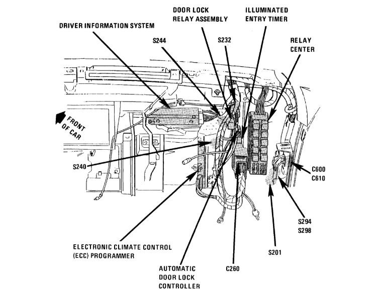

The relay is in the relay center. I attached a picture of the location for you to view.

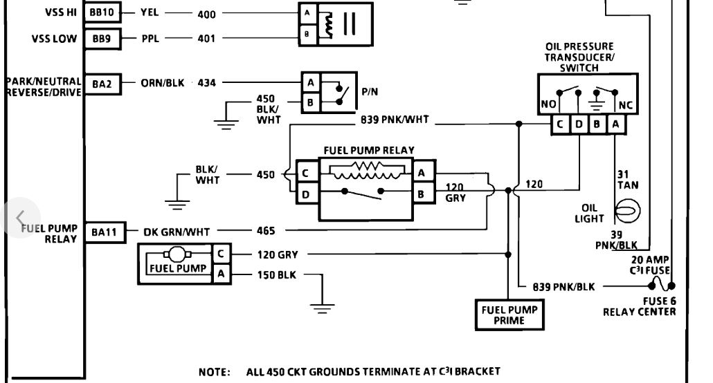

When the key is first turned "on," without the engine running, the ECM will turn the fuel pump relay "on" for two seconds. This builds up the fuel pressure to normal operating pressure. If the engine is not started within two seconds, the ECM will shut the fuel pump "off" and wait until ignition reference pulses are present. As soon as the engine is cranked, the ECM turns the relay "on," which powers the fuel pump.
As a back-up system to the fuel pump relay, the fuel pump can also be turned "on" by the oil pressure switch. The oil pressure switch is a normally open switch which closes when oil pressure reaches about 28.0 kPa (4.0 psi). If the fuel pump relay fails, the oil pressure switch will power the fuel pump.
- A faulty fuel pump relay can result in long cranking times, particularly if the engine is cold.
- An inoperative fuel pump would cause a no start condition. A fuel pump which does not provide enough pressure can result in poor performance.

I would assume more the pump than the relay. I would verify power at the fuel pump while cranking first.
Also, check the 20 amp fuel pump fuse as well.
Sep 5, 2018 at 10:46 AM
LEE ADKINS
  • 13 POSTS
How would I go about verifying power at the pump?
Sep 5, 2018 at 10:55 AM
You need to go to the connector at the fuel pump and check the gray wire as listed in the wire diagram. Use a test light or voltmeter to test for power while cranking?

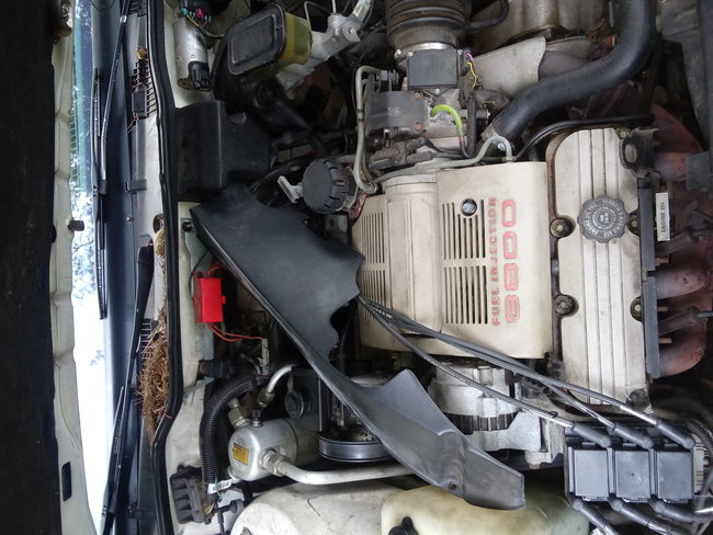

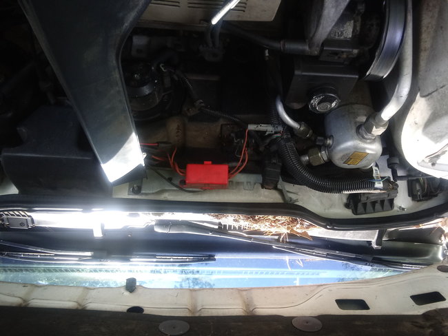

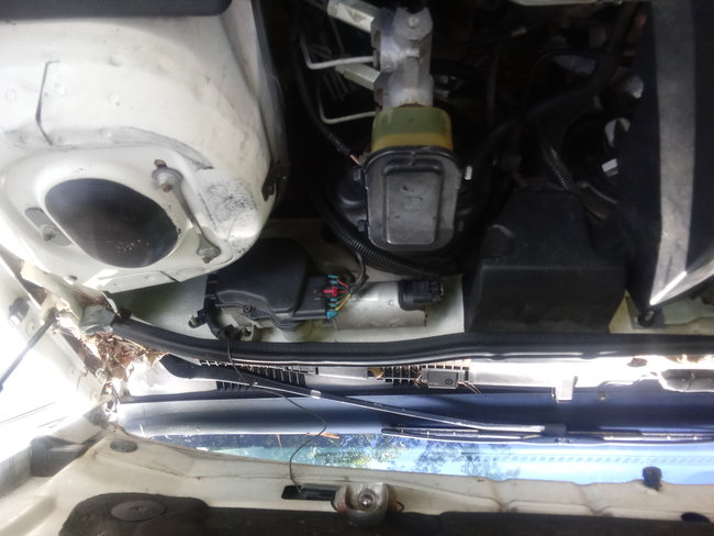

The diagrams you sent do not seem to match my car.
Sep 6, 2018 at 6:38 AM
What were those pictures?
Sep 6, 2018 at 7:27 AM
LEE ADKINS
  • 13 POSTS

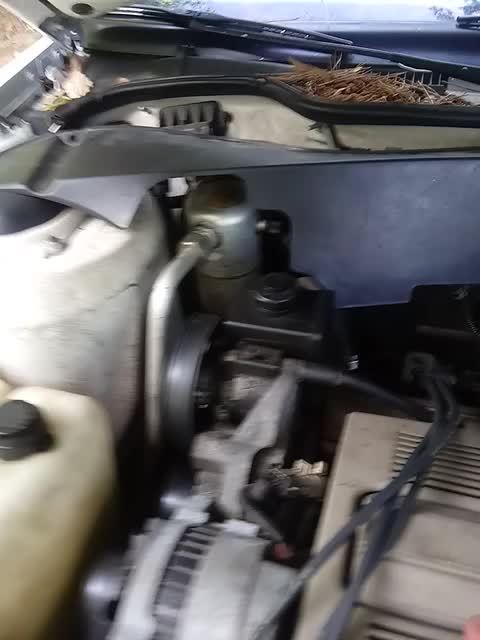

Under the hood facing the car.
Sep 6, 2018 at 7:29 AM
They are upside down. What am I looking at?
Is there a relay center there? The picture is not clear.
Sep 6, 2018 at 7:32 AM
LEE ADKINS
  • 13 POSTS
I cannot figure out why my pictures are upside down. But that is where I thought the relay center should be. That is the firewall area.
Sep 6, 2018 at 7:34 AM
There may be a black cover over it protecting it.
Check around the center of the firewall under the windshield.
Sep 6, 2018 at 7:39 AM
LEE ADKINS
  • 13 POSTS
That black thing you see there was a shield, but I see no relay center. Let me see if I can take a video.
Sep 6, 2018 at 7:41 AM
Look under the dash right side. 88 has it there.

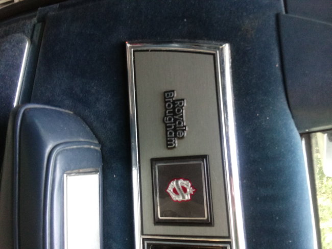

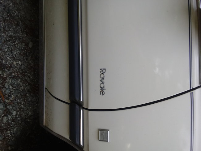

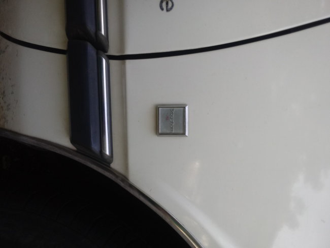

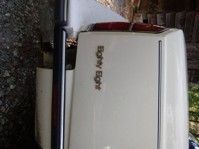

In your original question, you listed this as an 1989 Oldsmobile 88. Then I looked at your question and you said 88 Royal?
Is this an 1988 or 1989?
Sep 6, 2018 at 8:03 AM
LEE ADKINS
  • 13 POSTS
1989 model 88.
Sep 6, 2018 at 8:04 AM
LEE ADKINS
  • 13 POSTS
That is everything on it that says the model so I assume a 1989 88 Royale.

DANNY L
  • 5,648 POSTS
Hello, I am Danny.

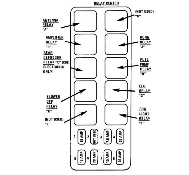

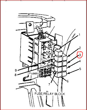

To help you and Roy if you are still looking for the fuel pump relay it is located in position #3 in the fuse/relay box which is located behind right (passenger) side of dash, to right of the glove box. I have attached a picture and circled relay in red. Hope this helps and feel free to ask any questions.Thanks for using 2CarPros.
