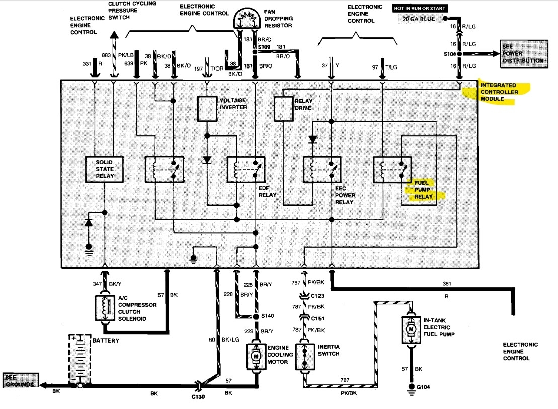

Fuel pump is not running where is the fuel pump relay located?
1987 FORD TAURUS
40,000 MILES • 3.0L • 6 CYL • 2WD • AUTOMATIC
RONNIEGLANE
cannot locate the fuel pump relay to replace it.

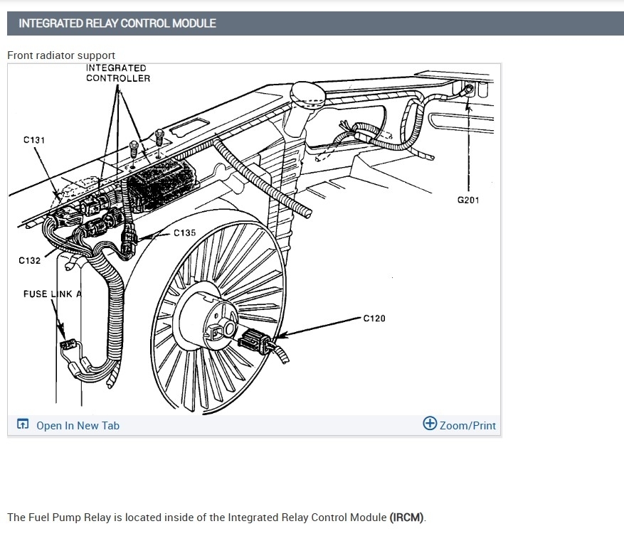

Hello, the fuel pump relay is part of the Integrated Relay Control Module, it's located right above the radiator cooling fan, on the front radiator support, I'll post a picture of its location and the wiring diagram to go with it.

I would check the fusible link and grounds in the first diagram, also check for power at the inertia switch, being a Ford, the inertia switches eventually always go bad since they are constantly carrying the all the fuel pump current. I own an older Ford, not a 1987 but early 2000s and had a no start one day, and just checked the inertia switch, unplugged it and plugged it back in, and the problem never came back. But I don't think you're going to find one of these integrated relay modules unless you can find a used one somewhere if that happens to be the issue. Make sure it has all its power feeds. Service info on a vehicle this old is limited, but I'll look for some operational info on it.

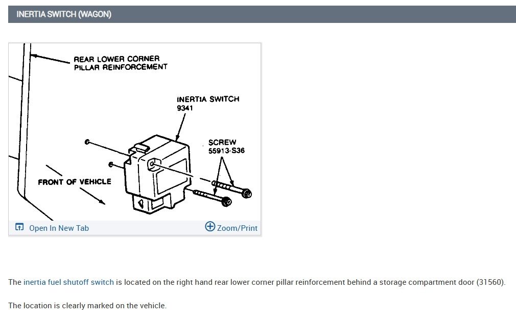

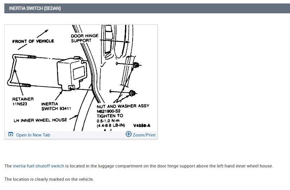

Here are the locations for the Inertia Switch for the Sedan and Wagon. It should have just 2 wires, power in and out going to the fuel pump. Also notice the PCM relay is located in the Integrated Relay module, the module is not in a good location, so check the connectors for corrosion as well. If you have power on the pink/black wire, move on to the inertia switch next.

Thanks for the help. The illustration of the PCM was perfect. I removed the Ford Vehicle Emission Control Information plate above the radiator and there is the PCM. I will clean the pins and test the pink/black wire. Then on to the inertia switch. This was my fathers car and has been sitting for 12 years. It runs when I spray fuel into the intake. I expect the fuel pump is stuck. I have a new fuel filter and may apply air pressure from the fuel hose at the filter into the tank. I have added 5 gal gas to the tank it was almost empty.

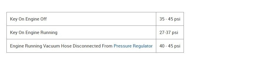

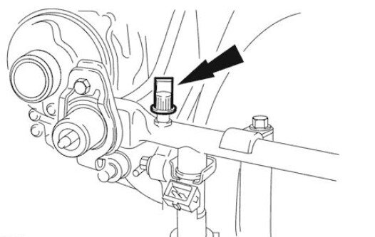

The box above the radiator is just an integrated relay box, its not the main PCM, it just has a bunch of relays soldered onto one circuit board which makes it difficult because you cant just replace one relay, unless you take it apart and attempt to solder in new ones, but that is complicated. If the vehicle has been sitting for 12 years, I can almost guarantee that the fuel injectors are frozen. Ive seen that on vehicles that have been sitting for only 1 year. I wouldnt recommend shooting any compressed air down the fuel lines, you need to see if theres any fuel pressure getting to the fuel rail. Fords are easy to check for fuel pressure, there is a small port on the fuel rail thats easy to screw a fuel gauge onto, There should be a small plastic cap over the port, just take that off and you'll see the small port that has threads on it. Harbor Freight has a cheap fuel pressure kit that should have the correct adapter, Ford is the small one. When you turn the key On, you should hear the fuel pump prime for about 2 secs. Then check the pressure gauge.

the guide below shows how to check for pressure and the one below that shows how to check for fuel injector control, But if they are seized up, they will still show a pulse on a test light, sometimes you can tap on the injectors to free them up, but if that doesnt work, the fuel rail will have to come up to check them, there is a tool you can buy to pulse the injectors and watch for fuel pressure drop on the pressure gauge, thats how we test for injector flow rates when diagnosing a bad injector.

2nd pic is a Ford fuel rail pressure port. Its usually the smallest adapter in a test kit.
