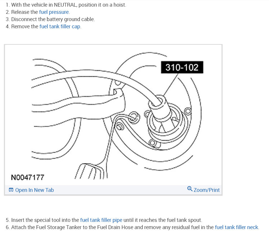

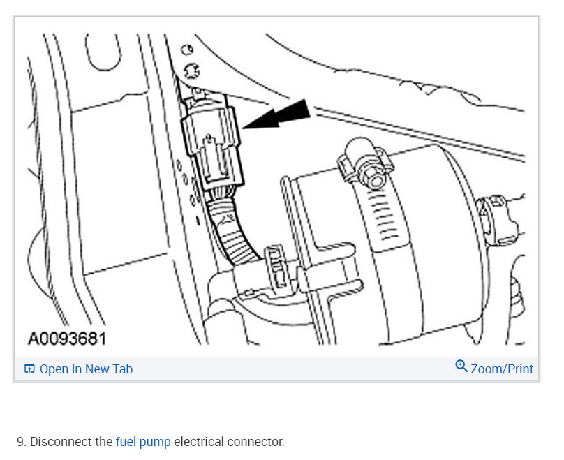

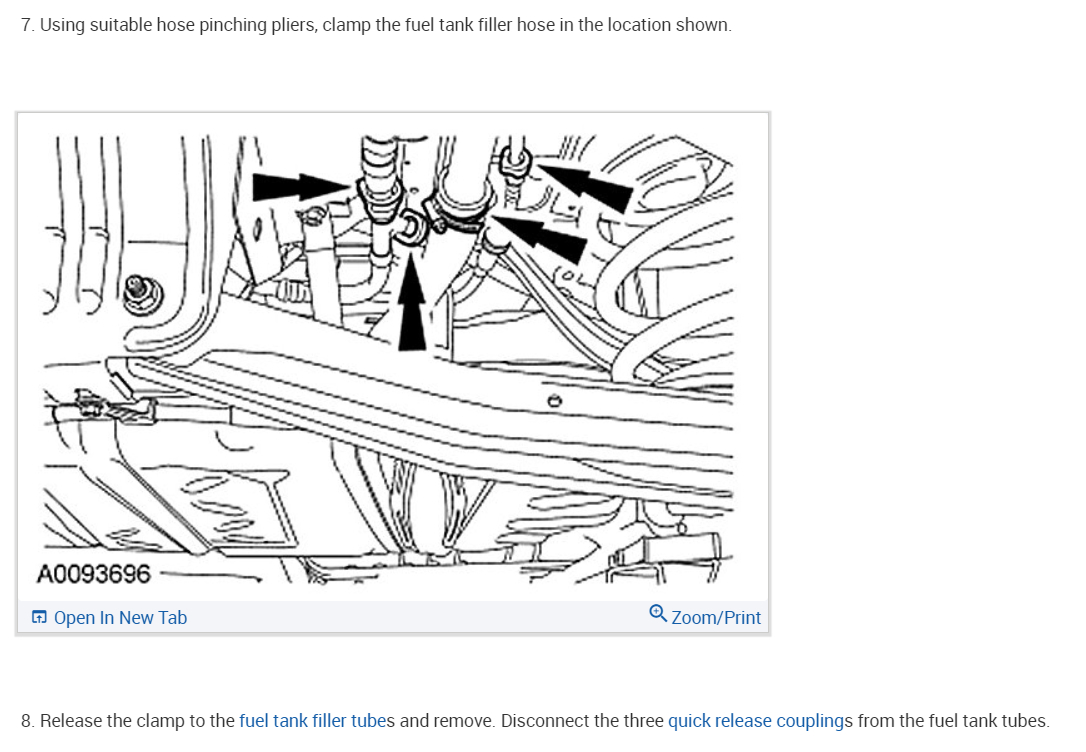

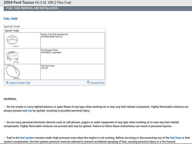

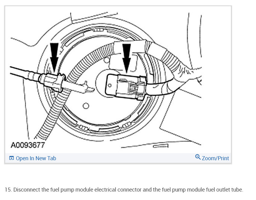

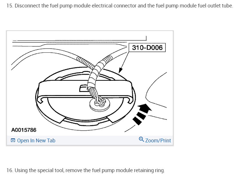

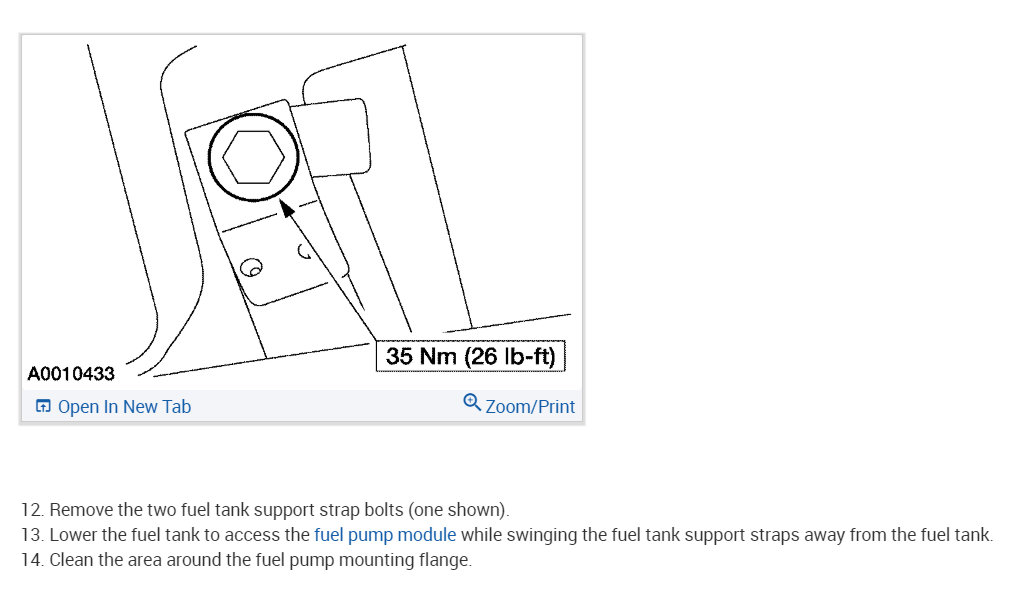

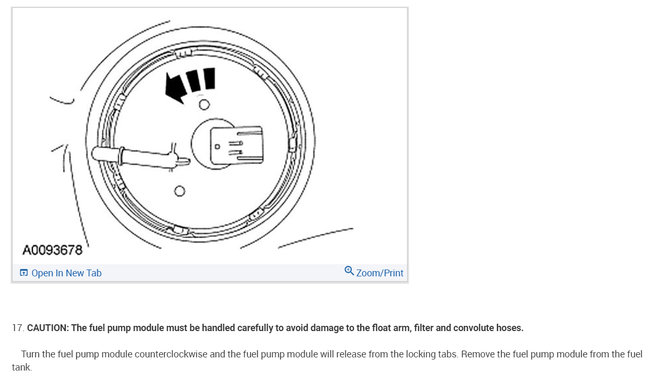

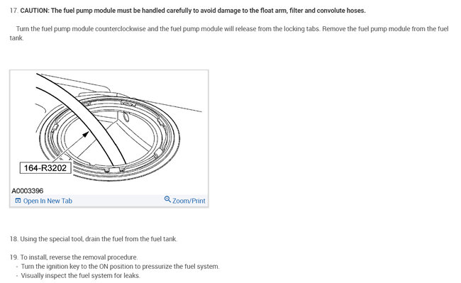

Where is the fuel pump and do I need any special tools to change it?
Apr 21, 2009 at 2:31 AM

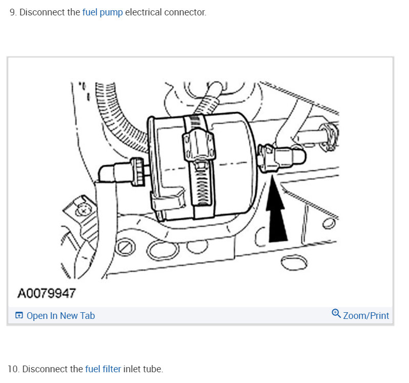

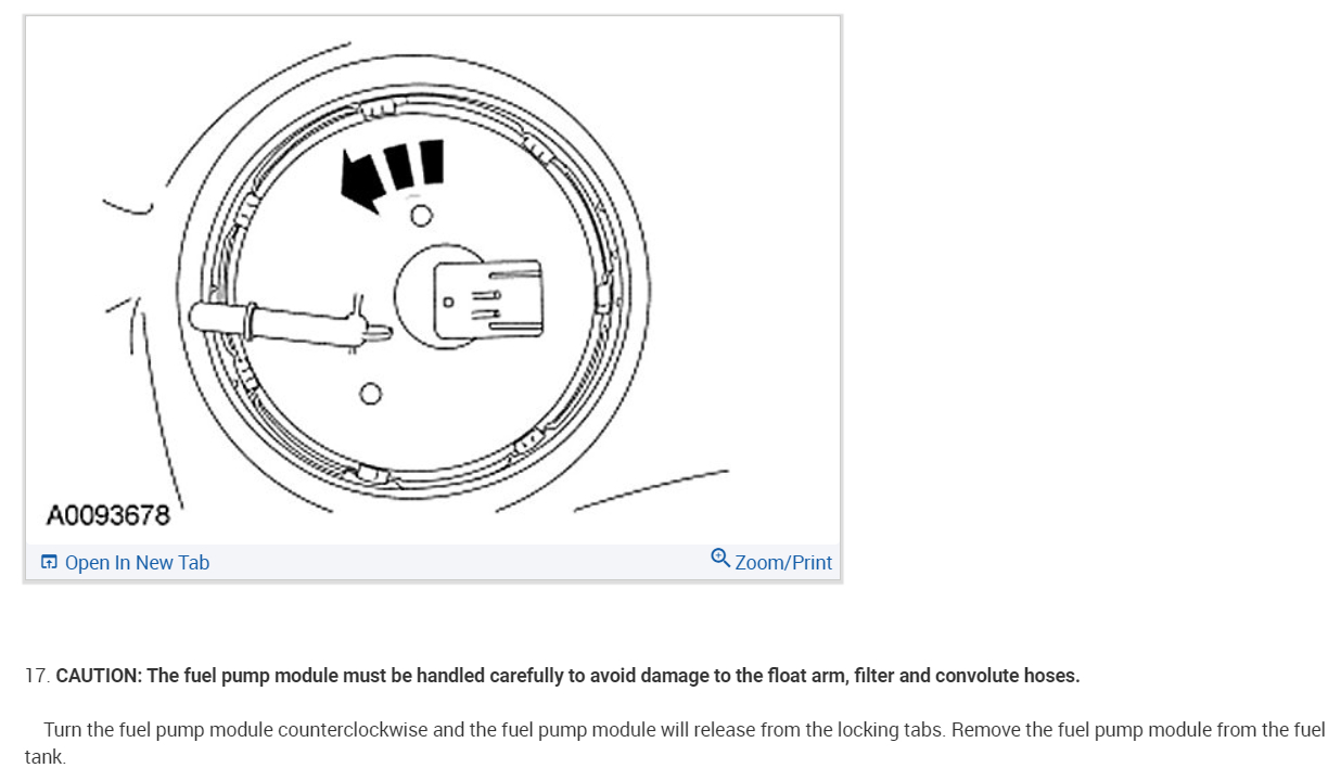

JGAROFALO
  • 489 POSTS

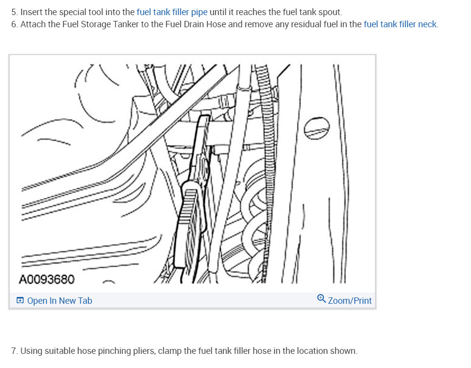

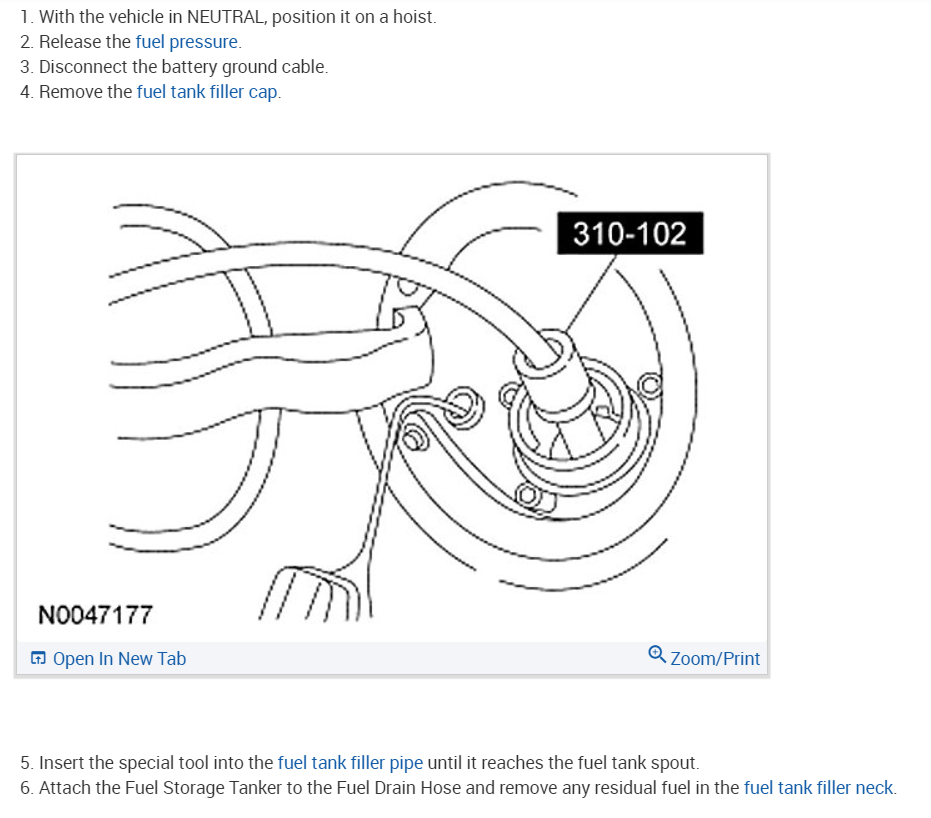

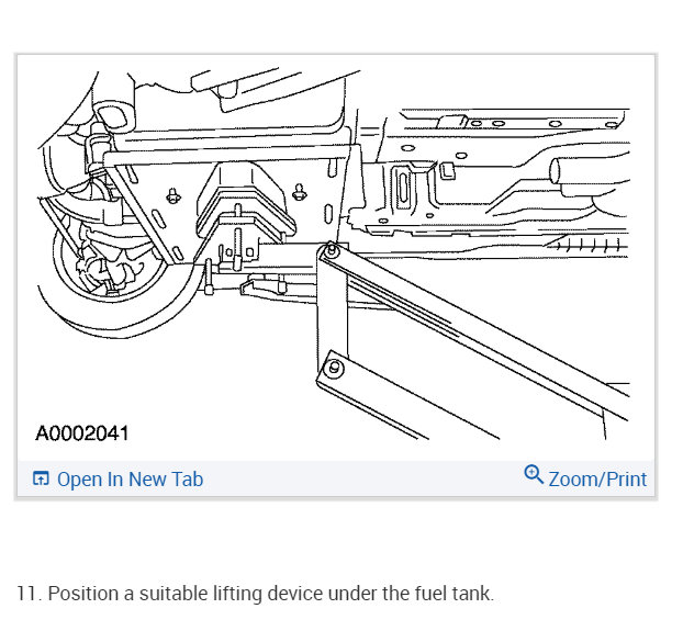

The fuel pump is mounted inside the fuel tank. Access requires removing the tank, and removing the pump from the top of the tank. Here is a guide thelp walk you through the steps with instructions in the diagrams below to show you how on your car.
https://www.2carpros.com/articles/how-to-replace-an-electric-fuel-pump
You will need to siphon the fuel out this video will help.
https://youtu.be/Q5MH2gnyFH0

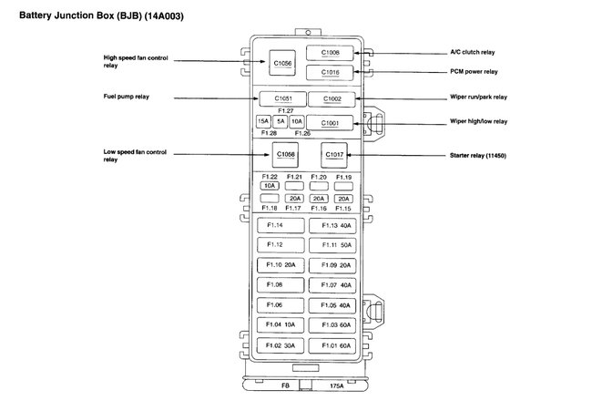

REZIPS
where is the fuse to the fuel pump there is no electric going to to pump
Apr 27, 2020 at 7:17 AM (Merged)
BLUELIGHTNIN6
  • 16,542 POSTS
check fuse # 16 (20 amp) in the engine compartment fuse box. if its OK then check the fuel pump relay which is in fuse location #30 of same fuse box.

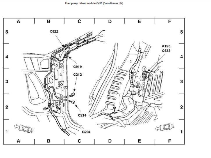

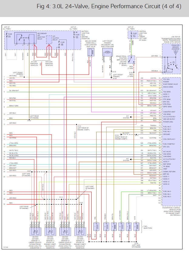

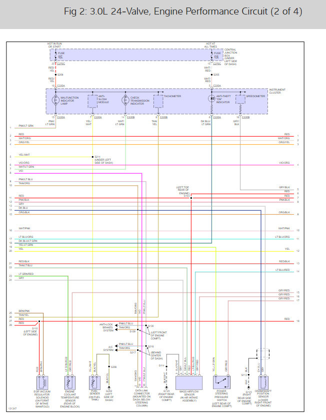

WHOOWNS
Six cylinder two wheel drive automatic.
I replaced fuel pump and fuel pump relay. I Then scanned with the obd II scanner.
The scanner codes indicated the fuel pump driver module has detected a fault in the fuel pump secondary circuit.
The probable causes were faulty fuel pump driver module or open or short in the fuel pump driver circiuit.

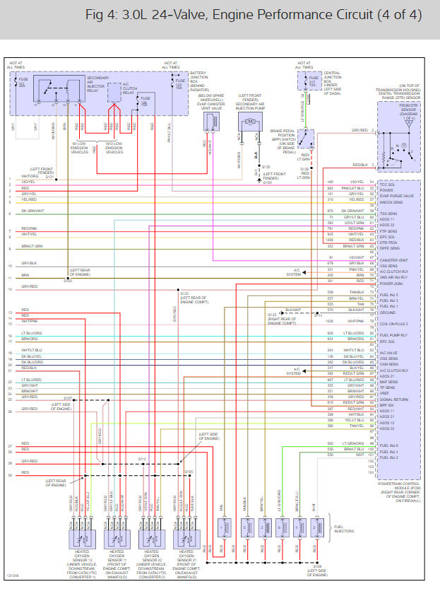

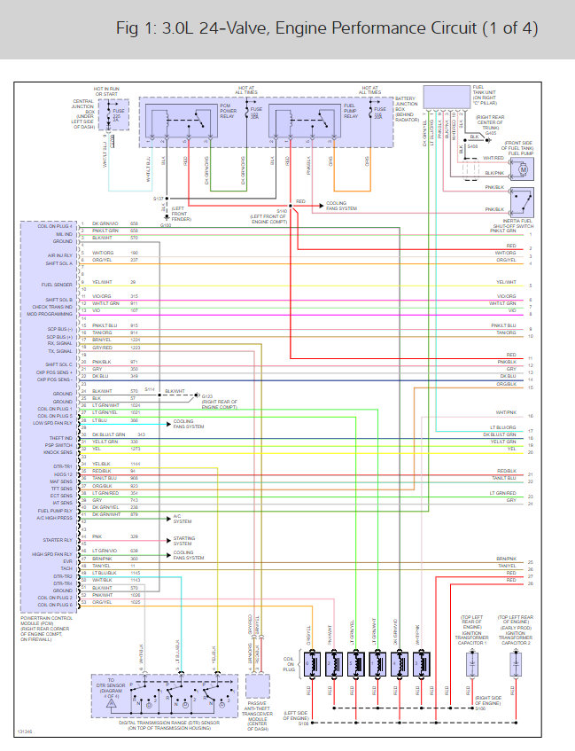

The parts are dealer only. Where are these parts located? Can I repair or must I consult a dealer? What is your opinion? 3.0 4 dual over head cam. please help
Apr 27, 2020 at 7:18 AM (Merged)
MATHIASO
  • 1,209 POSTS

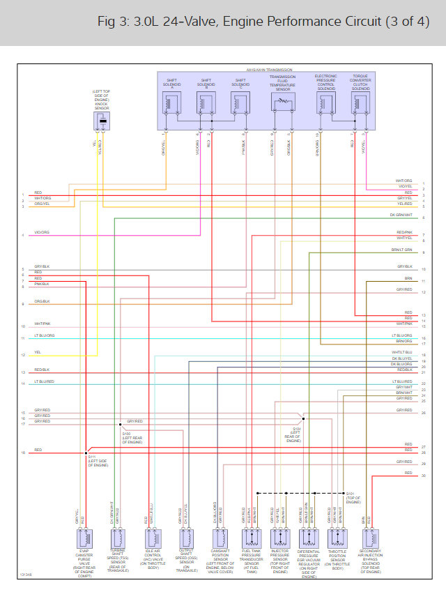

Hello WHOOWNS,
The fuel pump secondary control circuit deals with the fuel pump driver module (another word for computer) which is use to regulate the fuel pump pressure. By using a fuel sensor located in the fuel rail, the engine computer can regulate the fuel pump pressure by monitoring the fuel pump duty cycle. Using this duty cycle range, the computer can determine when to shut off or increase the fuel pressure for optimum engine performance. Therefore, if the duty cycle is below or higher than the targeted range, it will set a code related to the fuel pump secondary control circuit. When this happens, the fuel pump driver module will set at a default usually set at 100 % duty cycle. For basic test, check connections of the wiring/grounds.
Number one, starting changing the relay is good thing, but the question is "do you have power to the relay?" if there is no power, check the fuse number 30, in the battery junction box, under hood.(see diagram).check also relay ground.
If there is power to the relay,
you have three splices and two connections from the relay to the computer, check them.
if they are all good and not disconnected, the problem might be in the PCM.
They are not parts, they are connections used as ground by the computer. you cannot repair them yourself, let the dealer fix those, and probably reprogram the PCM.
Here is the fuel pump wiring diagram to confirm the issue and the fuel pump module location
Cheers
