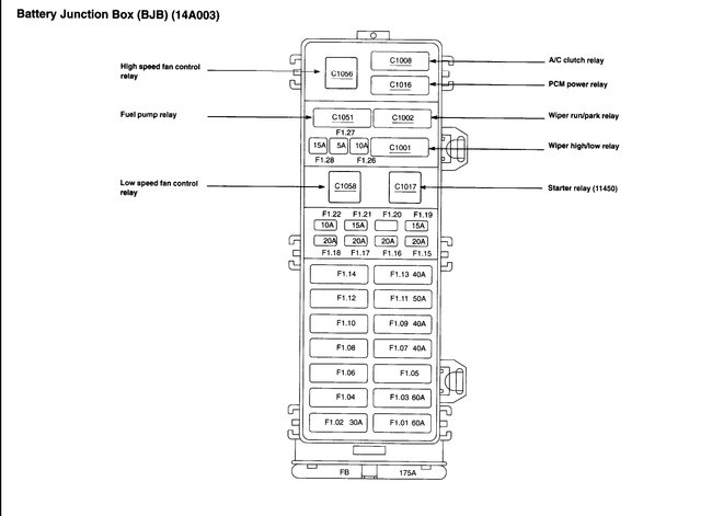

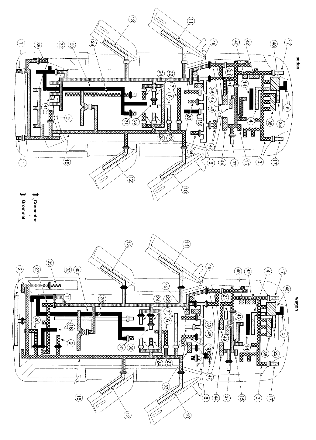

Where is the fuel pump relay? And where is the fuel pump main harness placement/location main run from? it has been a long time since i worked an a fuel problem for a Ford.

Second relay down on the top left of the box. If I remember correctly it is the harness down the passenger side that also feeds the tail lights. Numbers 18 and 9 in the image. Should be run down the rocker channel inside the car under the carpet, the tank harness breaks out under the rear seat. Check out the diagrams (Below). Please let us know if you need anything else to get the problem fixed.

new to the board im in the process of starting a mobil auto repair business in las vegas nv so this might be my new favoite site.. i have a 2001 ford taurus i want to see if anybody knows were the fuel pump relay is located
thanks in advance

Fuel Pump Relay is In battery junction box
Battery Junction Box located Front center of engine compartment, behind radiator
