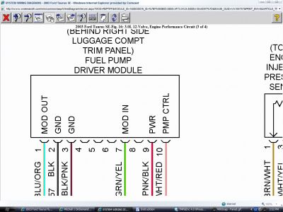

I have a 03 Taurus w/38000 miles. The car overall runs fine but every so often (3 times so far) the car will run rough acting like its starving for fuel. I have resat the fuel shut off in the trunk and the the car runs fine but 2 of the 3 times I have had to let the car cool down and then reset the switch and it starts and runs fine for a week or so then it happens again.
I feel it maybe the fuel pump relay but I am not sure. How can I find out what the problem may be?

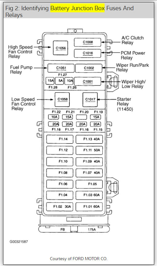

Check fuel pressure. If the pump is failing, the pressure will be lower than it should be. If it is the relay, it will lose pressure entirely when the engine stalls.
The relay is in the diagrams below

Turn the key to on, and listen for the pump, it should run for 2-3 seconds, if not check fuses and relay in the power distribution center under the hood. If they are OK check the connector at the tank and test for power. Is your check engine light on? There will be a code set if it is the fuel pump driver module, or PCM...you will get P1233 or P1234 scan it, even if you have to buy a cheap scanner at Autozone...It's an investment that can be used on all cars sold in the US sinc 1996...post the result, or let me know if the light isn't on, Also make sure the inertia switch is pessed down, it's in the trunk...Fuel pump driver module is behind the right kickpanel, the pink/black wire is pump power, and the whte/red is pump control, test pink black for power while someone turns the key to ON.
https://images.2carpros.com/forum/automotive_pictures/62217_FPDM_1.jpg

QUADRUNNER
  • 7 POSTS
I checked my fuses and they were okay.
I pulled off rear compartment panel and checked the inertia switch and it checked out okay. I then checked the fuel pump control module and here are the results.
Pink (PWR) with blk tracer = 12 volts
blk(gnd) checked okay for continuity to ground.
Blk with Pink tracer (gnd) checked open for continuity to ground.
What sould other wires read? such as the mod in and mod out, as well as the pmp cntl?
Could this pump control module be bad, or is there a way to check to see if it's okay.

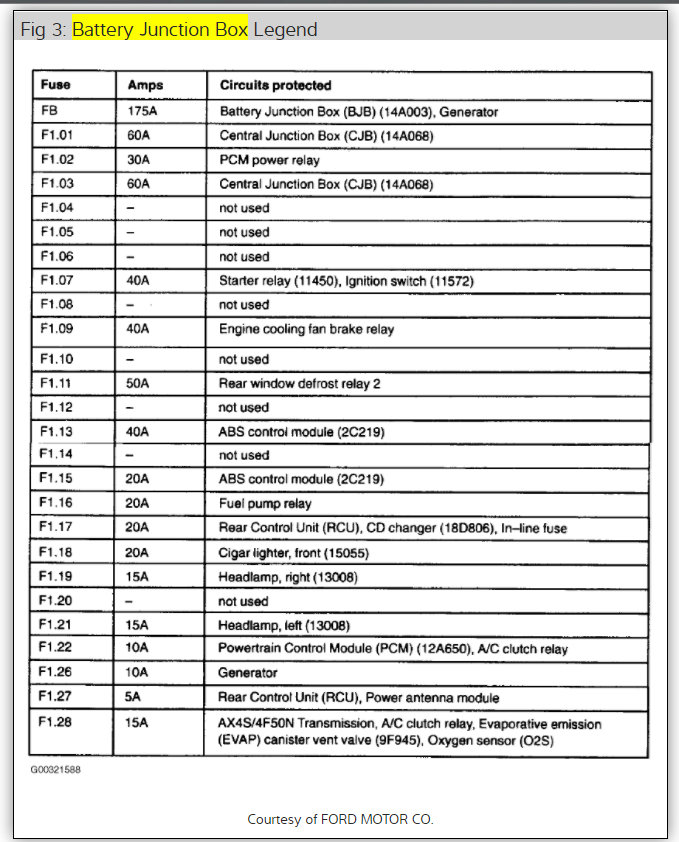

ZACKMAN
  • 4,202 POSTS
Inertia Fuel Shut Off switch will be either in cargo area behind right rear wheel well or on left "B" pillar (depending on model and engine). If tripped, switch has to be manually re-set.
Battery junction box behind radiator
Fuse #116 20A
Fuse #102 30A
Fuel Pump relay
May 20, 2020 at 5:58 AM (Merged)

is there a way for me to find out if my fuel pump relay needs to be replaced without taken it to the local auto shop? my car doesn't want to start. it has a new battery, the starter is good as-well. the car cranks but doesn't turn over. when i place the key in the on position i do not hear the fuel pump turn on. i was told it may just be the relay, and once thats ruled out more than likely it would be my fuel pump
MHPAUTOS
  • 31,937 POSTS
Hi there,
First check the fuel pump fuse in the fuse box and the relay is in the battery junction box under the bonnet next to the battery, if these are ok, i would be suspecting a pump failure.
