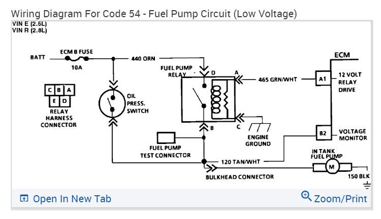

The truck sat gas gummed up. Replaced gas fuel pump fuel filter sending unit and spark plugs. The fuel pump has power going to it but not enough power to send the fuel to start. No breaks in wires.

How much voltage is reaching the fuel pump? It should be 12v or battery voltage.
Also, have you checked to make sure the throttle body injectors are not plugged? If you haven't, you may want to consider disconnecting the fuel line between the pump and throttle body and blow compressed air through it. It could be gummed up internally or even the fuel injectors could be plugged.

Have power going to the sending unit but no power to fuel pump?

If you have power to the sending unit, the pump should have it as well. When you checked for power, was the connector disconnected and you used a separate grounding location?
If you did, you may not have a ground. If you look at the connector at the sending unit, first make sure the connector pins are not damaged. Also, there should be a black wire for ground. Confirm there is continuity to ground from that wire. Keep in mind, if you use a test lamp or multimeter, you may find ground. If the connection is weak or corroded, the load of the motor could cause it to fail.
Let me know what you find.
See pic below.

Believe it or not it was just a fuse in the truck that a friend put in. Did all that extra troubleshooting for nothing. Have another question! Can a carburetor be cleaned without removing it or starting it?
