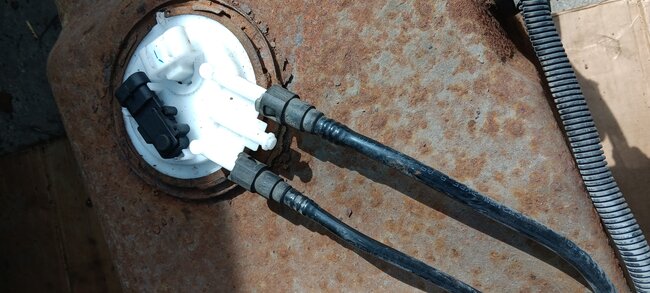

Fuel pump is not getting power?
TYMONEY
  • 22 POSTS
The new connector works and fits it.
I believe it's wire wrong like you said.
Wednesday, March 27th, 2024 AT 6:31 PM
  • 109,885 POSTS
Do you get battery voltage at the orange wire? (I believe you said it is connected to the gray wire.)
Also, is there continuity to ground via the black wire?
+1
Wednesday, March 27th, 2024 AT 6:45 PM
TYMONEY
  • 22 POSTS
Yes, the orange wire set to be grey wire would be the 87 on the relay. All power is there even the 85 cones on for 2 seconds and stops.
+1
Wednesday, March 27th, 2024 AT 6:49 PM
TYMONEY
  • 22 POSTS
Joe, what do you think I should do disconnect the fuel pump wires and only plug in the 3 wires instead of 4.

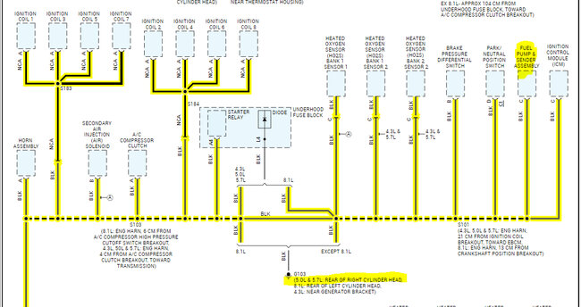

Then man does it show and ground connections to the frame for the fuel pump?
Thursday, March 28th, 2024 AT 1:07 PM

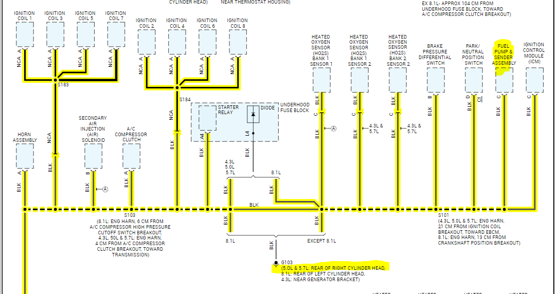

  • 109,885 POSTS
The ground for the fuel pump is G103. It is located at the rear of the right cylinder head. That would (should) be the passenger side. I attached the schematic below.
See pic below.
Thursday, March 28th, 2024 AT 8:02 PM
TYMONEY
  • 22 POSTS
Key off on negative 30 is on ground nothing on the others off. Key off. On positive 30 is off 87 on 86 is on 85 off. Turn key 30 is off 87 on 86 on 85 2 seconds then off.
