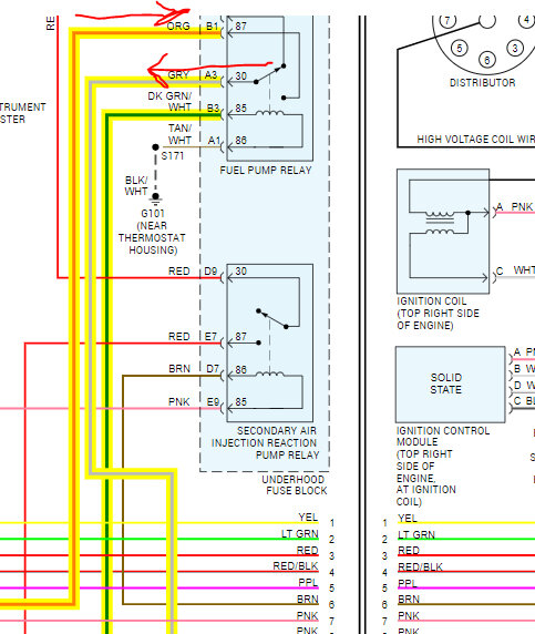

I traced out the wiring for you below.
Here is what I need you to do first. Check the ECM B fuse in the under-hood fuse box. In addition to checking the fuse, make sure there is power to and from it.
If that is good, remove the fuel pump relay. On the relay itself, you will see a number identifying each pin. Locate pin 30 and pin 87. Then, take a jumper wire and jump the two pins I mentioned. By doing this, you will be sending power directly to the fuel pump. This is a test to see if the pump itself may be an issue.
Do these two tests and let me know what you find.

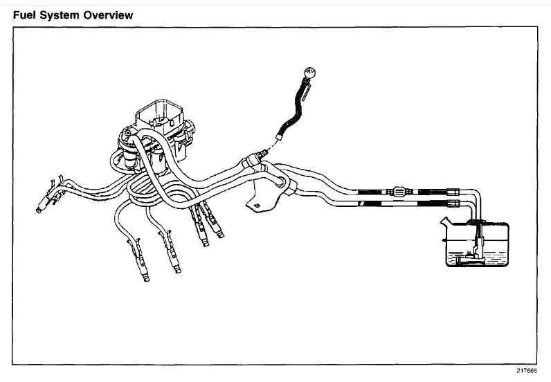

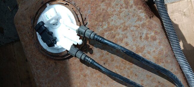

But is it possible for you to get me a diagram to the fuel pump gas lines to be sure they are all going in the right direction?
Mar 11, 2024 at 4:11 PM
TYMONEY
  • 22 POSTS
Joe, man, hope everything is wonderful on your side.
  • 110,194 POSTS
The only pic I have is attached below (very generic). Let me know if it helps, and by the way, I'm glad to hear you got it fixed. Good job.
See pic below.

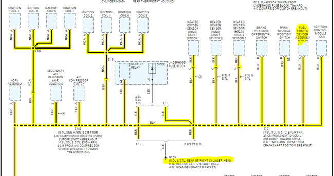

30 has power 87 has power 86 has power for 2 seconds then stops with key on . Any ideas?

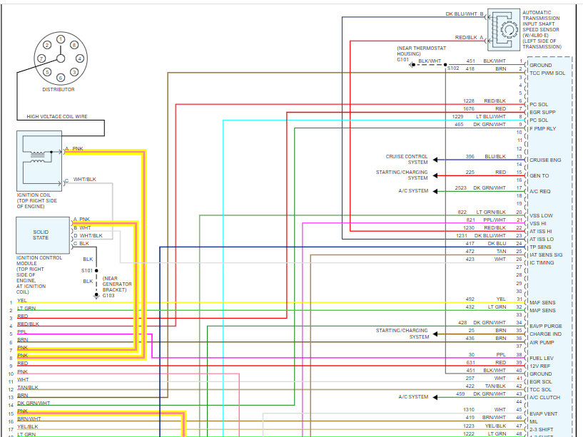

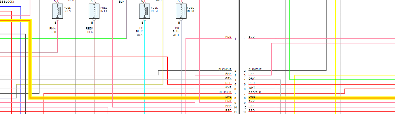

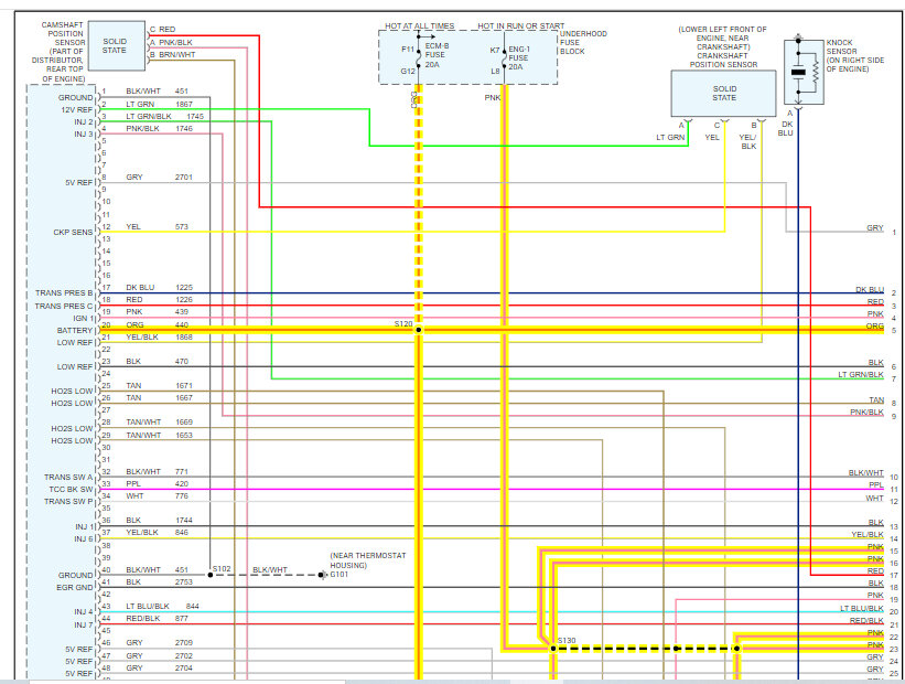

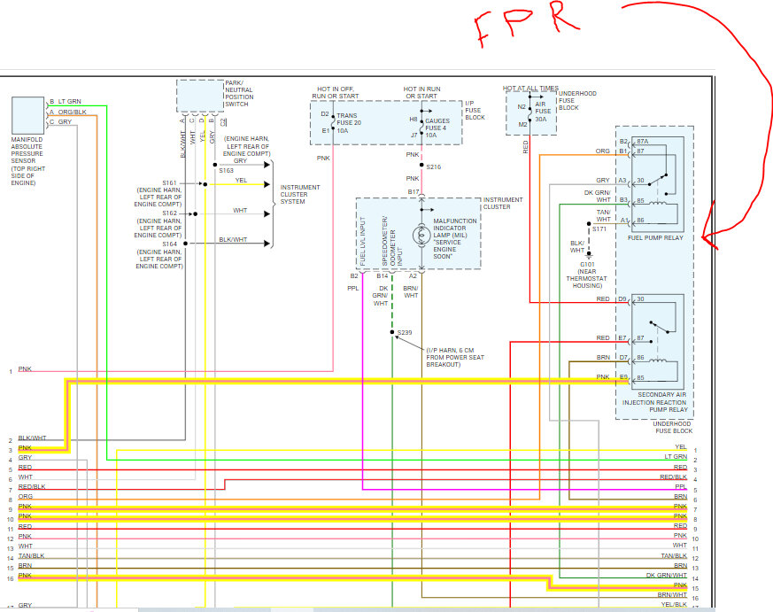

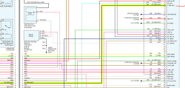

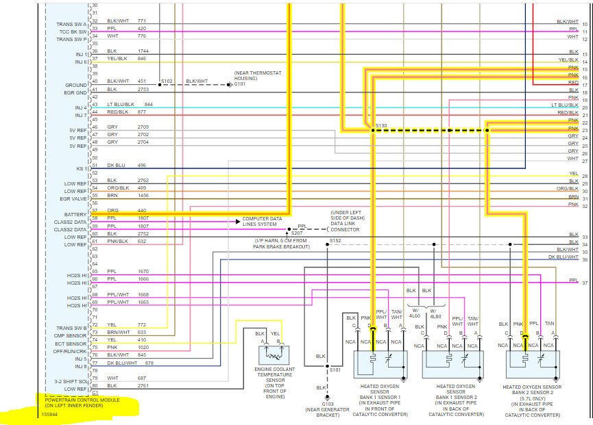

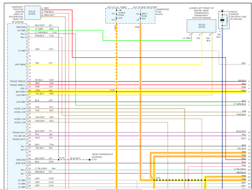

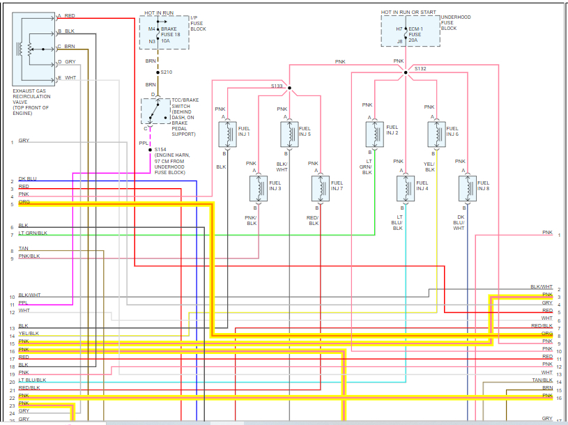

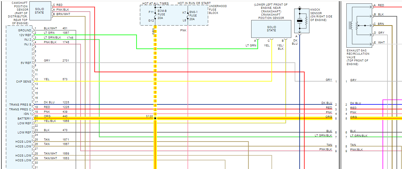

Yes, switched relays it's just turning over fuse blew when jumping it ECM b fuse and ECM 1 fuse when starting it I think I'm going to look under the PCM and ECM is there a diagram for wiring.
Mar 26, 2024 at 6:52 PM

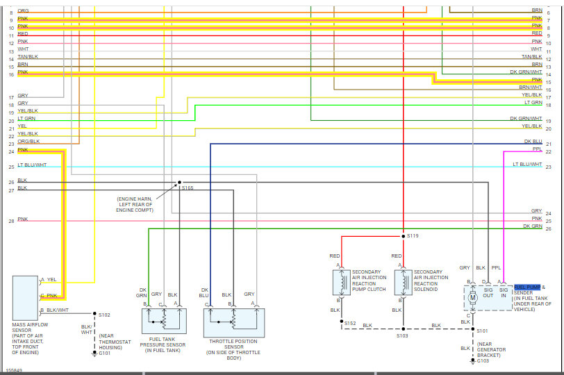

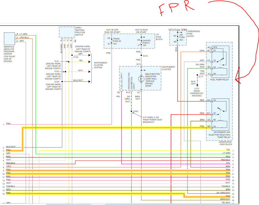

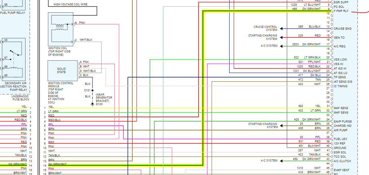

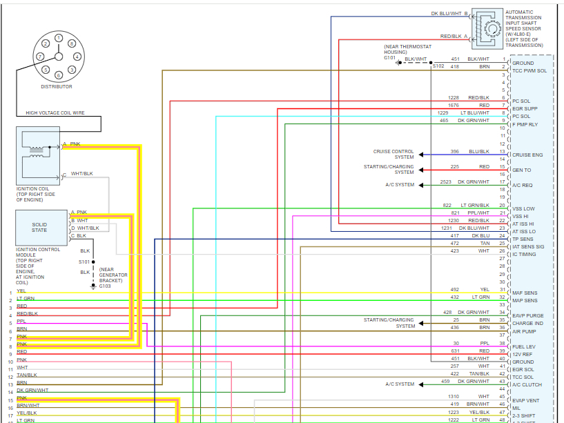

  • 110,194 POSTS

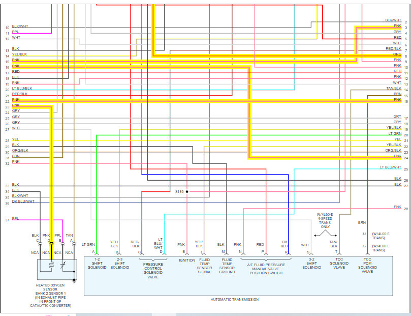

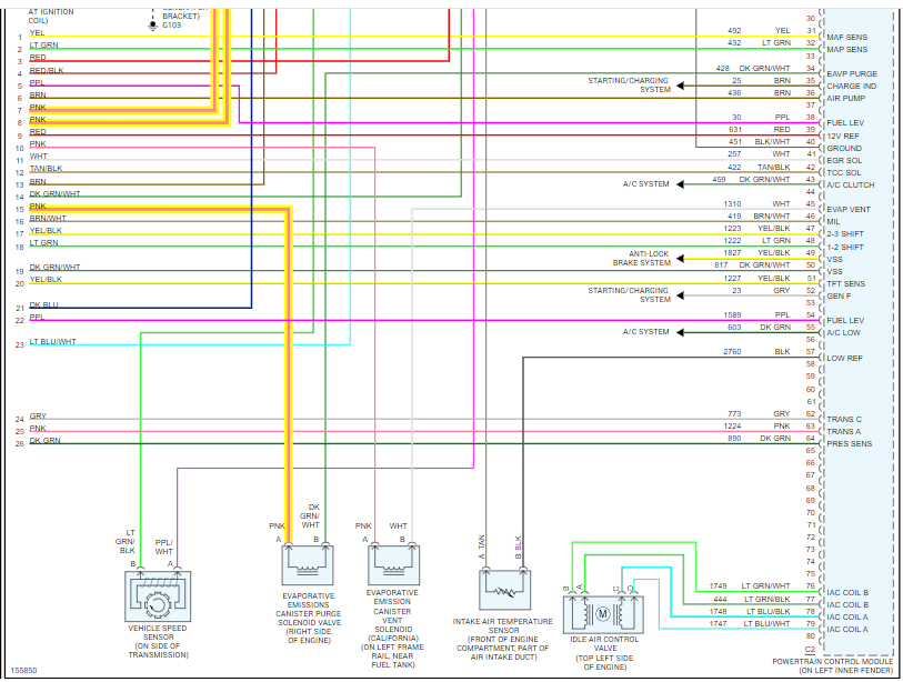

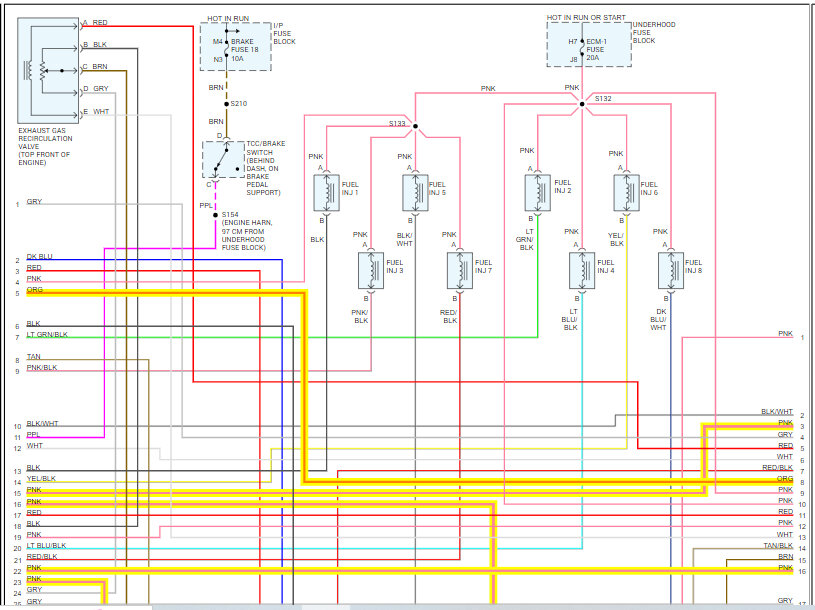

The wiring schematic that includes the PCM is tied into the powertrain management circuit and is four pages long.
I attached the entire schematic below. However, to make it readable, I had to cut each page in half. I did overlap them so you can follow from one to the next. Additionally, I highlighted the wiring related to the two fuses that failed and indicated the location of the fuel pump relay.
The PCM is located on pages one and four in the manual. Therefore, they are pics 1 and 2 below and pics 7 and 8 because I cut the pages in half.
Let me know if this helps.

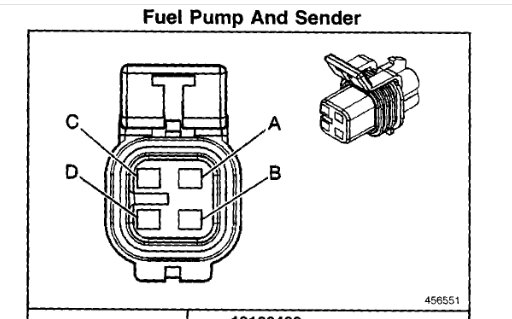

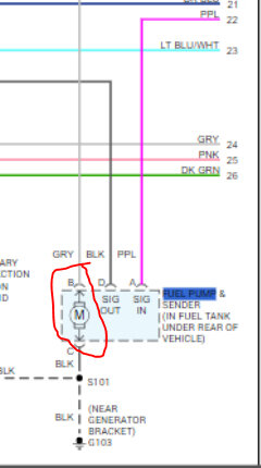

One more diagram the fuel pump wiring harness I think the wiring may be connected improperly. I see an orange wire on it. I'm not sure that it goes to the fuel pump. I'd need a diagram to be sure.
Mar 26, 2024 at 9:04 PM

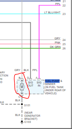

  • 110,194 POSTS
At the pump, there should be three wires, black, gray, and purple. Where are you seeing an orange wire? Can you tell where it is coming from?
See pic below.

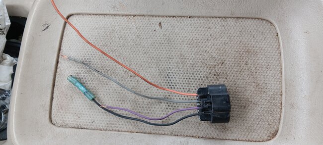

The fuel pump connector piece goes to 4 wires the orange wire from the connector went to the grey wire, I think. I'll get a picture or the connector tomorrow.
Mar 26, 2024 at 11:51 PM
TYMONEY
  • 22 POSTS
Hey Joe good afternoon. This was the fuel pump connector piece that was on there I replaced it the same way and I think that's the issue.
Mar 27, 2024 at 10:09 AM
  • 110,194 POSTS
That isn't even the right connector. It should be square, so someone was certainly into it. Is the connector in the fuel pump itself work with this connector?
You indicated the orange wire was tied into the gray. Here is my dilemma. I'm not sure what the person did or set things up. I have factory information, but this isn't a factory connector. I attached a pic below of the connector.
See pic below.

It's the same one that came with the fuel pump maybe a color or 2 different it has connectors. here's a picture.
Mar 27, 2024 at 6:26 PM
TYMONEY
  • 22 POSTS
The new connector works and fits it.
I believe it's wire wrong like you said.

Yes, the orange wire set to be grey wire would be the 87 on the relay. All power is there even the 85 cones on for 2 seconds and stops.

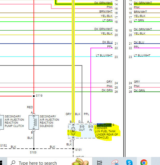

Then man does it show and ground connections to the frame for the fuel pump?
Mar 28, 2024 at 1:07 PM
  • 110,194 POSTS
The ground for the fuel pump is G103. It is located at the rear of the right cylinder head. That would (should) be the passenger side. I attached the schematic below.
See pic below.
Mar 28, 2024 at 8:02 PM
TYMONEY
  • 22 POSTS
Key off on negative 30 is on ground nothing on the others off.. key off.... on positive 30 is off 87 on 86 is on 85 off. Turn key 30 is off 87 on 86 on 85 2 seconds then off.

Hi Joe, happy Friday, that's where I'm at the connector is right with grey to grey, purple to purple black to black with stripe to the same every is connected right. I'm going to open the PCM to see if it's going to be what it's supposed to be.
Mar 29, 2024 at 1:18 PM
TYMONEY
  • 22 POSTS
The first paragraph is the power from the fuel pump relay. As of right now, is the right let me know please.
Mar 29, 2024 at 1:19 PM
  • 110,194 POSTS
The power from the relay should be the gray wire. As far as what you are finding, it does sound correct.
