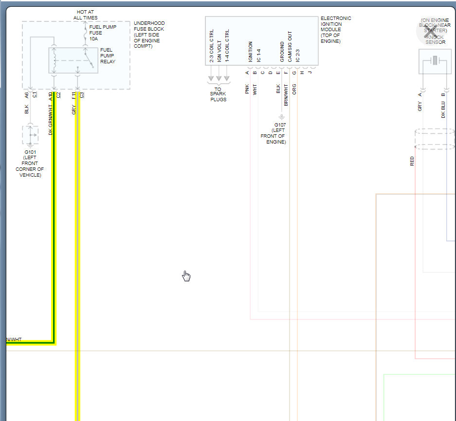

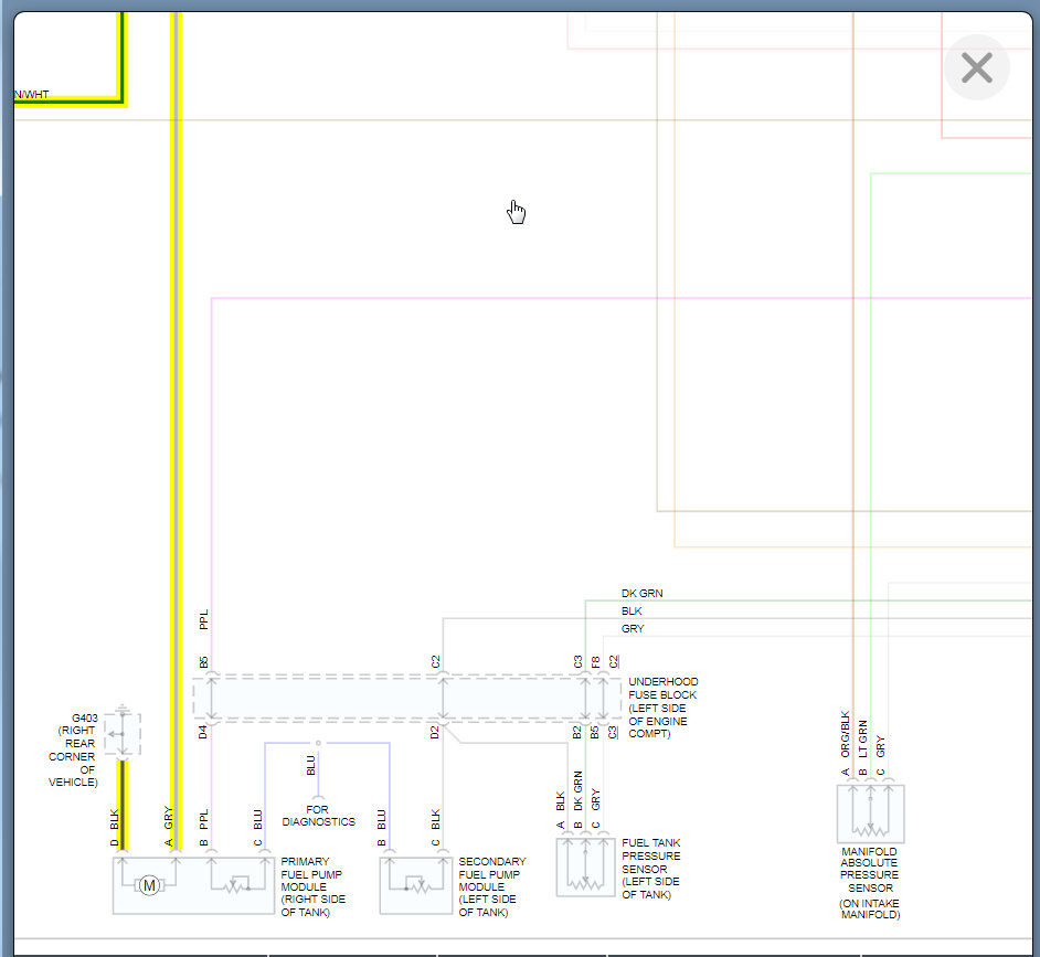

If this is not a fuel pump issue as you have replaced it (even though that is what is sounds like) we need to see if the fuel pump is getting the proper voltage in order to turn the pump on. So let's go to the relay and check voltage coming out on the two wires highlighted. The green/white wire is coming from the ECM and should have 12 volts on it when the key is turned to the on position. Then the gray wire should have 12 volts on it as well which shows the relay is closing and sending the 12 volts to the pump.
Here is a guide that will help with testing relays:
If the pump is getting the proper 12 volts when it should then the pump is the issue. I assume this is the same issue before the pump was replaced?
Let me know what questions you have. Thanks

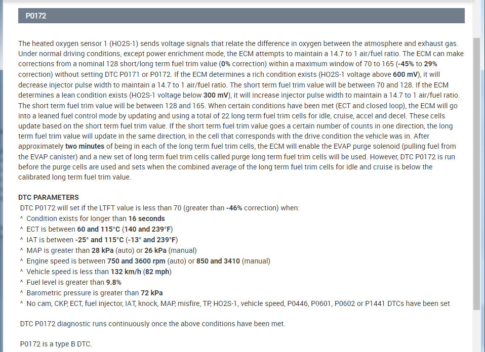

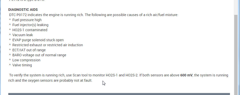

i just found code p0172 in the freeze data after the last start attempt followed by stalling. it's not registered in codes but shows in freeze data for that start up. fuel injectors? You are right it sounds like pump to me but with just replacing the pump regulator and filter and then that code makes me think it could be injectors.
Mar 18, 2021 at 12:09 PM
Yep. That makes sense. You have an injector leaking which is why the pressure is dropping.
If you could get the engine started and keep it running it would be worth trying to clean them but if I were you, I would just change them at this point.
Below is the info on this code if you need it.
