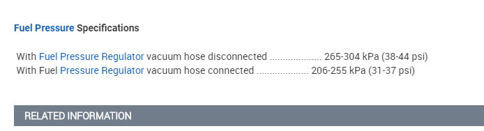

Need to know the fuel pressure with/without the fuel pressure regulator.

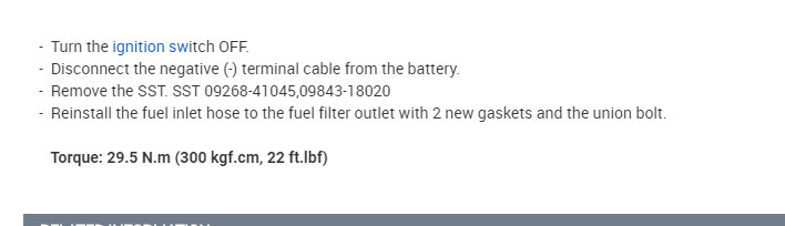

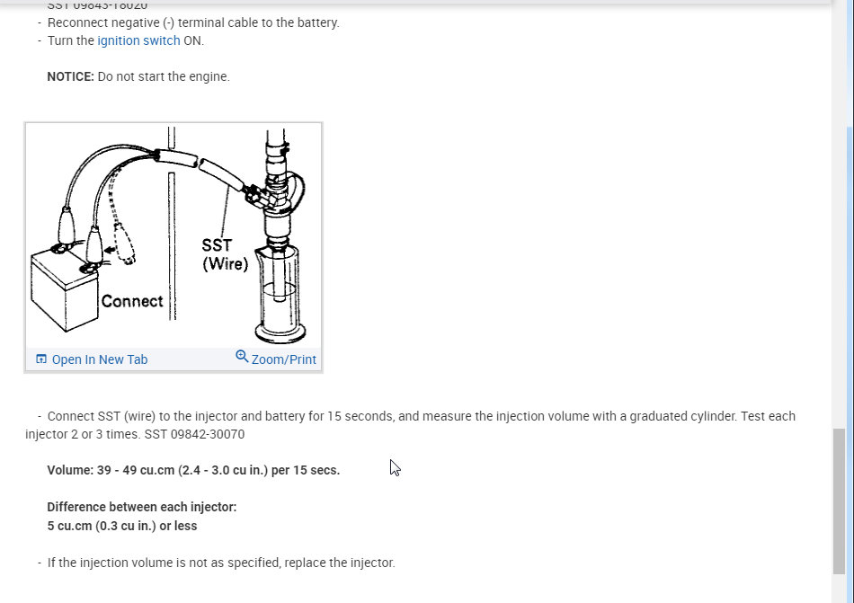

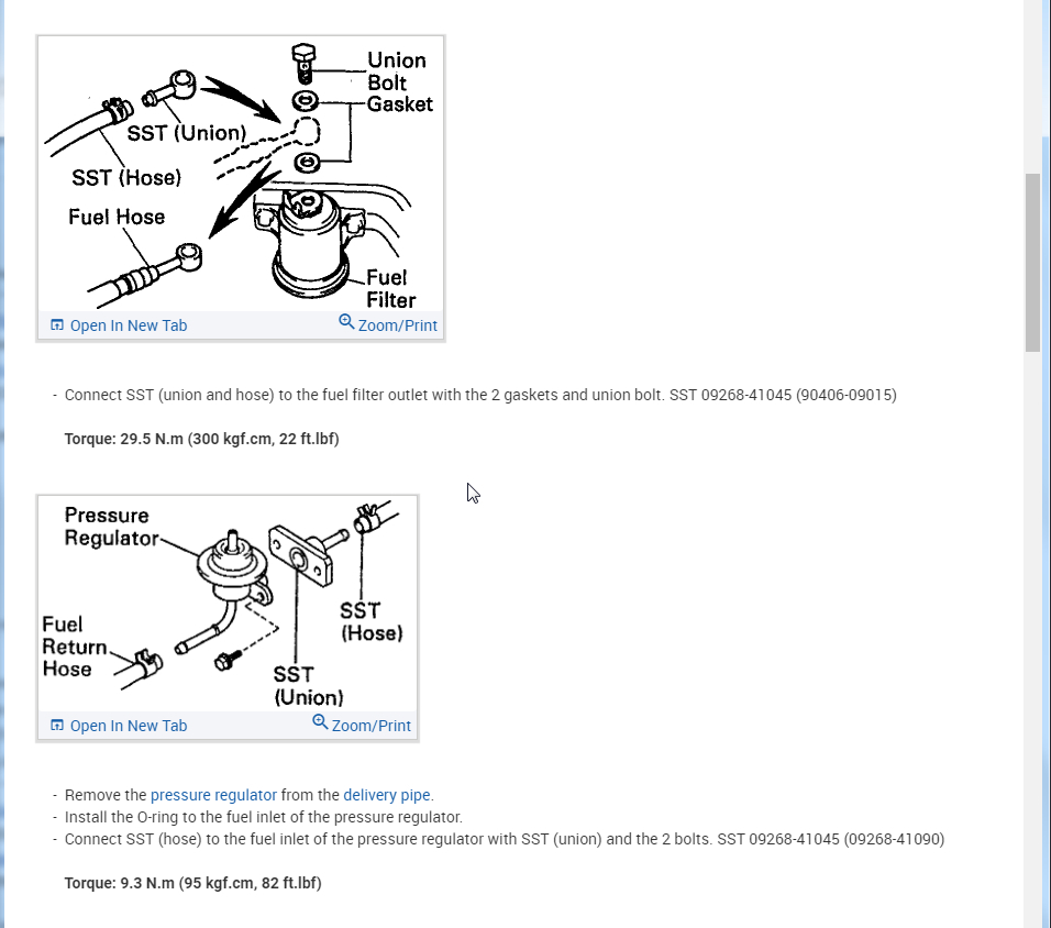

I attached the spec as you requested. Let us know if you need more info. Thanks

Fuel pressure is 36 psi with the PRG however it will start every time you spray fuel in TB- is like it's not getting spark, but it does. what's with this? replace crank sensor/igniter and still happening all the time.

Just to clarify, it doesn't start unless you spray starter fluid? If that is the case you have a fuel issue not a spark issue.
I suspect you have an issue with the regulator. Basically you have pressure to the rail but it is not being delivered to the injectors because the regulator is sticking allowing too much fuel to return to the tank.

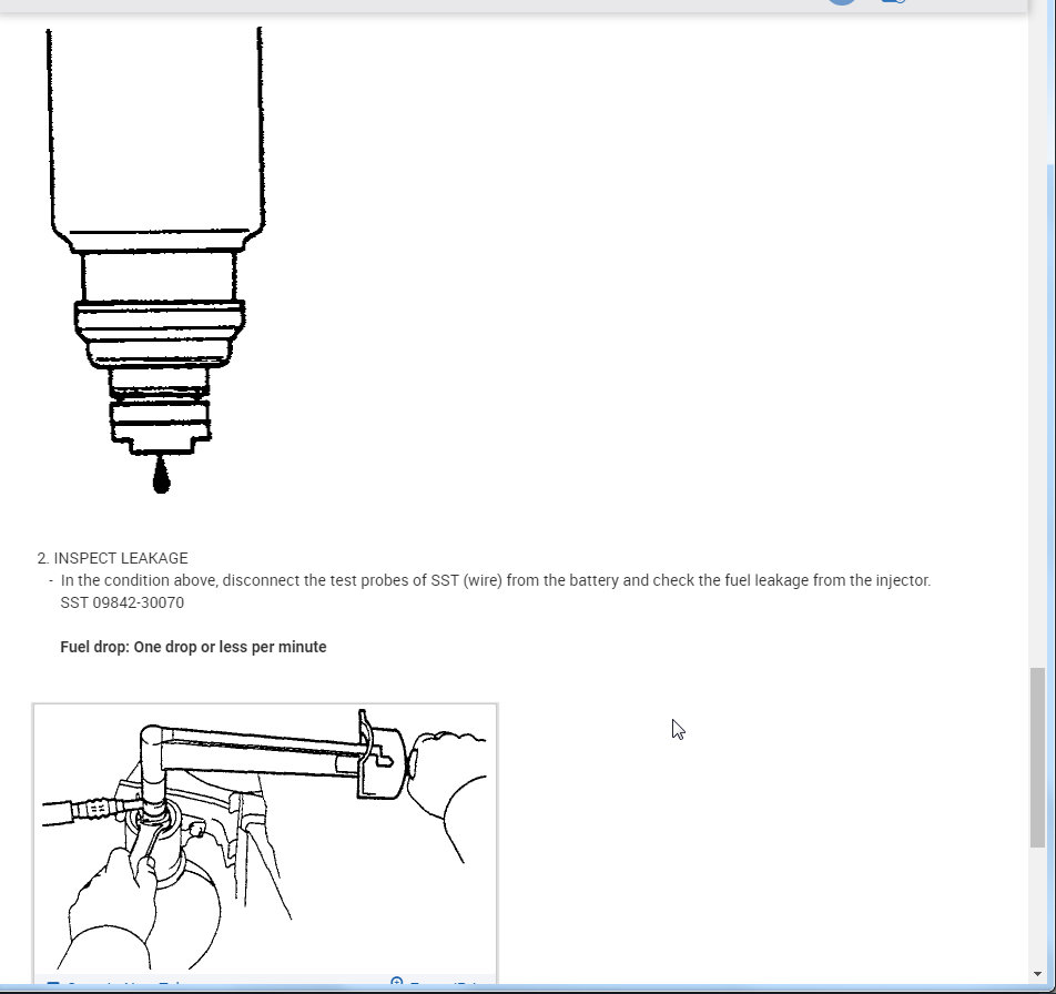

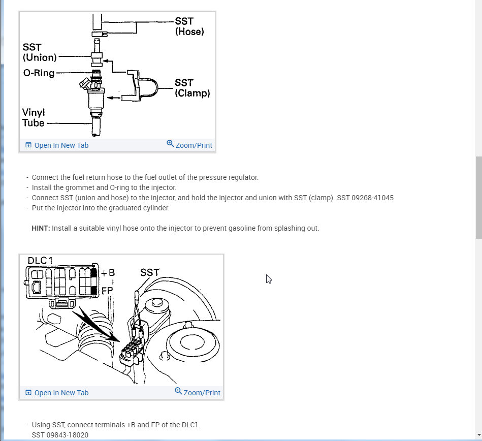

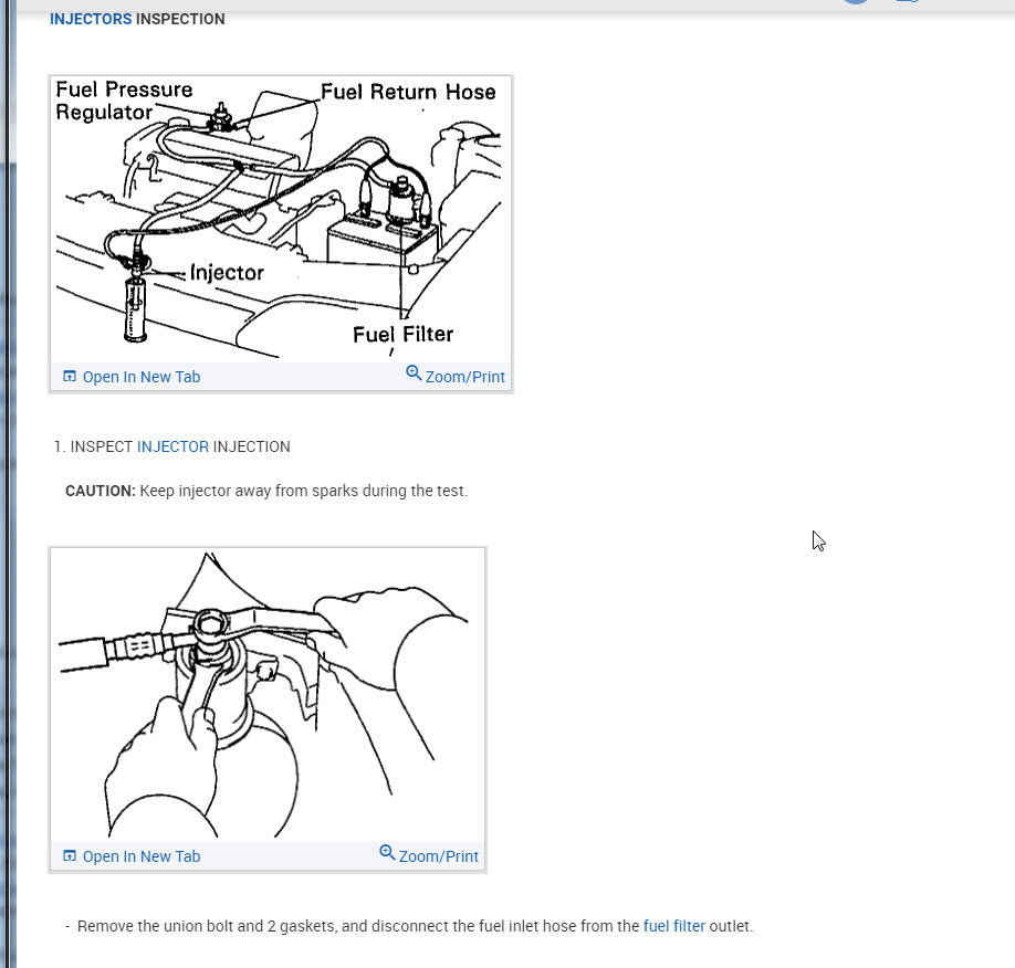

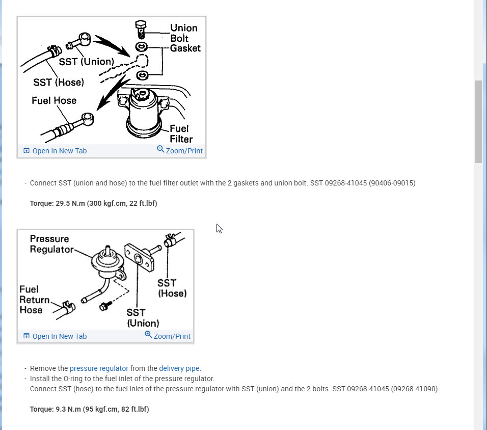

I attached the testing that you need to find this out. Let us know what you find. Thanks

Testing FPR without vacuum 44 psi w/vacuum 38 psi seems doing okay.

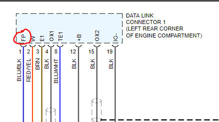

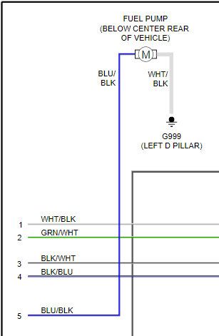

Do you know the wiring colors for the fuel pump and fuel sending unit?
Mar 2, 2021 at 1:38 AM
DANNY L
  • 5,648 POSTS
Hello, I'm Danny.
Just here to add my 2 cents.The sending unit is built into the in-tank fuel pump.Here is the wire colors for the fuel pump circuit. I've attached 2 pictures below.Hope this helps and thanks for using 2CarPros.
