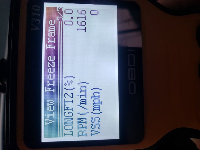

Tried to upload videos, but wont let me. Put on new pcv valve. Runs some better. Starts idling real high. After a few minutes dropped down to 1300s and then went to 1500s after another 5 minutes and stayed there till I shut it down 20 minutes later. Has flashed me 1 code. The idle still doesn't sit at a smooth spot, moves up and down in various increments. Have hard would it be to hook up a dash tach?

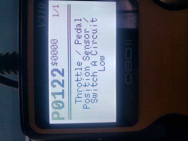

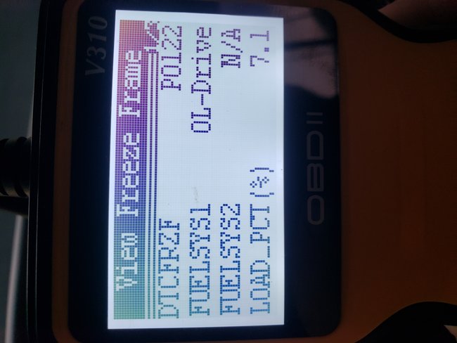

Now getting 2 codes p1120 manufacturer control and p0122 throttle circuit low.

Roy, any of these readings, useful?Rpm's drop to 900's after about 15 minutes and acted like it wanted to shut off.
Friday, May 29th, 2020 AT 3:16 AM
  • 52,797 POSTS
The signal is the issue.
It should be.5 at idle. This is with the connector connected to the TPS and you back probing the connector.
As you accelerate, the voltage should rise to a max of 4.8 volts.
Friday, May 29th, 2020 AT 4:11 AM
