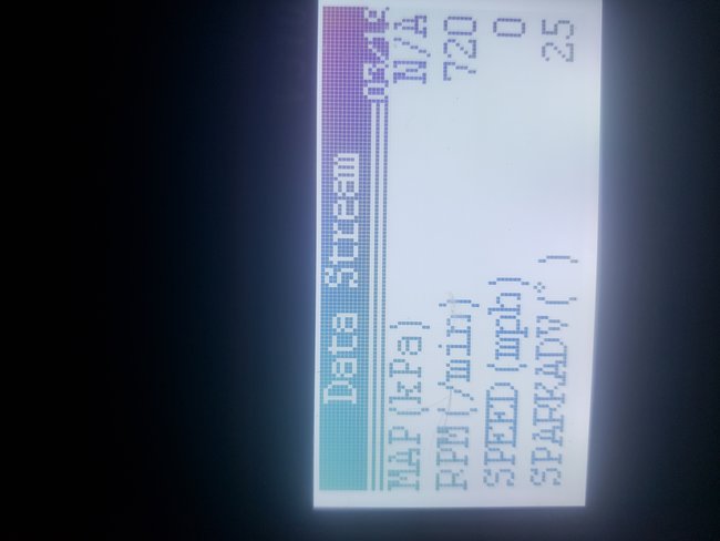

In the 1,500's for awhile, but sometimes after it runs awhile it will drop in the 900's and act like it's trying to shut off.

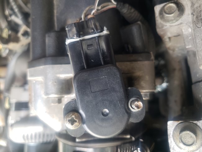

Jun 2, 2020 at 10:16 AM
Can you back off the base idle screw until the idle drops down? It sounds like the throttle plat is open too much which is raising the voltage and when the voltage is high, the ECM is changing the fuel mapping.
Jun 2, 2020 at 10:19 AM
Will see.
Jun 2, 2020 at 10:22 AM
Rpm bobbing back and forth between 900 -1200. voltage now is 1.06. 4.54-4.74.

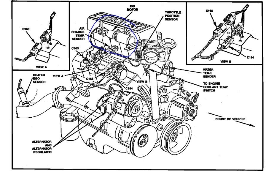

Jun 2, 2020 at 10:34 AM
Is that with the IAC connected or disconnected?
Jun 2, 2020 at 10:36 AM
Connected.
Jun 2, 2020 at 10:38 AM
What happens when it is disconnected? The idle should drop to 500-600 RPM.

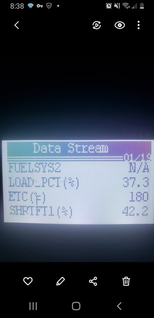

Rough idle. Started off between 266-472. after about a minute going between 474-587. trying to shut off.

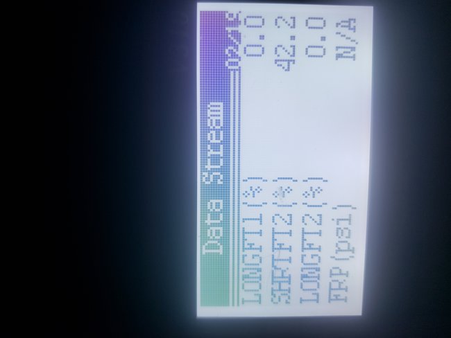

Jun 2, 2020 at 10:53 AM
Can you give me the long term trim readings while it is idling like that?
Jun 2, 2020 at 11:04 AM
How is it listed on a cheap obd2?
Jun 2, 2020 at 11:09 AM
Long term trim bank 1 and bank 2. It could be in percentage or it could be in voltage.
It will tell me if the engine is rich or lean.

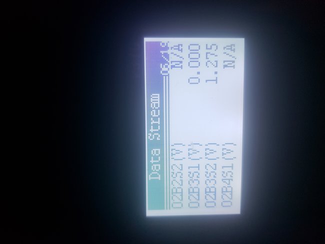

Jun 2, 2020 at 11:27 AM

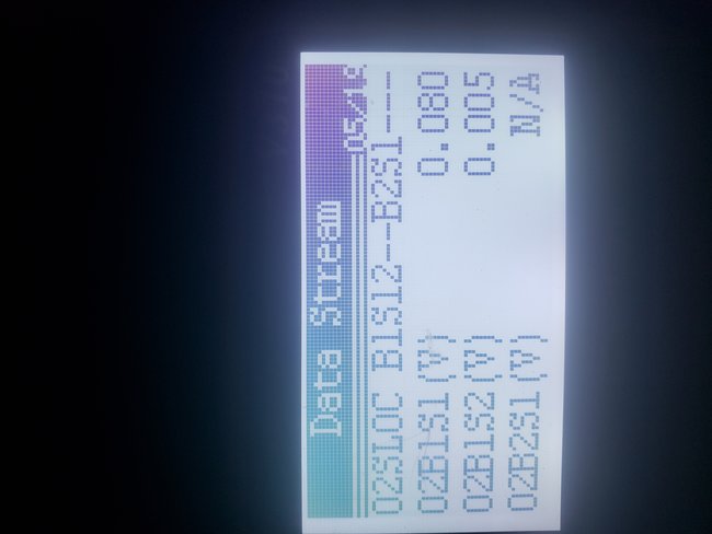

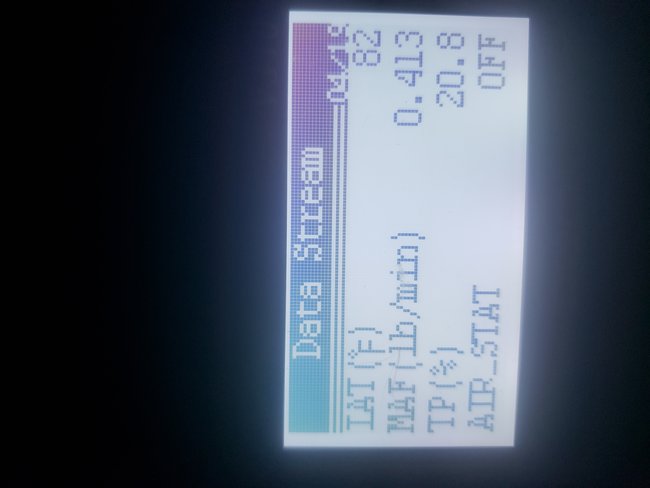

Nuts. It does not give the trims and the mass air flow sensor readings.
The O2 sensor readings are full lean.
That tells me there is a lack of fuel.

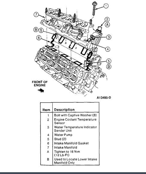

Jun 2, 2020 at 11:15 PM
Feel vacuum from PCV valve, but not the hole it slides into..and a very light suction at the oil cap spout..
Jun 3, 2020 at 10:20 AM

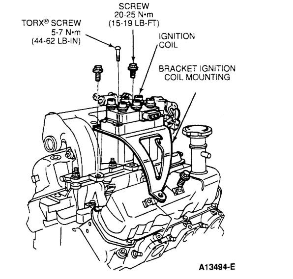

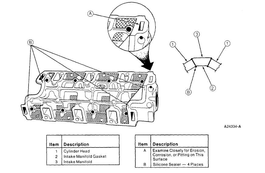

That tells me the intake manifold gasket is leaking and drawing from the valley.
That would also explain why it is running rough.
There should be positive pressure from the oil fill cap, not vacuum.
REMOVAL
NOTE: The intake manifold is a four-piece assembly consisting of the upper intake manifold, the throttle body, the fuel injection supply manifold and the lower intake manifold.
WARNING: Residual pressure remains in fuel system after engine is shut off. This could result in injury or fire when fuel lines are disconnected. Disconnect inertia fuel shutoff switch and crank engine until fuel in lines is used up.
1. Disconnect the battery ground cable at the battery.
2. Remove the air cleaner outlet tube from the throttle body.
3. Remove the accelerator control splash shield and disconnect the throttle cable and bracket assembly.
4. Disconnect all vacuum hoses from the fittings on the upper intake manifold.
5. Disconnect the electrical connections at the throttle body, upper intake manifold, lower intake manifold and fuel injector nozzle tip.
6. Disconnect the fuel supply and return lines at the fuel supply manifold.
7. Remove the bolts securing the ignition coil and bracket assembly to the upper intake manifold.
8. Remove the six nuts securing the upper intake manifold and remove the upper manifold.
9. Remove the valve covers.
10. Remove the intake manifold attaching bolts. Tap the intake manifold lightly with a plastic mallet to break the gasket seal, and lift off the intake manifold assembly.
11. Remove all old gasket material, and sealing compound.
