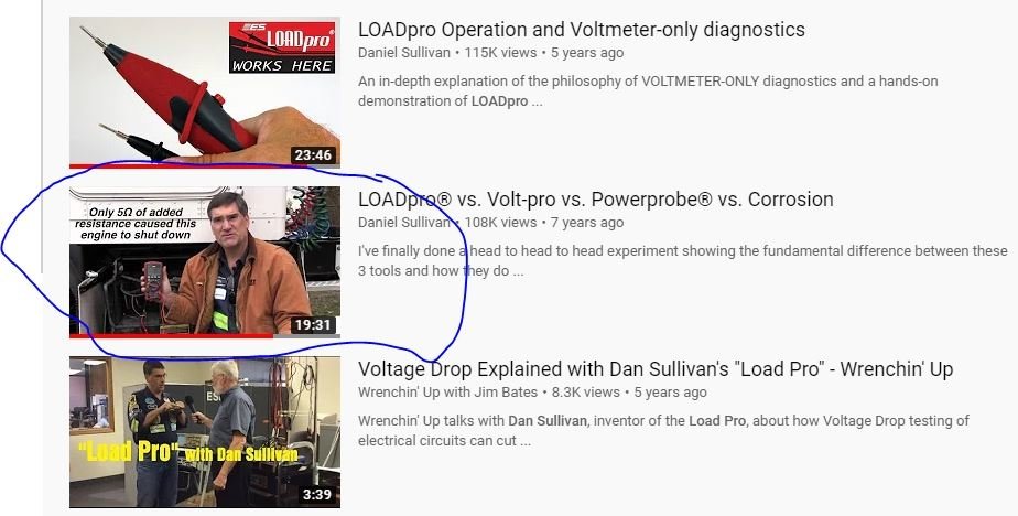

Do you have a load pro leads for your voltmeter?

In order to do the proper testing, you need something that can detect a short or open circuit.
Go to Amazon and type in load pro by Dan Sullivan. The leads should be about $35.00. You can use them on your meter. Then we can do some load testing of the wiring.

Found this one for $48.00. That is still too much. Check back every day. I just bought a set for myself as mine wore out after 10 years.

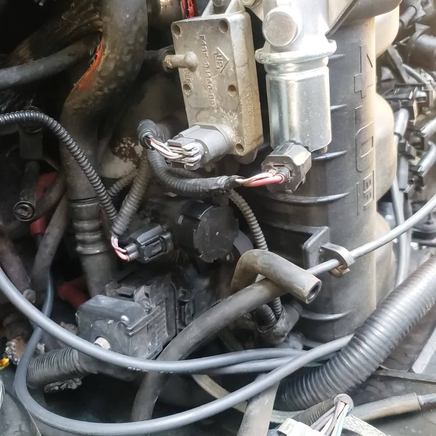

Hey Roy, found out Advance Auto gave me the wrong ECM. swapped it out with the one that Cardone says goes with my VIN number and I also got a better brand MAF sensor and put on it.. it will start up good and runs for a while but it lopes and acts like it wants to shut off still.. took it down the road about a mile or so hit 80 mph easily, but still lopes when I parked it. so, now where does that leave me?

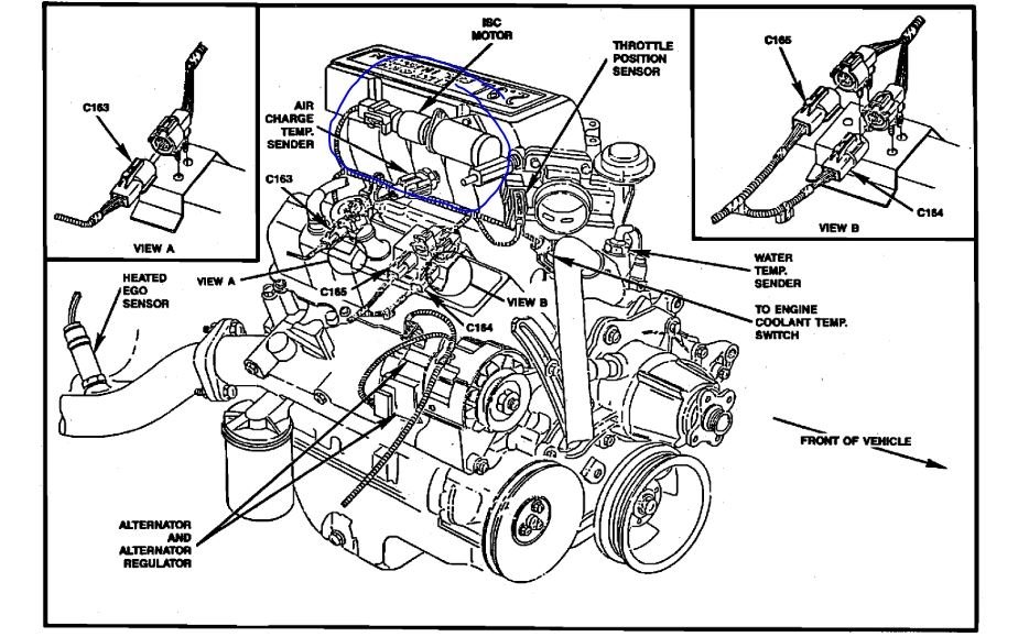

With the wires detached the engine should run at 500 rpm.
May 24, 2020 at 10:17 AM
Would be nice if it was built with a tachometer.
May 24, 2020 at 10:43 AM
Got it.
It should idle with the IAC disconnected. It will be a low idle but still idle on its own.
Then when you plug the IAC back in, the idle should come up.

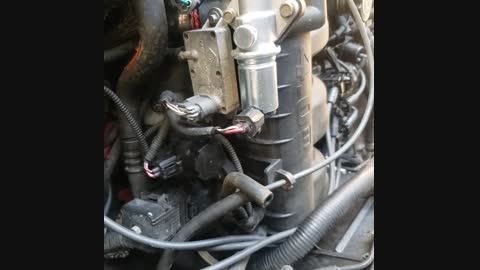

May 24, 2020 at 10:46 PM
Unplugged the IAC and it shuts off.
May 24, 2020 at 11:21 PM

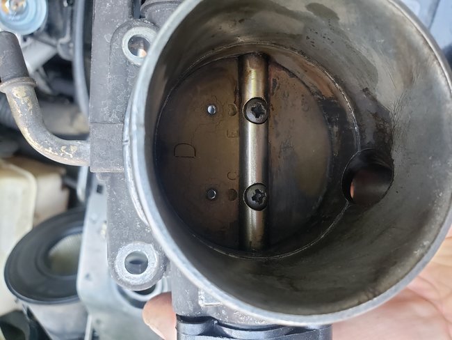

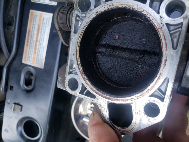

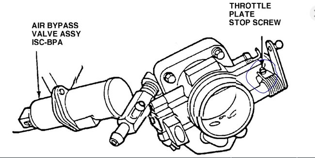

Okay, clean the throttle body real well.
Then adjust the base idle so it will idle on its own. There should be a base adjustment screw on the throttle body.
1. Disconnect idle speed control-air bypass solenoid.
2. With transmission in Neutral or Park, run engine at 2500 rpm/30 seconds.
3. Place automatic transmission in Park, manual transmission in Neutral.
4. Check/adjust idle rpm:
Turn the throttle plate stop screw to 725 rpm
5. Shut engine off and repeat Steps 2, 3 and 4.
6. Shut engine off and disconnect battery for a minimum of 5 minutes.
7. Engine off reconnect idle speed control-air bypass solenoid, verify the throttle is not stuck in the bore and linkage not preventing throttle from closing.
8. Start engine and stabilize for 2 minutes then goose engine and let it return to idle, lightly depress and release the accelerator. Let engine idle, if problem exists, refer to computer engine controls/diagnostic routines for other possible causes.
May 24, 2020 at 11:29 PM
Tried this on both the old one and the new one..and both times it shuts off.
You need to adjust the base idle as I posted.
May 24, 2020 at 11:30 PM
That stuff does not do squat.
Go to the parts store and get a can of 2+2 carburetor cleaner and a small brush.
That stuff works great.

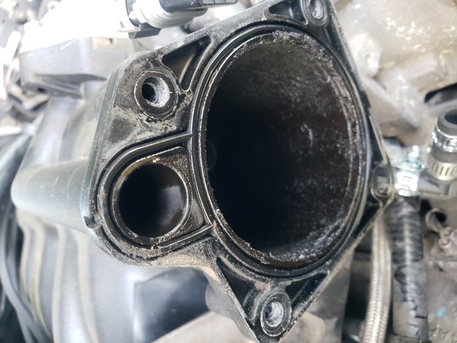

May 24, 2020 at 11:54 PM
Was originally thinking,remove sensor and soak in gas and use toothbrush..
May 25, 2020 at 12:07 AM
Carburetor cleaner would better but give it a try. Carburetor cleaner is more aggressive and melts away all that carbon.

Tried what you wanted me to. idles too erratic; goes from 1,600 down to 700 and back up and down. wont even out.
May 25, 2020 at 5:27 AM
Check for any vacuum leaks. Check the PCV valve. Block it off with your finger and see if it idles steady.

Don't see a PCV valve on a v6 4.0. have a vacuum line going to air boot, but no valve on it.
May 25, 2020 at 6:56 AM
Yes, it has one.
I posted the test for it below.

Ordered a PCV valve. pick it up after work, but even with it off and vacuum plugged, the idle is erratic, moving up and down from 700's to nearly 1,000.
May 25, 2020 at 10:35 PM
Can you do another video and this time let me see the readings on the scan tool?
I need to see long term trim readings.
