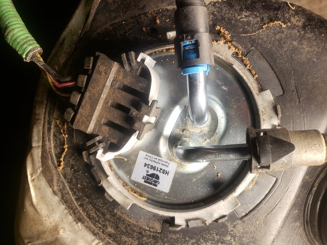

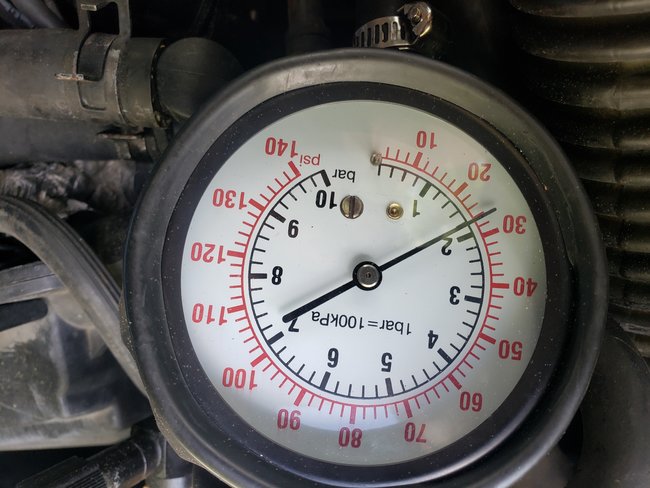

Vehicle will start up and run fine for anywhere up to 20 minutes. Replaced fuel pump and filter. fuel relay and pressure sensor. i'm only getting 28 psi at the fuel rail test port. i have also replaced lots of other parts and tested the inertia switch and run wires straight to the fuel pump, but still having problems. please make suggestions of what i need to do.

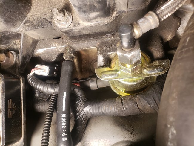

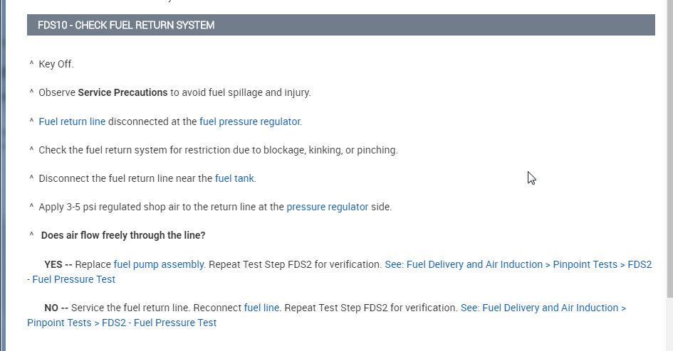

I see you replaced the pump but you have a return fuel system which means the regulator will route "excess" pressure or fuel back to the tank. We need to check the return system for issues including restrictions. However, I suspect the regulator may be allowing too much fuel or pressure back to the tank which causes your low pressure. The reason is, your running pressure should be a minimum of 30 PSI so it is not that far out but with a new pump you would expect it to be higher so that means one of three things. First it is a weak pump. Second, you have a restriction in the supply line, or there is a "leak" in the system allowing pressure to bleed off to the tank.
Let me know if you have questions and we can go from there. Thanks

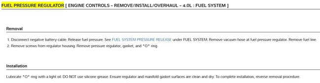

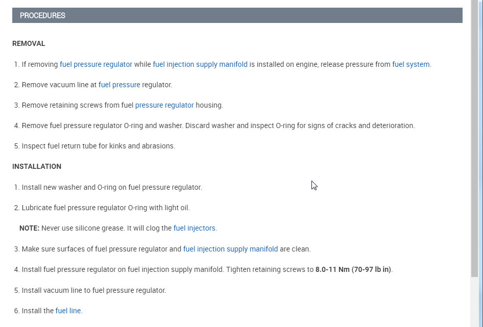

Fuel pressure should be 35-45 psi. I would suggest replacing the regulator.
OE instructions below.
Let me know if this helps.
Rich

If you only have 28 pounds, it is a fuel pump issue.

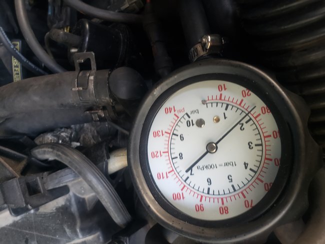

the new fuel pump was made by car quest. don't know what brand the new pressure regulator is and the running pressure is 28 psi, no higher.. it wont keep a constant idle. i have to check the rpm with the obd 2 that i bought because truck wasn't made with a rpm meter and which lines on the fuel pump is the return line? thanks in advance..

The large line goes to the fuel rail and the smaller line is the return line form the rail.

Took it back for another pump and now pressure is lower.
Apr 26, 2020 at 12:57 PM
EWC177
  • 144 POSTS
That's idling pressure.
Apr 26, 2020 at 12:58 PM
Yep, you need a pump.
Replace it and ask either for an AC delco or delphi pump.

This is the second new one I put on..first was a Carquest. this one is a Airtex. how long should line hold pressure? Mine loses pressure within seconds of it shutting off.

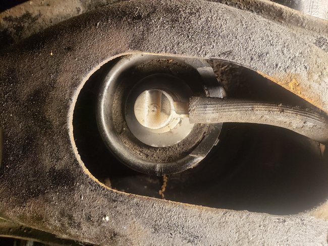

i have the bed off of my truck and the inside of the tank is clean.

Old wasn't working. second one ran at 28. third one runs at about 27.

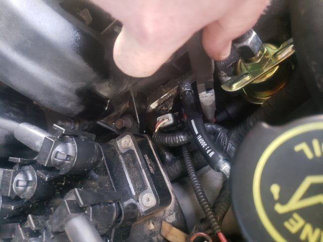

Okay, get a pair of vice grips and clamp off the line at the fuel rail and see what the pressure reads. The return line.
Apr 26, 2020 at 3:36 PM
EWC177
  • 144 POSTS
Since I changed the fuel pump this second time, it's shutting off faster.
Apr 26, 2020 at 5:19 PM
Okay, did you clamp off the line as I suggested?
Apr 27, 2020 at 3:14 AM
EWC177
  • 144 POSTS
Yes, the pressure didn't go up.
Apr 27, 2020 at 3:20 AM
EWC177
  • 144 POSTS
The one coming out of the pressure regulator.
Apr 27, 2020 at 3:22 AM
Okay, so it is not the regulator but by doing that, it should have dead headed the pressure which means the pressure should have gone way up.

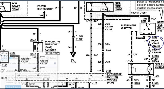

Just out of curiosity, check the voltage to the pump when it is running.

Set the meter to DC volts. You should see battery voltage for 2 seconds with the key on.
The pink/black wire is what you test.
Apr 27, 2020 at 6:31 AM
EWC177
  • 144 POSTS
Okay Roy, goes up to a little over 12 then drops to a little over 6.
Apr 27, 2020 at 4:16 PM
EWC177
  • 144 POSTS
12.05 down to 6.71.
Apr 27, 2020 at 4:28 PM
Is that cranking or with the key on? Remember what I told you that the pump will only have power for 2 seconds with the key on.
It will go to full voltage with it cranking
Apr 27, 2020 at 4:39 PM
