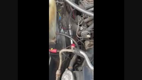

And it's been making this noise.

I did not get the pictures, but the noise sounds like it's coming from the new fuel pump.

Is the new pump a mechanical pump? An electric one wouldn't be under the hood. Can you take a picture of the new pump and upload it for me to see?
Mar 31, 2022 at 7:20 AM
SKOOTER24
  • 275 POSTS

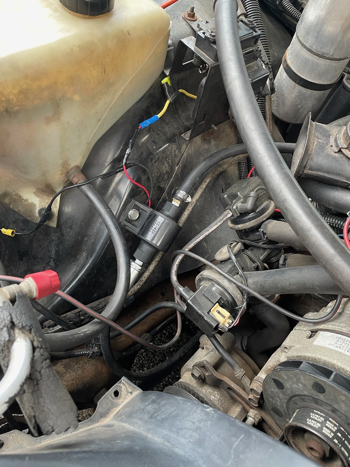

It was installed under the hood next to the firewall.
Mar 31, 2022 at 7:54 AM
SKOOTER24
  • 275 POSTS
It's a Holly universal electric fuel pump.
Mar 31, 2022 at 7:55 AM
SKOOTER24
  • 275 POSTS

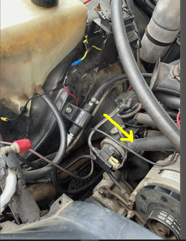

This is where it's installed.
Mar 31, 2022 at 8:04 AM
  • 110,240 POSTS
That is really close to where the original mechanical pump is located.

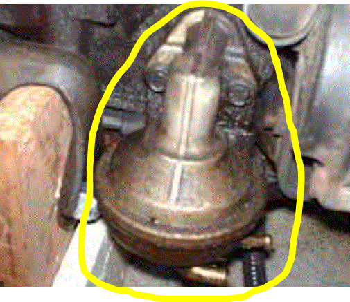

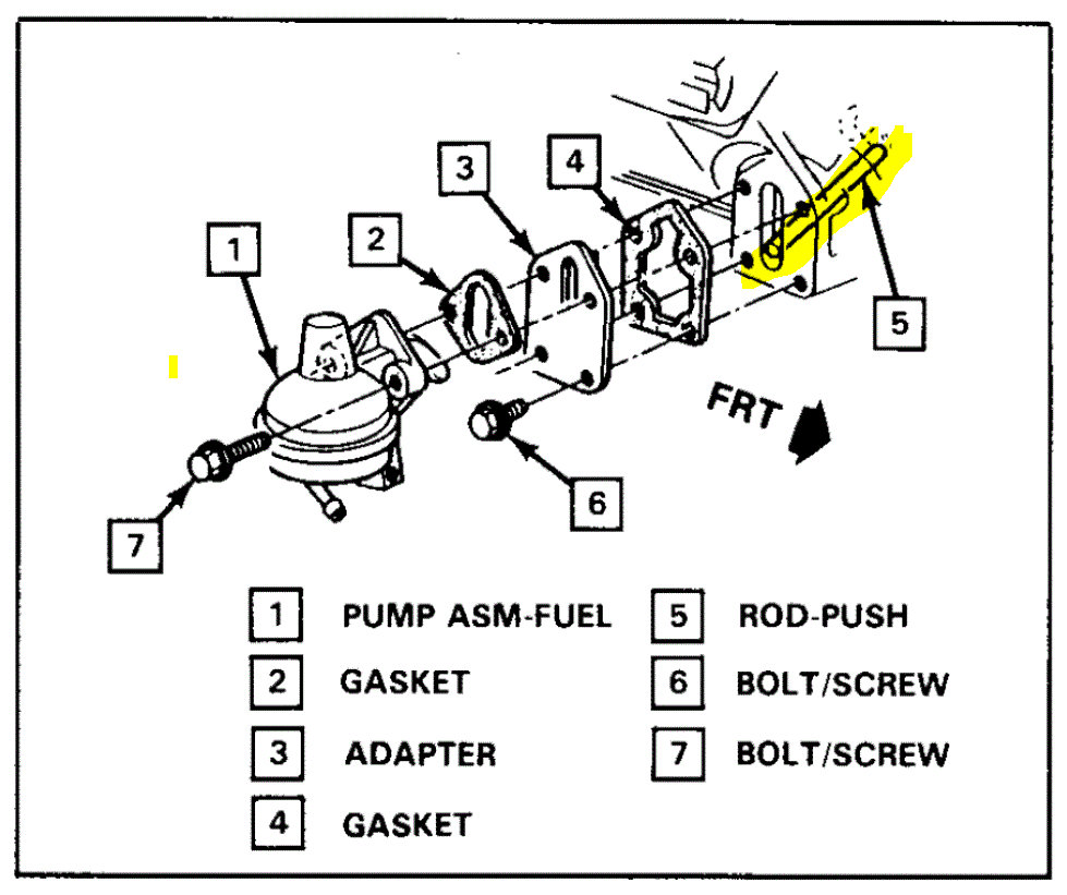

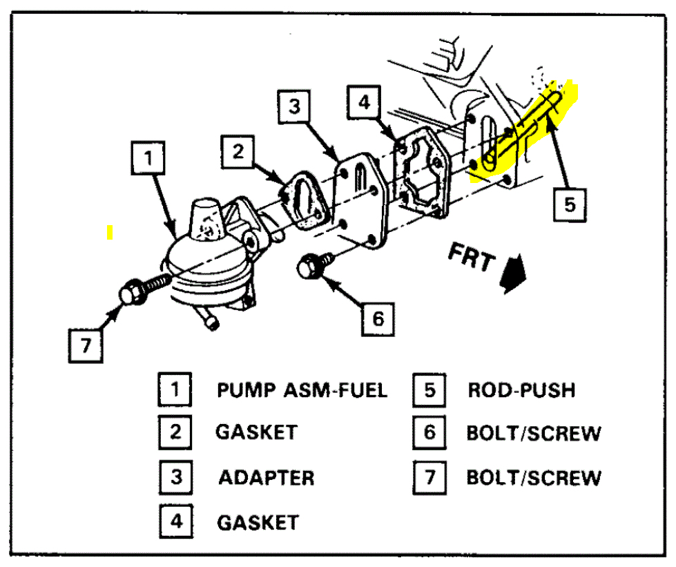

I copied your picture from above. I have an arrow pointing toward the engine. On the side of the engine block is where the OEM pump would have been. See if it is there. Pic 2 shows what you are looking for.
If you look at pic 3, it is an exploded view of the pump. I highlighted the pushrod that goes runs between the pump's plunger and the camshaft. I have a feeling the lobes are worn on the camshaft. As a result, the pushrod is banging on it. This would also explain why an electric fuel pump was used. Otherwise, the camshaft would have needed to be replaced.
If it is there, remove the two bolts and remove the pump. Inside, remove that pushrod. Reinstall the pump and see if the noise is gone. Since the pump is no longer being used, that rod is doing nothing productive.
Let me know what you find.
Mar 31, 2022 at 9:57 AM

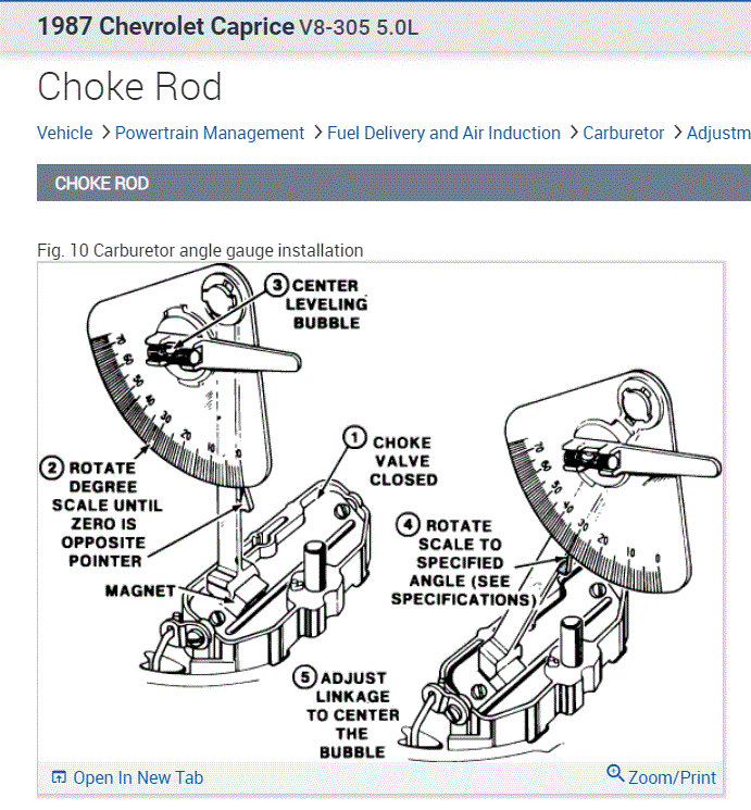

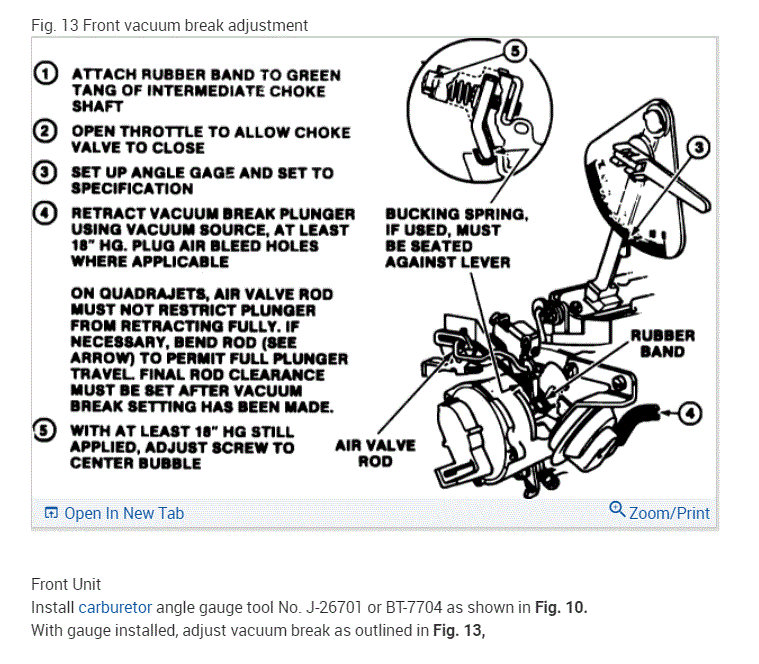

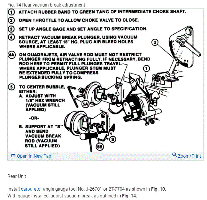

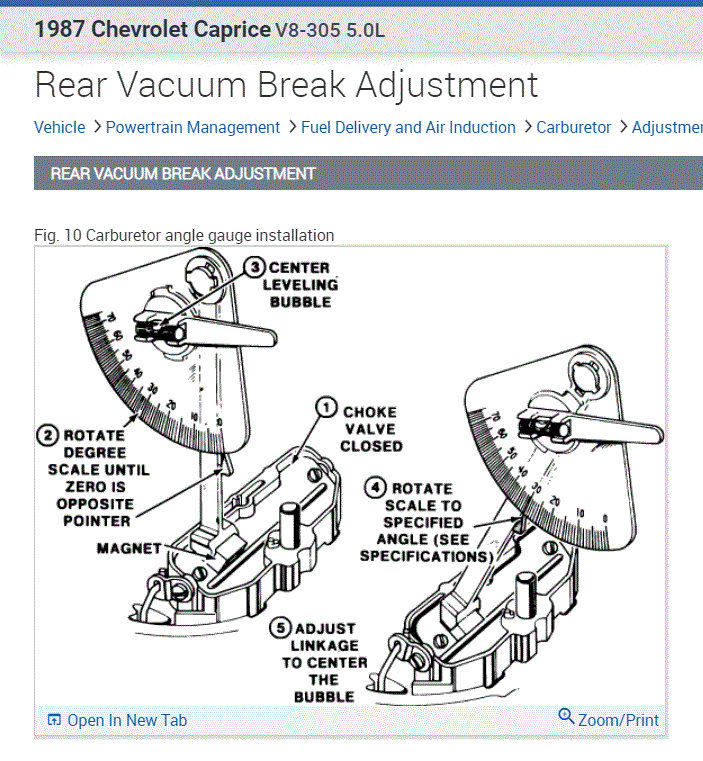

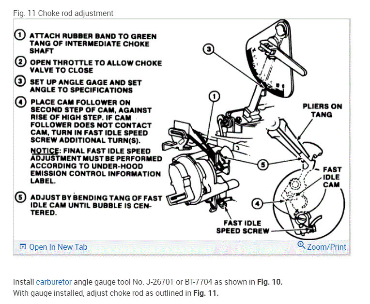

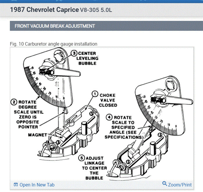

Can you send me the adjustment specs for this carburetor if there are any? I might try to do it myself.
Apr 6, 2022 at 1:00 PM
  • 110,240 POSTS
The only adjustments I have are for the choke and front and rear vacuum break adjustment. I attached them below. If the choke isn't opening, that certainly will cause a rich fuel mixture.

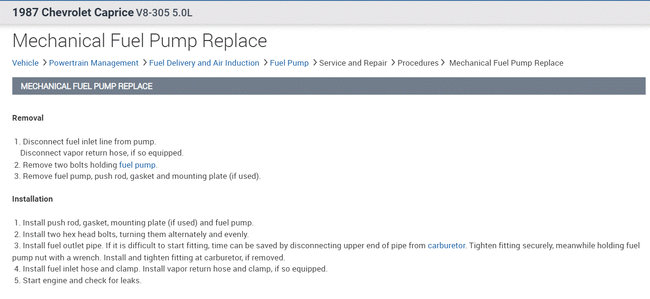

And can I get the torque specs for the fuel pump mechanical? I'm just going to get rid of the electric one and go back to that.
Apr 15, 2022 at 2:34 PM
  • 110,240 POSTS
The bolts are to be tightened to 30 ft/lbs. I attached the directions below. Make sure when you tighten it, do it evenly. The housing is aluminum and it's not hard to break one of the ears off.
