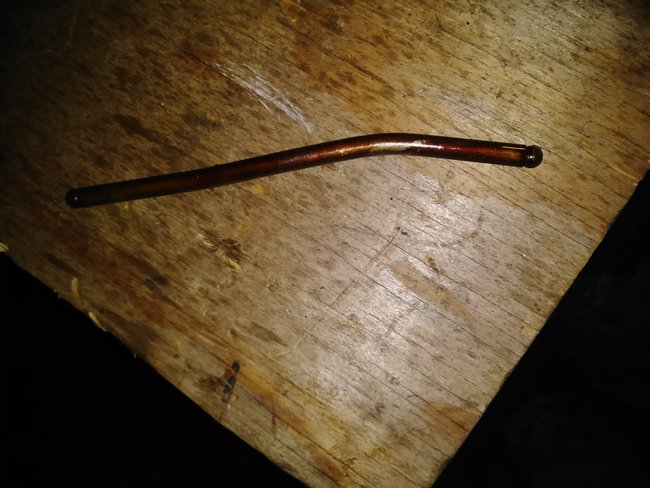

It's a new pump. I did compression test yesterday and the passenger side was between 160 and 175 pounds. Driver side was #1 20. #3 0 #5 160 #7 175. So I loosened the rocker arm nuts on #1 and #3 and redone the compression on the 2 and it read 150 and 165. Would that be a bent or sticky valve?

Only thing I done was loosened the rocker arm nuts. Yesterday I took the intake off and the intake push rod for #7 was bent.

Wow! That is bent! Was there any noise prior to the issue? Any other issues specifically cylinders 1 and 3 considering those two had basically no compression?

No noise. What don't make sense to me is that #7 is where the bent one came from n it had 175 compression. 1 n 3 had compression after I loosened the rocker arm nuts. I took the head completely off today and the 'new' valve seals i just put in was shot on #1 #3 n #7. Got head from junkyard and done the water test it passed. The seals on it are brass and rubber. I'll put picture of them up tomorrow after I get the new ones. I received my injector kit today. Is there a certain way the injectors are supposed to go back in the body?

It doesn't make sense. Somehow the rockers got too tight on one side and most likely too loose on the other causing the bent push rod. When you put everything together on the head, was everything torqued to spec?
