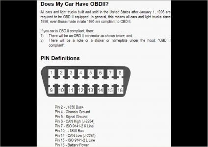

Check for power at pin 16 on the DLC, and pins 4 and 5 for ground.
https://www.2carpros.com/forum/automotive_pictures/62217_OBD_II_Connector_2.jpg

I checked Pin 16 with my volt meter and it shows just over 12Volts using the e-brake as a ground.
Checked Pins 4 and 5 as ground and get 0 volts grounding to e-brake and 12V connected to Pin 16
I have a spare wiring harnes and I traced every connector to be sure everything was connected. There are 3 grounds coming off the Wire harness to the engine compartment. All have been verified to be good grounds.
