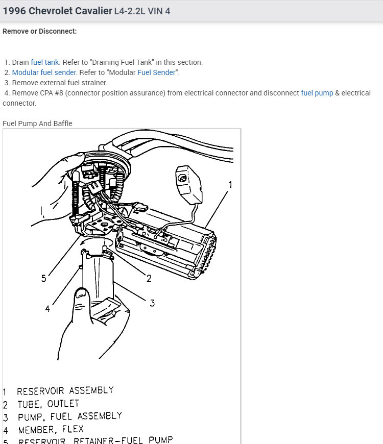

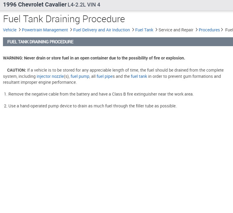

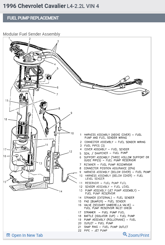

When you turn on the key, can you hear the fuel pump come on?

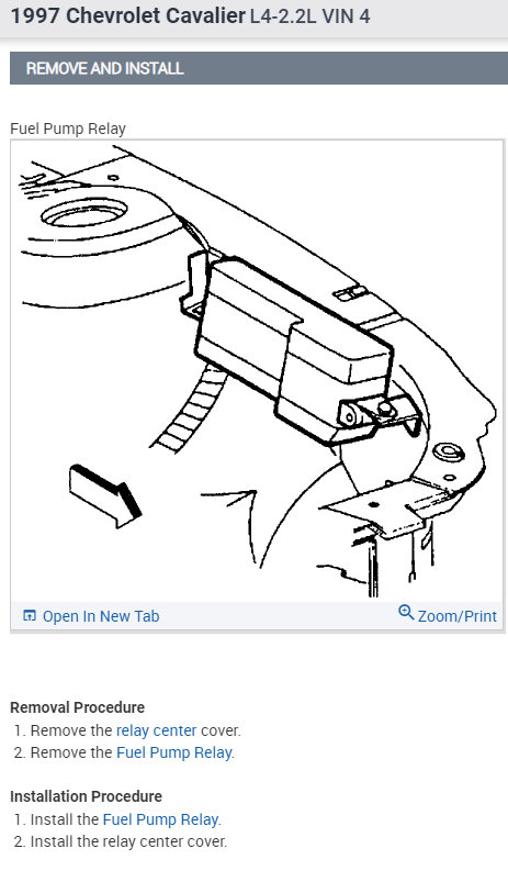

An inoperative fuel pump could be due to a bad relay, wiring issue or a bad pump.

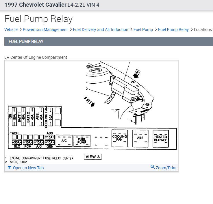

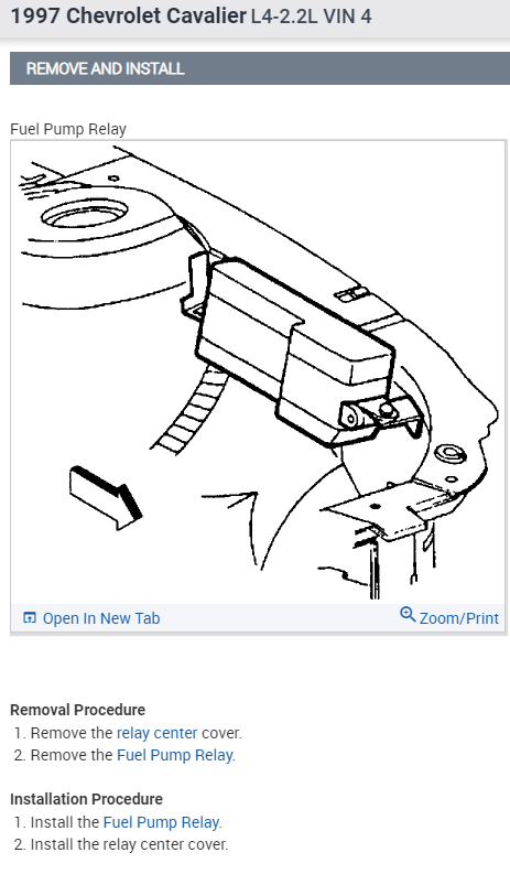

First check the fuel pump relay. It is located in the fuse box under the hood.
Check for any corrosion or burnt pin(s).
This relay can also be tested:

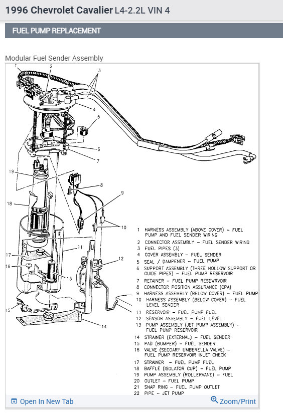

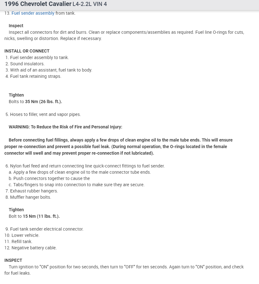

If the relay is functional, then check to see if there is power to the fuel pump harness.
If there is power but the pump is not working, then the issue is likely a bad fuel pump.
